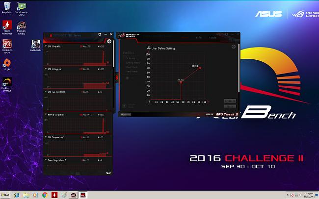

As you can see the GTX 1060 faired very well against the GTX 1080. Mileage may vary depending on system configuration. I am very happy with the performance of the ROG STRIX GTX 1060. The games played smooth and fluid. Graphics were clean and sharp. For a tight-budgeted build I would recommend the ROG STRIX GTX 1060. Although priced a bit higher than the competition. TheROG STRIX cards makes up for the cost with its quality and built-in features. If you plan to run SLI at some point you may want to consider the ROG STRIX GTX 1070 or 1080 as the 1060 does not offer SLI. This card ran very cool and silent. I contribute this to the user defined fan control built in to GPU Tweak II
It is very easy to use. Let’s take a look. Open GPU Tweak II. Go to Professional Mode then Fan Speed. Left Click the little cog to the right of (user define) this will open the User Define Settings.
You can left click any were on the red line and will create a red box marker. If you left click and drag the red box to whatever temp or fan speed you like.
You may select multiple fan speed points to totally customize you gaming performance needs to keep your graphics card cool and quiet.
