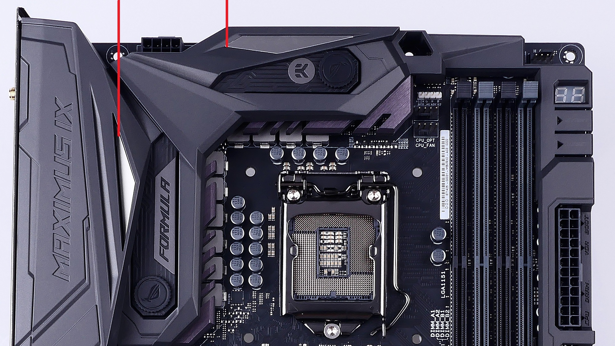

1. The Formula supports custom liquid loops with a new CrossChill EK II cooler that incorporates thinner fins which reduce temperatures by 4˚C compared to the previous generation. The holes for standard G1/4" fittings are covered by plugs adorned with ROG logos. The design also works with air cooling, but circulating liquid through the block reduces temperatures by up to 23˚C. On the Code, you still get a new heatsink design with a phosphate conversion coating and premium, brushed-metal finish.

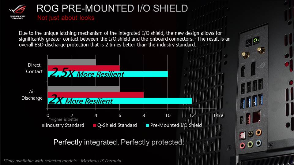

2. The Rampage V Edition 10 first introduced the pre-mounted I/O shield. This integrated piece makes PC building easier, since you no longer need to be concerned about the clearance for plugs or remembering to install the shield before the motherboard. The gap between the I/O plate and the motherboard is also greatly reduced, and it's always perfectly aligned, which simply looks great. The Formula takes this concept one step further by eliminating the I/O frame for an almost seamless surface.
The Code (right) still offers a fantastic-looking nickel-coated Q-Shield.

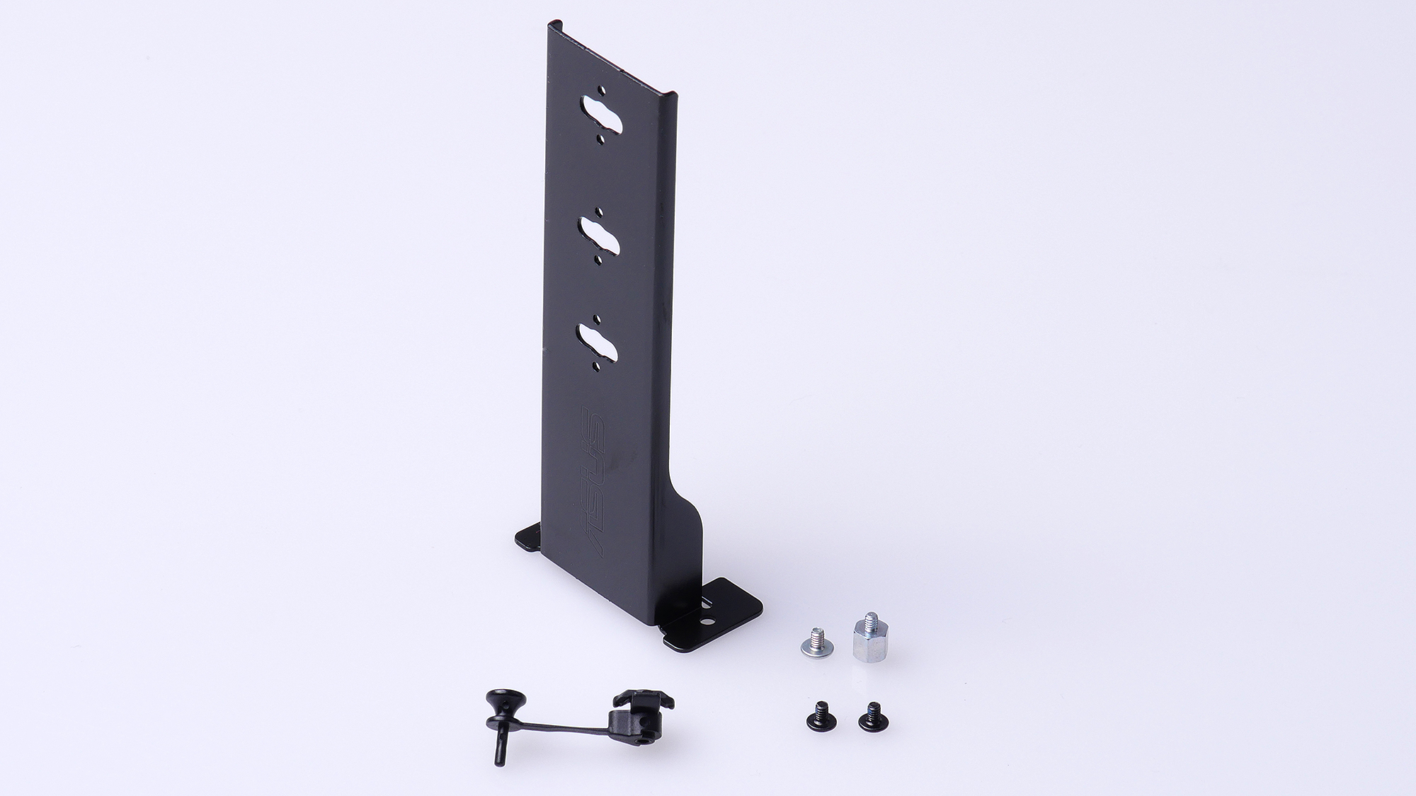

An M.2 bracket is supplied for your second M.2 SSD. Here's a guide to setting up two of them in a RAID 0 configuration for extreme speed.

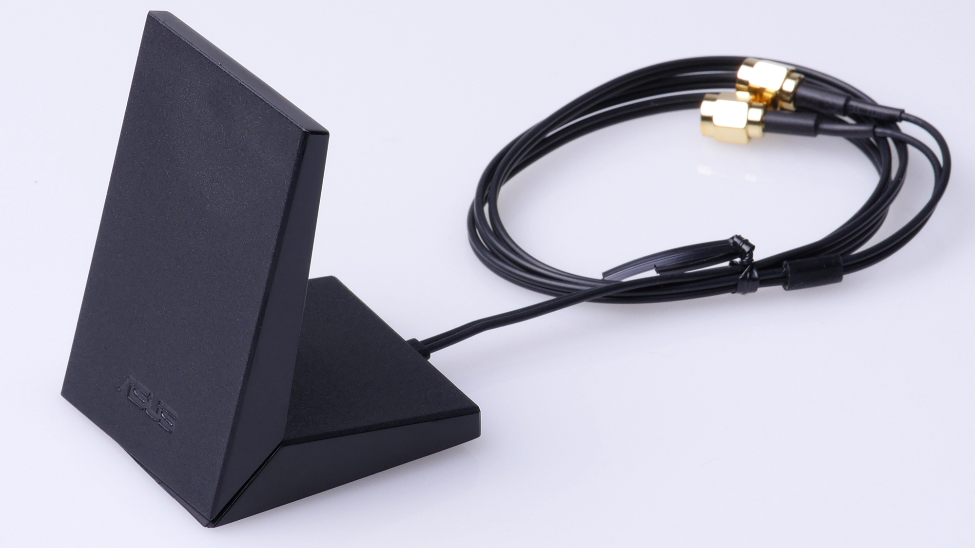

An external magnetic antenna for the 2T2R Wi-Fi with MU-MIMO is supplied for better reception. A high-bandwidth SLI bridge is bundled - and ripe for a 3D-printed cover - but if you're interested in added RGB lighting with a touch panel, check out our premium SLI bridge. Finally, there's the small-but-convenient Q-connector that helps you connect the chassis buttons and lights easily.
