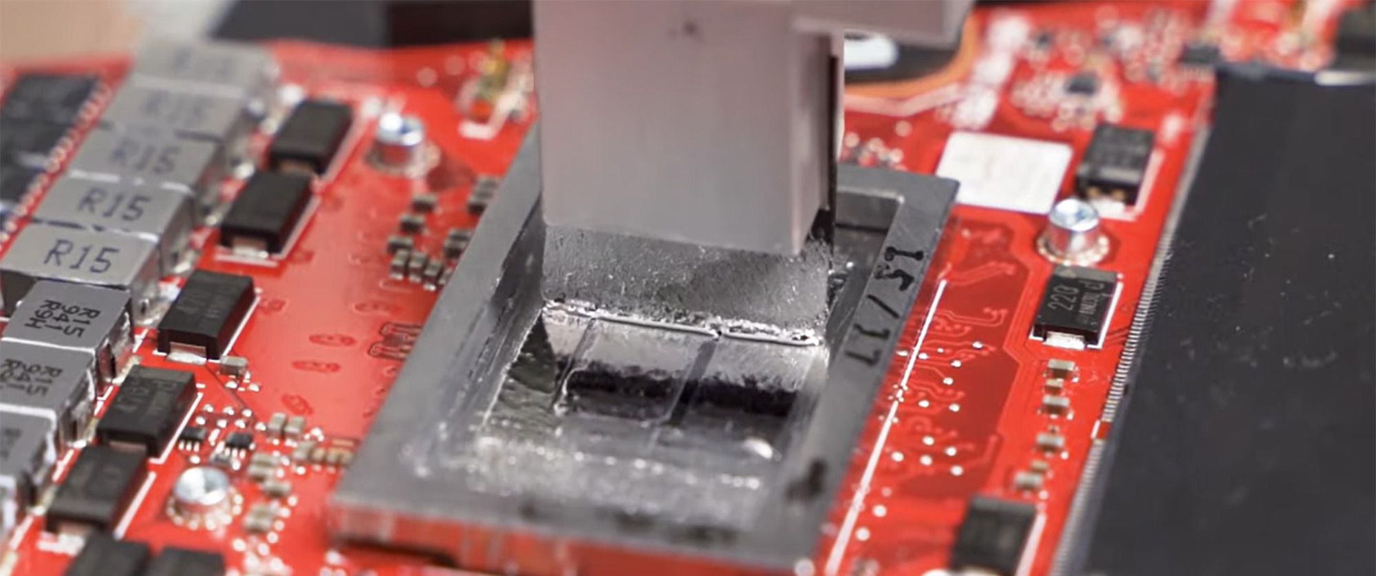

We developed a two-stage method that ensures the complete coverage required for optimal performance. The process begins by brushing the compound onto the die and concludes with additional injections to get the amount just right. Custom machinery performs both steps with mechanical precision.
Step one is essentially painting; a mechanized arm wets its brush in a container of liquid metal and then glides back and forth across the CPU. It performs exactly 17 passes, which our extensive testing determined is the ideal number for complete coverage. Rather than simply sliding back and forth, the machine mimics human motion by also moving vertically to add a subtle arc.
Cotton swabs are normally used to spread liquid metal by hand, but they absorb some of the compound and change shape as a result. We experimented with multiple vendors and more than 30 different brush designs to determine the best shape and material for long-term use. The final version is made of silicon, which doesn’t deform or degrade with prolonged exposure.
To minimize accumulation on the edges of the processor, the initial brushing pass makes contact at a different point on the surface than subsequent strokes. The die also is set inside a stainless steel shim that prevents excess compound from spreading to the surrounding area. An earlier version of this shim fit onto the motherboard, but the latest iteration is small enough to sit directly on the CPU package, so it can be used for different laptops from the same generation.

We did a lot of internal testing to determine how much liquid metal is best. Too little reduces the efficiency of thermal transfer, but too much increases the likelihood of leakage and needlessly wastes an expensive material. The first stage doesn’t apply enough, so a second machine injects more compound at two points on the die. The surface tension created by the initial coat helps spread the additional material without subsequent brushing.
Finding the right components for the second stage was one of the most challenging aspects of the project. Although we were able to use off-the-shelf parts, it was extremely difficult to source ones capable of not only housing liquid metal, but also reliably dispensing a precise dose. The syringe and pump are made of stainless steel to avoid reacting with the compound.
Low viscosity makes liquid metal much more mobile than thicker thermal paste. To keep it from seeping out and shorting adjacent circuitry, we created a special sponge that surrounds the die. This bespoke barrier fits into an incredibly slim space between the heatsink and CPU package that’s only 0.1mm tall—essentially the height of the die itself. We spent a lot of time balancing the thickness and density of the sponge to ensure containment without compromising contact between the heatsink and processor.
