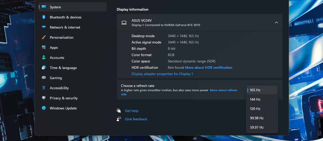

Next, right-click on the desktop and open Windows' Display Settings. Scroll down to Advanced Display Settings and select your monitor from the dropdown at the top (if it isn't selected already). Further down this page, you should see a dropdown marked Refresh Rate–click that, and make sure it's set as high as it will go. The higher your refresh rate, the smoother motion will appear in-game, and the quicker you'll see enemies emerge from cover.
