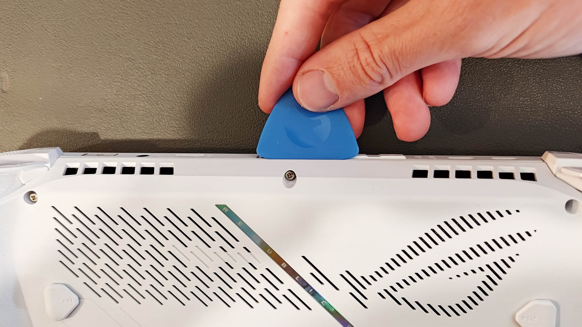

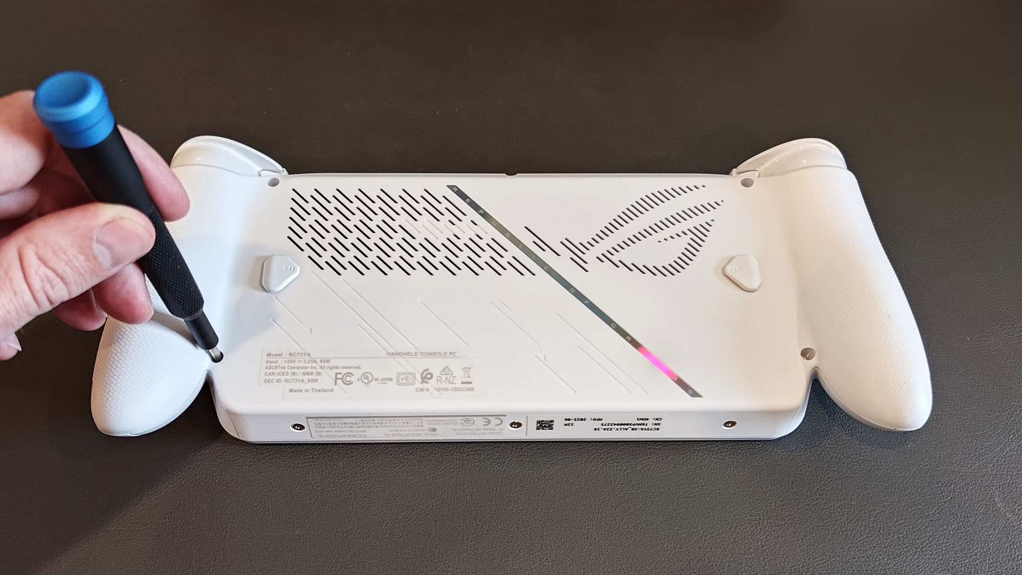

Place your Ally face down on a soft surface and grab your small screwdriver. Undo all six screws along the back side — three along the top, three along the bottom. Place them in a small bowl or tray so you don’t lose them. The bottom middle screw won’t come out all the way — this captive Pop-open screw helps lift the bottom cover off the case. Once it’s loose, you should be able to remove the bottom panel and the screw will stay attached to it.
If the bottom panel doesn’t pop open all the way with that last screw, you can use your guitar pick to undo the clips holding the case together. Insert your guitar pick in between the two panels and slide it along the length of the case to undo the clips.

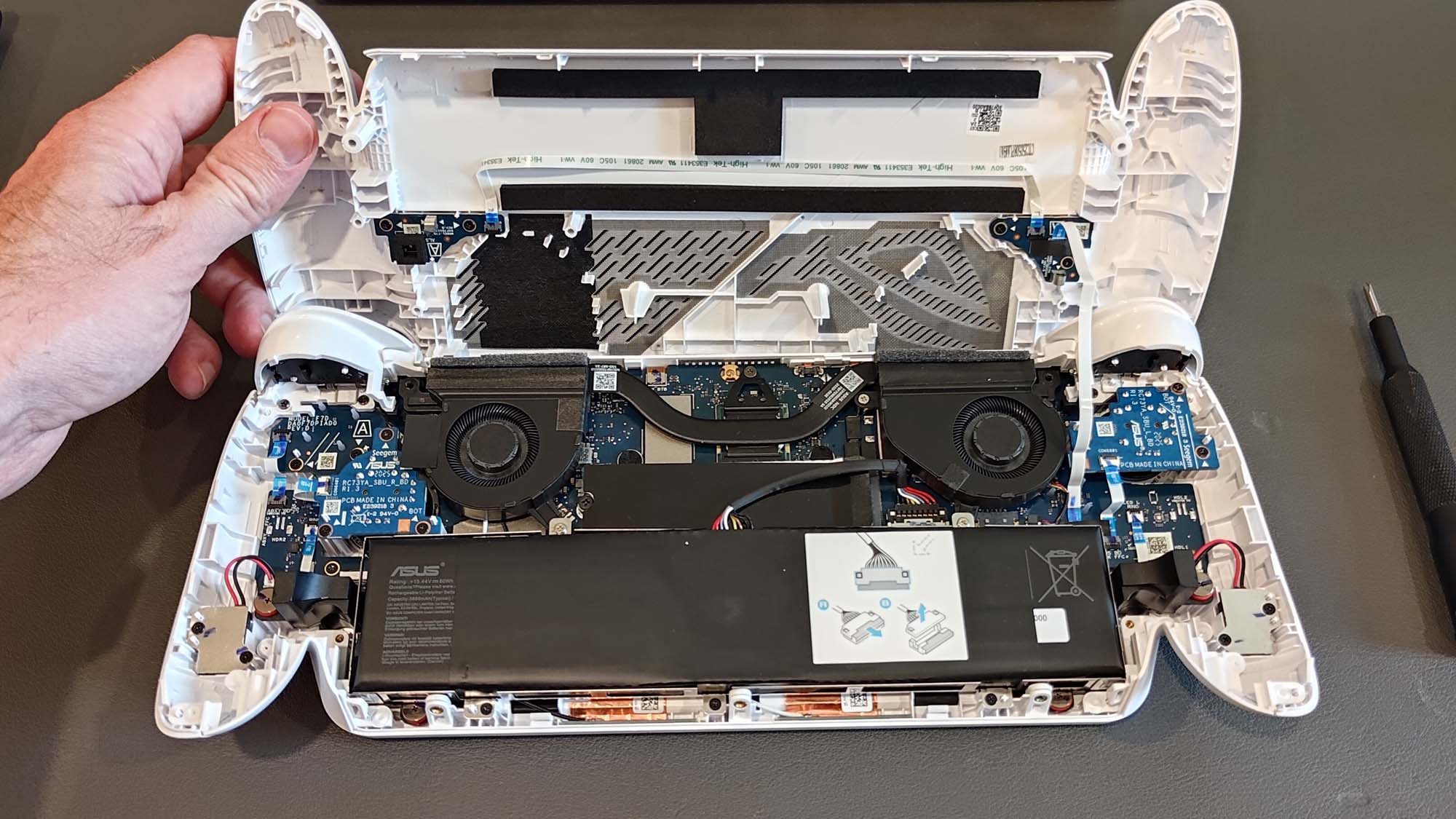

If you're opening an Ally X, be careful not to tear the ribbon cable that connects the motherboard to the back panel. Set the back panel aside.

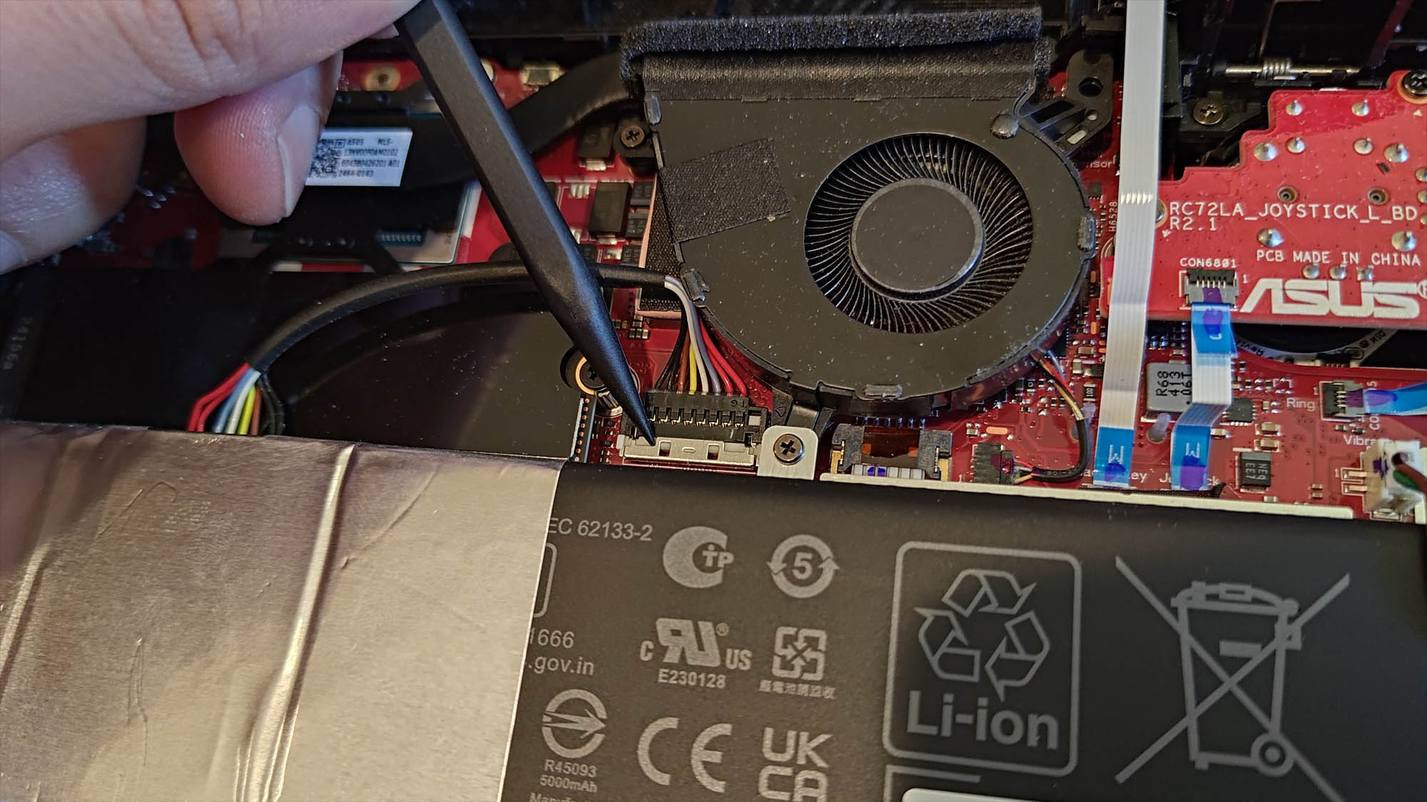

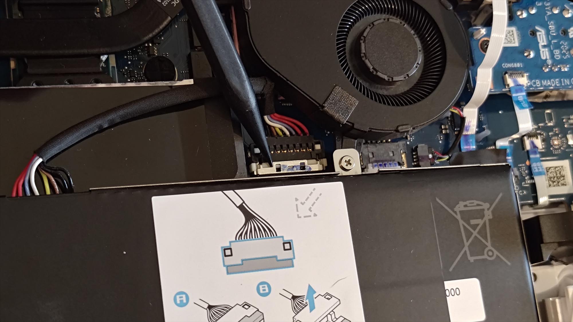

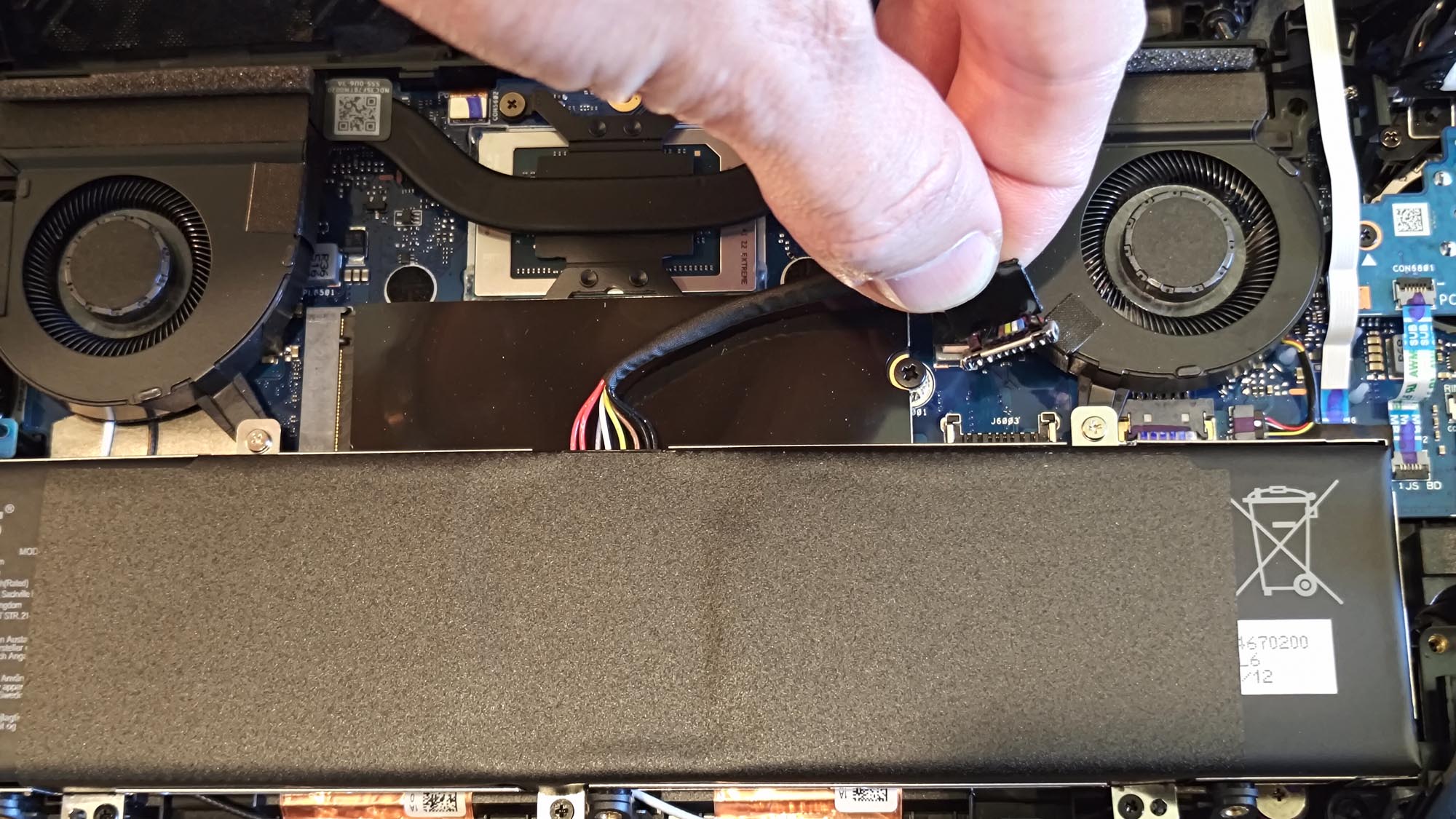

Next, you’ll want to disconnect the battery for safety. Lift up the black flap between the fans and, using a spudger, pry tool, or even your guitar pick, slide the metal retaining clip back, then pull the battery connector upward and out of its socket.

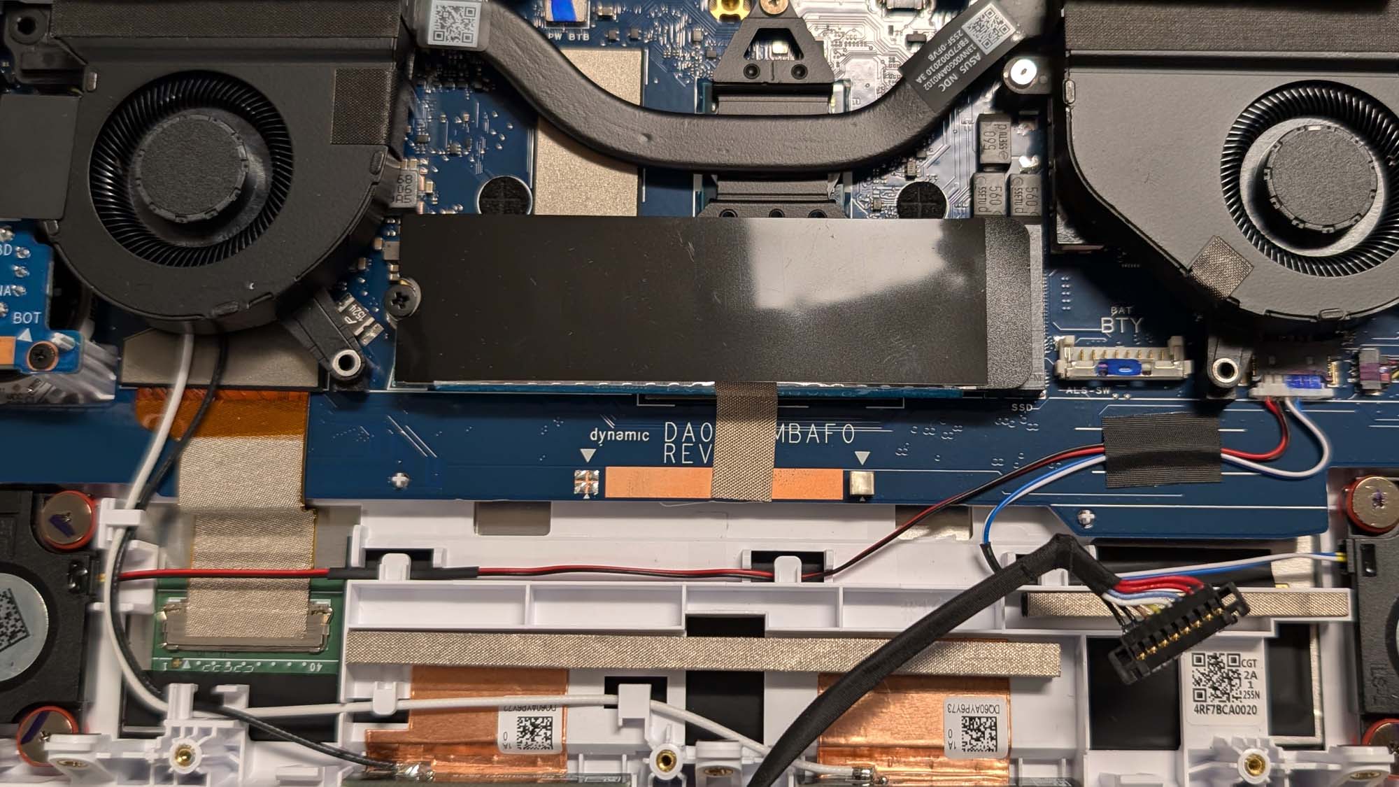

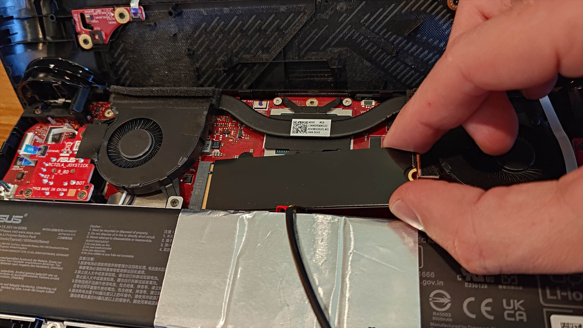

Underneath the black flap between the fans, you’ll find the SSD. Remove the screw holding the drive in place, gently slide the SSD out, and slide your new SSD in. You can then secure it using the same screw.
