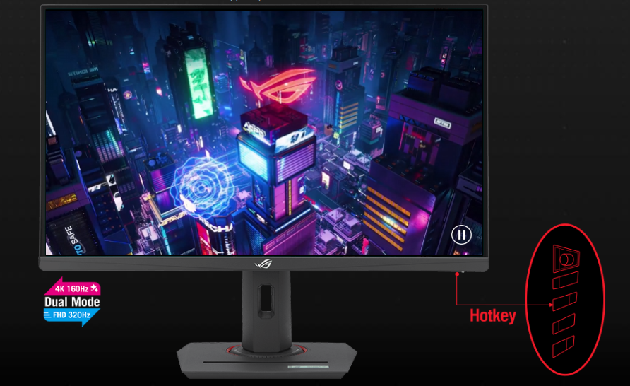

Q3. How to use dual mode? 4K@160hz<->FHD320Hz
A3. For example: XG27UCG model, please use the shortcut keys in Hotkey, or refer to the Hotkey instructions in the manual.
