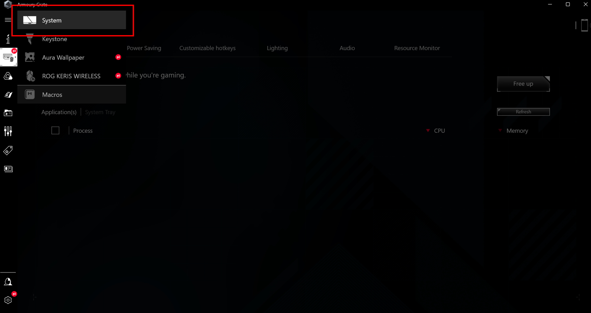

How to enable AI Noise Cancelation on an ROG laptop or motherboard
If you have an ROG laptop or motherboard compatible with AI Noise Cancelation, you can enable the feature for any microphone or set of headphones plugged into the machine–even if it's a pair of generic earbuds. To start, download Armoury Crate and make sure your firmware is up to date. Click the Settings cog in the bottom left, then go to the Update Center tab and click Check for Updates. Update everything available to you before continuing. Once you’re done, click the Device tab on the left, then choose System (if you're on a laptop) or your motherboard (if you're on a custom desktop PC).
Under the Audio tab, you’ll be greeted with the option to customize both input and output, as well as the relative noise cancelation strength of each (again, start on Low–we've found this was enough for even loud construction noise, and you can always ramp up if need be). Perhaps you want to make sure that all incoming audio is filtered, but you work and game in a quiet environment or use push-to-talk when communicating–in which case you could turn AI Noise Cancelation on for one and not the other. Being able to select how you utilize AI Noise Cancelation keeps you in complete control of your audio mix.
