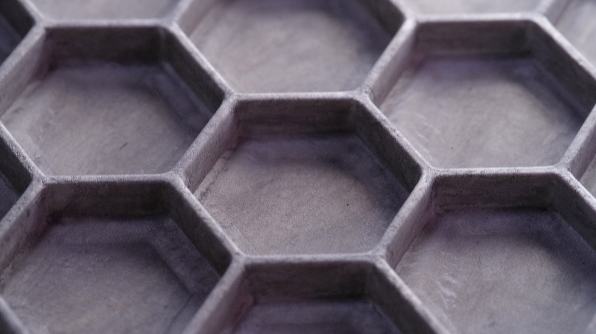

This top deck is made out of a magnesium-aluminum alloy that’s sturdy, and strong, even at this ultrathin size. Honeycomb reinforcements under the palm rest maximize strength with only minimal extra material.

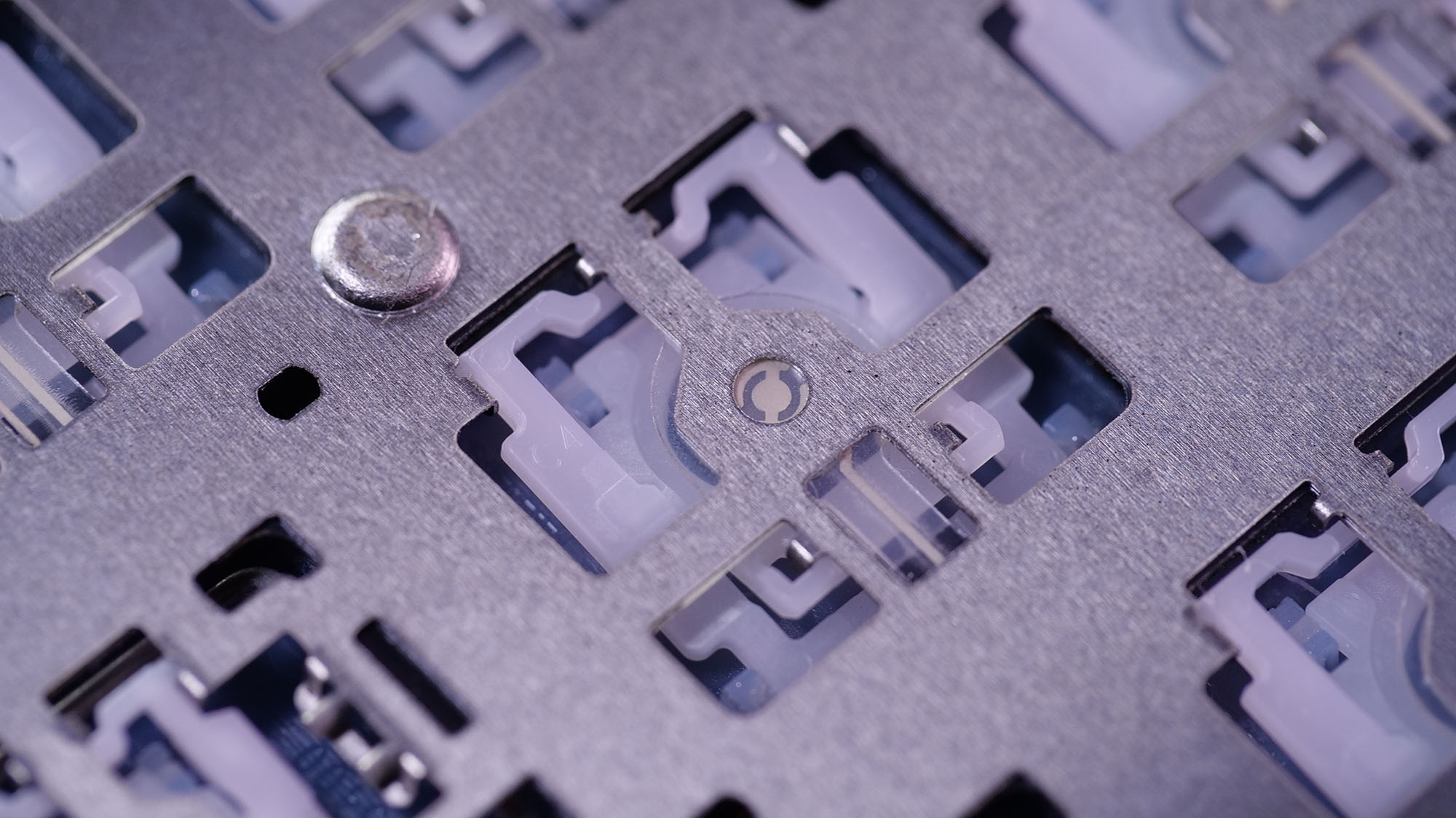

We’ve also cut vents into the keyboard base plate that allow the fans beneath to both pull cooler air from above down into the laptop and reduce the keyboard’s surface temperature. Sustained gameplay consumes a lot of power, which in turn produces heat, so this type of cooling makes using the laptop much more comfortable over long periods.

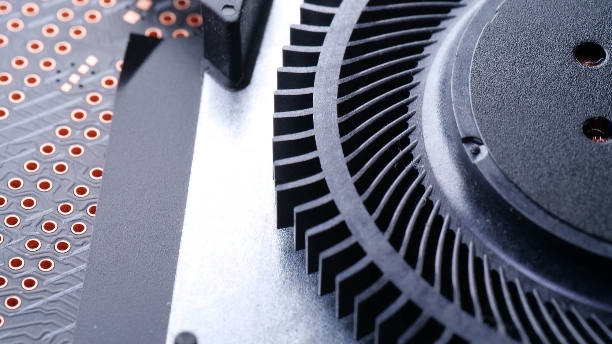

Our n-Blade fans are made to amplify airflow in ultraslim chassis. Each blade is crafted out of a special liquid-crystal-polymer that is strong even when it’s molded thin, letting us make super slender blades that still stand up to high RPMs. The space saved also means we can fit more blades per fan, moving more air with every rotation.
Because the G14’s chassis is so compact, we modified our classic n-Blade design in a couple of ways to maximize performance. While regular n-Blade fans use 83 identical blades, our modified fans use 81 blades with lengths that vary between 50 to 51.2mm, arranged so that their outer edges reduce noise caused by turbulence.
Cooling acoustics can be challenging to hush in super small form factors. With these changes to our n-Blade fans, we were able to maintain maximum airflow through the G14 while keeping noise levels low.
To ensure that we had enough space to fit the same fan diameter as used in our 15” models, we made a slight adjustment to our self-cleaning thermal module, reducing the length of our anti-dust tunnels and eliminating some of the material used compared to typical implementations.

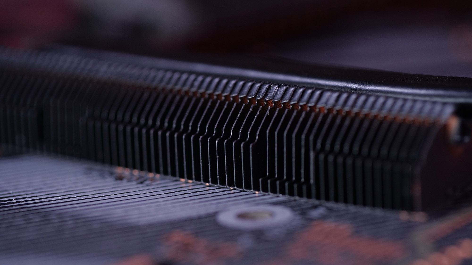

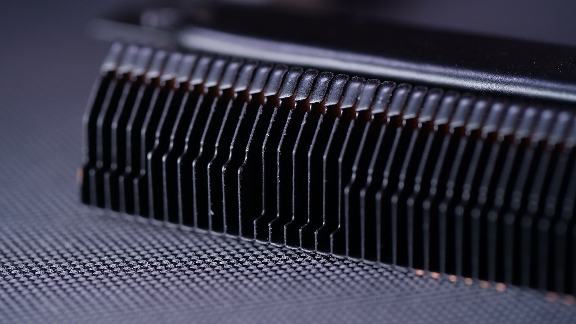

Check out the gallery to see more examples of the specific cooling techniques used in the Zephyrus G14, including the G14’s five heat pipes that snake around the CPU, GPU, and VRM to ensure efficient cooling and 4 heatsinks made up of 209 ultra-thin copper fins. The fins are specially shaped to push air in two directions, both away from and down into vents cut into the G14’s bottom bezel.
