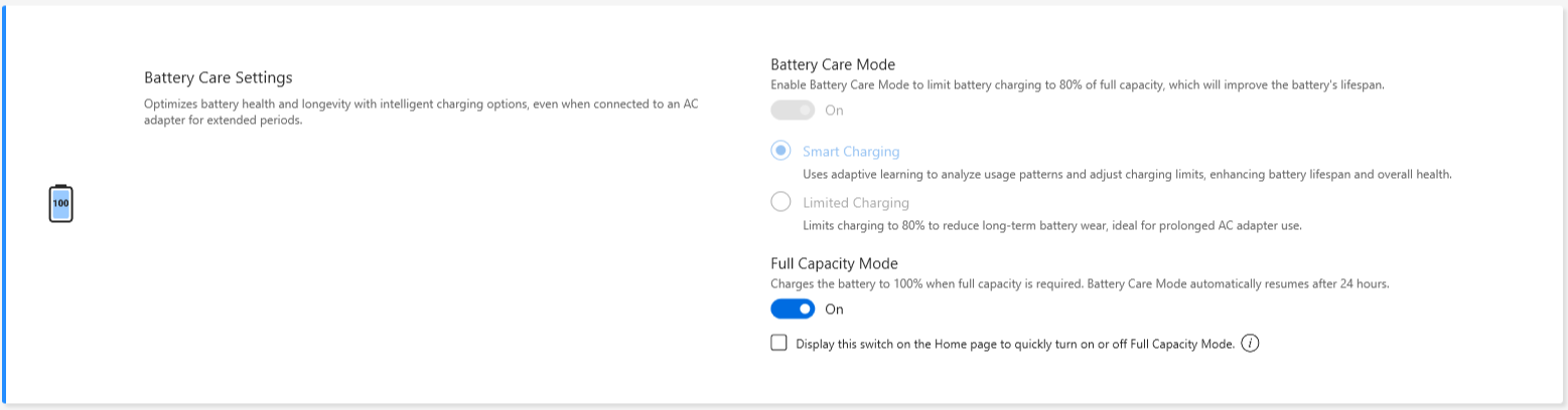

Battery Care Settings/Battery Care Mode (Battery Health Charging)
Models released in 2026 introduce adaptive learning technology, which analyzes usage patterns to help improve battery lifespan.
Overcharging a laptop may degrade the battery, resulting in a shorter lifespan, or even swelling due to oxidation.
You can choose to turn on Battery Care Mode, so that the battery can be charged to 80% to improve its lifespan.
When Battery Care Mode is enabled, this mechanism will smartly adjust the recharge trigger point to protect the battery when AC power is connected all the time.
If you need to recharge to 80% immediately, please unplug and plug AC power to fulfill this demand.
If there is a need for using it on-the-go, you can switch on Instant Full-Charge Mode for a one-time full (100%) charge. The system will turn back to the limit charging state after 24 hours.
With the CPU models before Intel Alderlake or AMD Rembrandt, you could choose to limit the charges to 60%, 80%, or 100% to prolong battery lifespan and reduce the chance of damage from battery swelling.
According to how the notebook is being used, you can choose : Full capacity mode, Balanced mode, and Maximum Lifespan mode
*If you experience the problem which is the battery stop being charged after the battery level is charged to 60% or 80%, please check if you set up charging mode in Battery Health Charging.
(Balance Mode: The battery can be charged up to 80%, Maximum lifespan mode: The battery only allows being charged up to 60%)
Full capacity mode : When you use the laptop regularly, you can set the standard profile to allow for a full 100% charge.
Balanced mode: When using the laptop in meetings, you can use Balanced mode to allow charging up to 80%.
Maximum Lifespan mode: When you always plug-in your charger, you can set the Maximum Lifespan mode to allow charging up to 60% to extend batteries life cycle.
Note:Battery care/battery health charging behavior will maintain charging limit during sleep/shutdown.
When booting, the BIOS will reset the charge limit back to 100%. After entering Windows, the service will determine the charge limit based on the user settings.
Therefore, the period when the upper limit is exceeded and still charging is from turning on the unit to about when you see the Window login screen.
