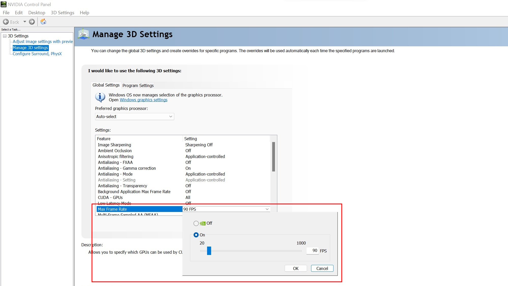

Start by disabling BatteryBoost 2.0 as described above — this will unlock your frame rate and power limits. Then, instead of using BatteryBoost to limit your frame rate, set a custom frame limiter in the NVIDIA Control Panel. This will limit the CPU and GPU usage to match your desired smoothness.
Open the Start menu and search for “NVIDIA Control Panel”. Once open, select Manage 3D settings from the menu on the left, then use the center pane and scroll down until you find the Max Frame Rate option. Turn it on and select your desired frame rate cap — something like 60 FPS or 90 FPS would be a good place to start — then click Apply. Any game you’re playing will need to be restarted for this cap to take effect. Your results will vary depending on the game and the framerate you pick, but in our testing, this provided a great middle ground between BatteryBoost and uncapped framerates, both in terms of smoothness and battery life.
