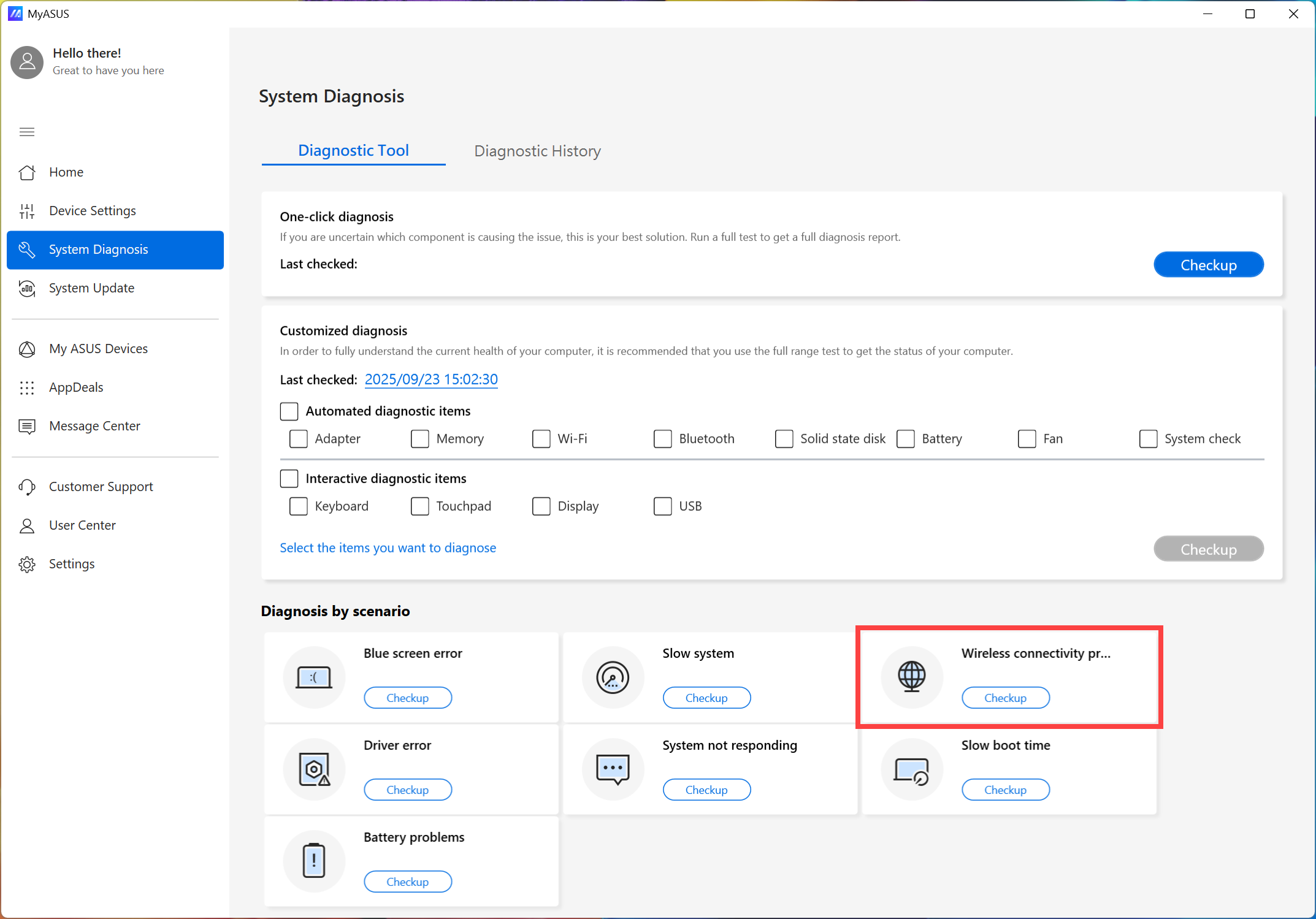

ScenariosDescriptionCheck item
One-Click diagnosisIf you have no idea one which component to be tested, you can choose this option to run a full system test.Adapter, Memory, Wi-Fi, Bluetooth, Hard disk drive, Solid state disk, Battery, Fan, System check
Customized diagnosisTo be fully aware of the hardware health of your PC, it's recommended to run the Hardware Check to verify the hardware status in your PC. Adapter, Memory, Wi-Fi, Bluetooth, Hard disk drive, Solid state disk, Battery, Fan, System check, Keyboard, Touchpad, Display, USB
Blue screen errorA Blue Screen of Death is usually hardware or driver related. Most BSOD's show a STOP code that can be used to help figure out the root cause of the Blue Screen.Memory, Hard disk drive, Sector check, Device driver
Slow systemInsufficient memory and hard disk space are common causes of system slow down. Having multiple applications and windows open at the same time may also be the problem.Memory, Hard disk drive, Hard disk space, Application usage, Fan
Wireless connectivity problemsThe stability of the network carriers and Wi-Fi Internet devices is one of the most common causes of network disruptions.Wireless device and settings, Network connection
Driver errorSetup of a wrong or old driver may cause the system to be unstable and system crash.Device driver
System not respondingRandom crashes usually result from the Windows settings, hardware failures, or malware damage.Hard disk drive, Sector check, File distribution
Slow boot timeA bad hard disk or running too many programs in the background may influence the boot time and make boot time longer.Memory, Hard disk drive, Boot time check, Task scheduler check
Battery problemsMake sure the system power supply is firmly plugged in with AC adapter.  Check the power supply and confirm if all the detachable power cords are fully inserted. Make sure the battery is properly seated in the battery compartment, and the battery or system contacts without any problems.Battery

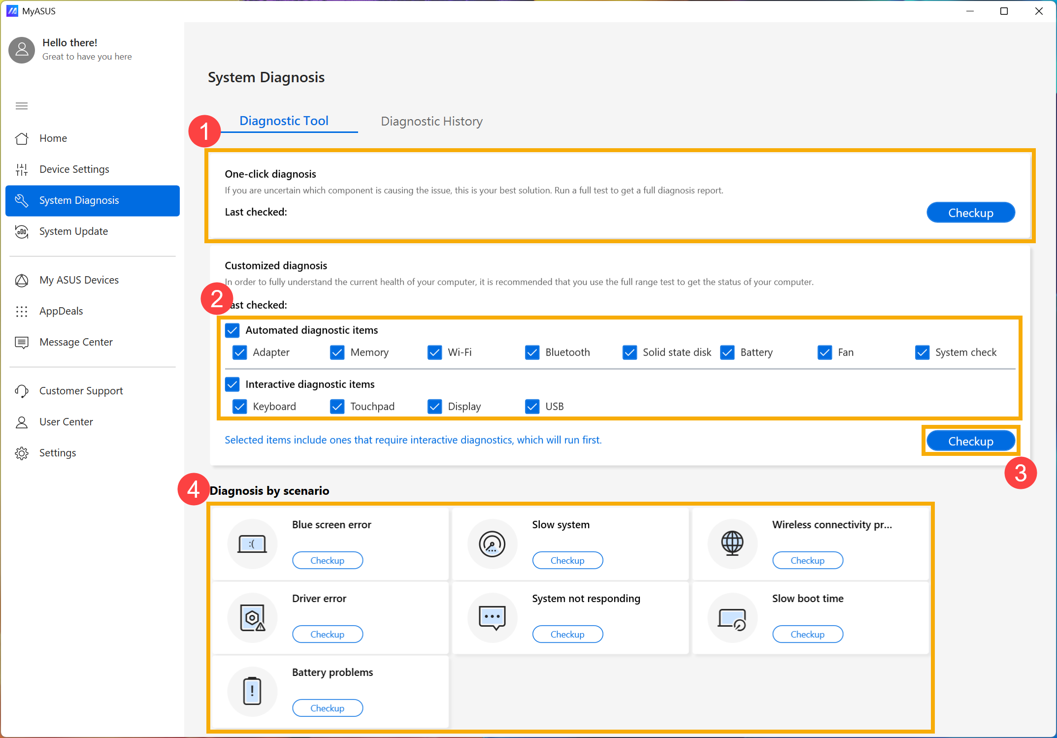

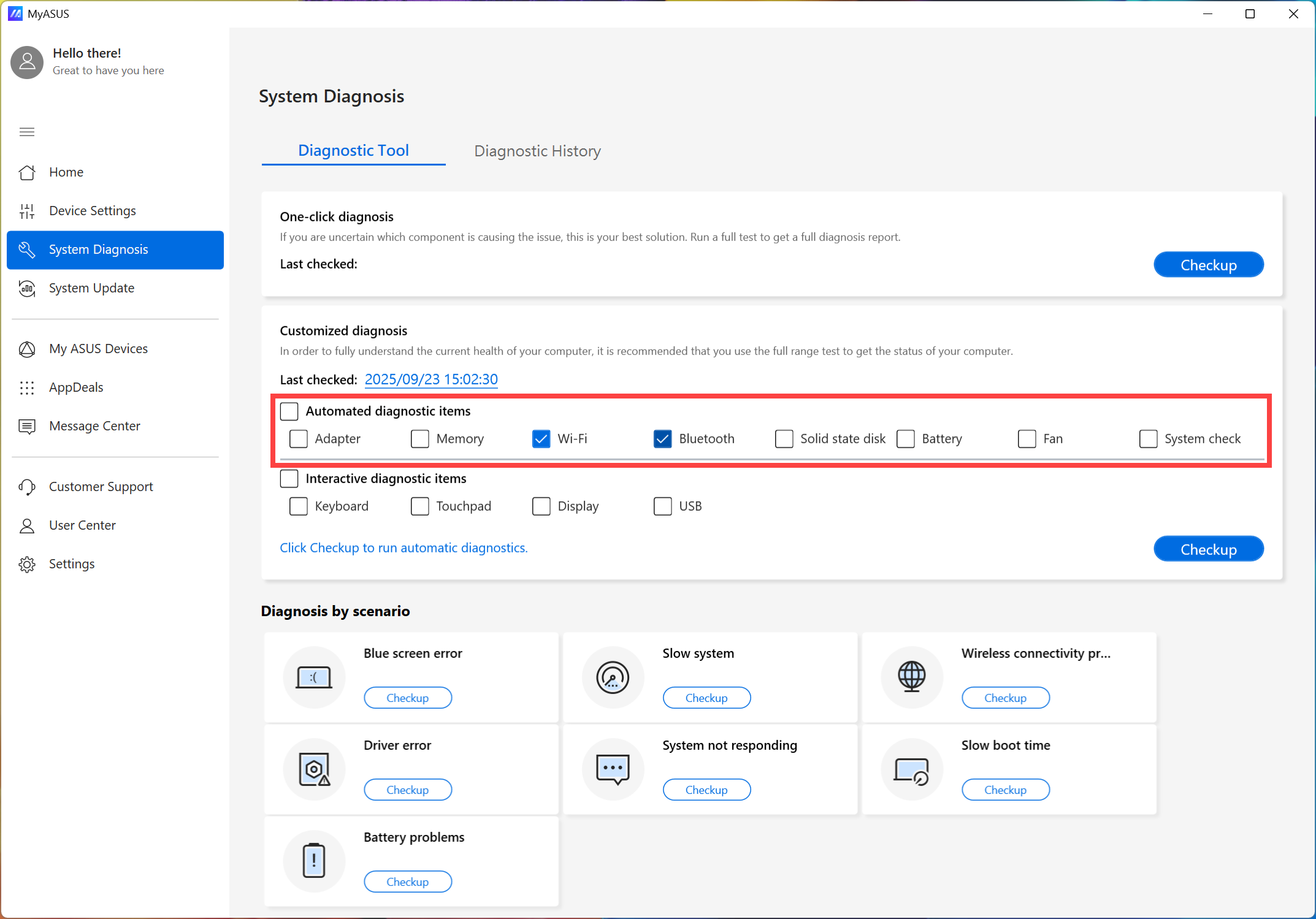

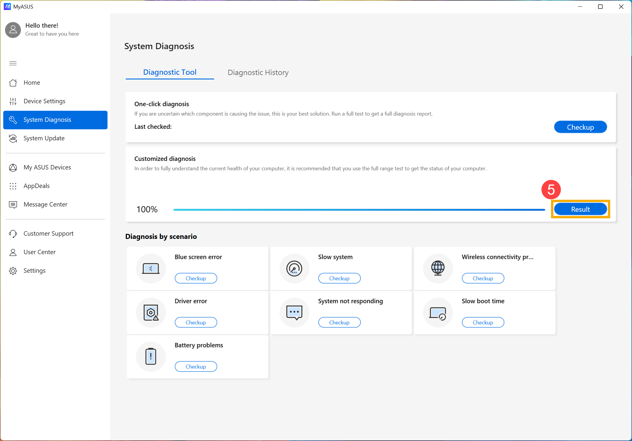

  1. Here are three methods to conduct system diagnostics. You can choose One-click diagnosis, select the items you want to check in Customized diagnosis, and then click [Checkup]to start to check. Or, click any of the scenarios below of Diagnosis by scenarioto get more details of check items. (The following takes Customized diagnosis for example.)
    The time required for the tests to complete will vary, so please be patient as some may take several minutes.
  2. Click [Result] after the test is completed

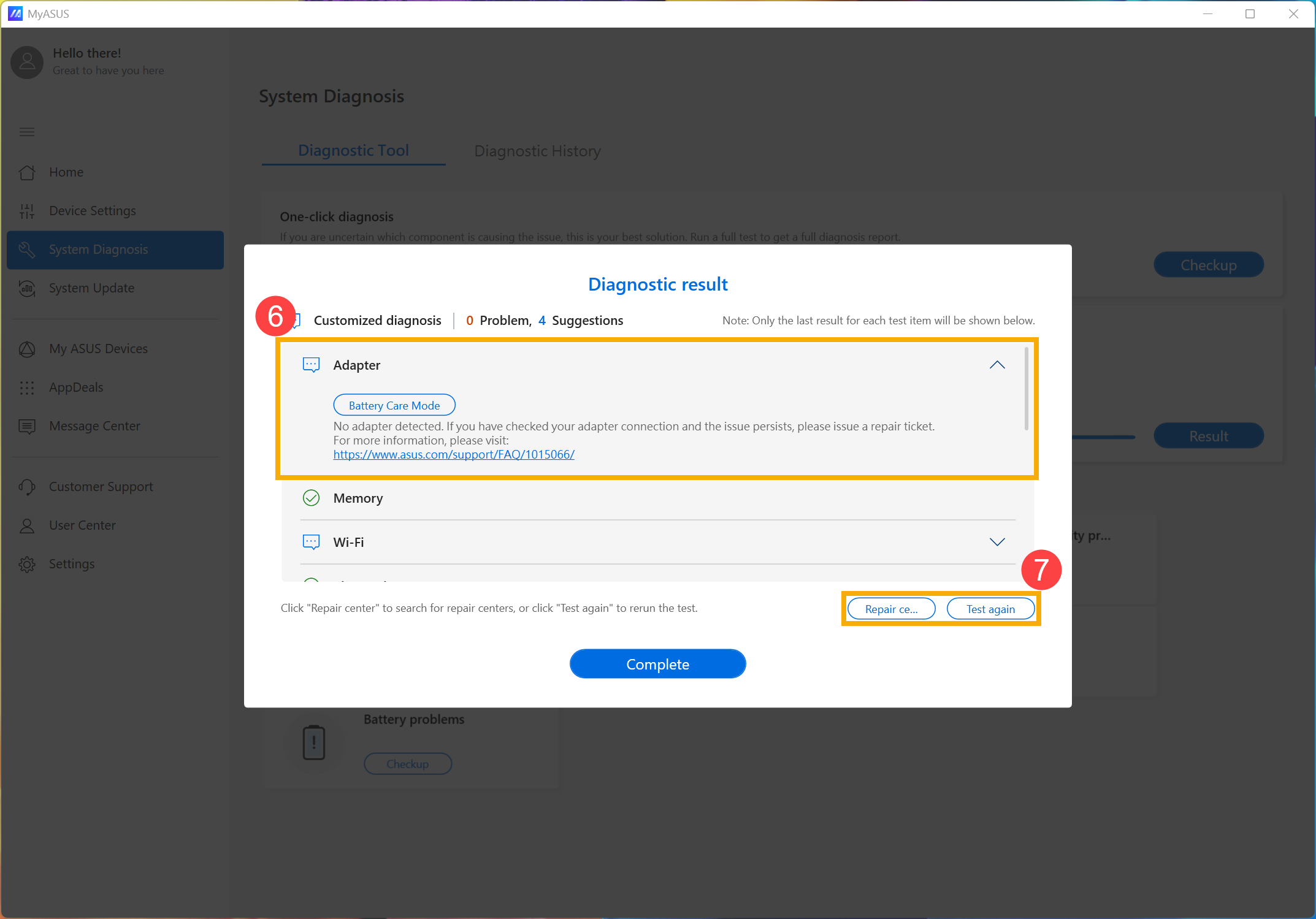

  3. If any error occurs after the test is completed, it will provide the error items, troubleshooting suggestions, and possible approaches to resolve the problem. Besides, if there’s any hardware error, you can also issue a repair ticket in this page or you can test again to double check the error

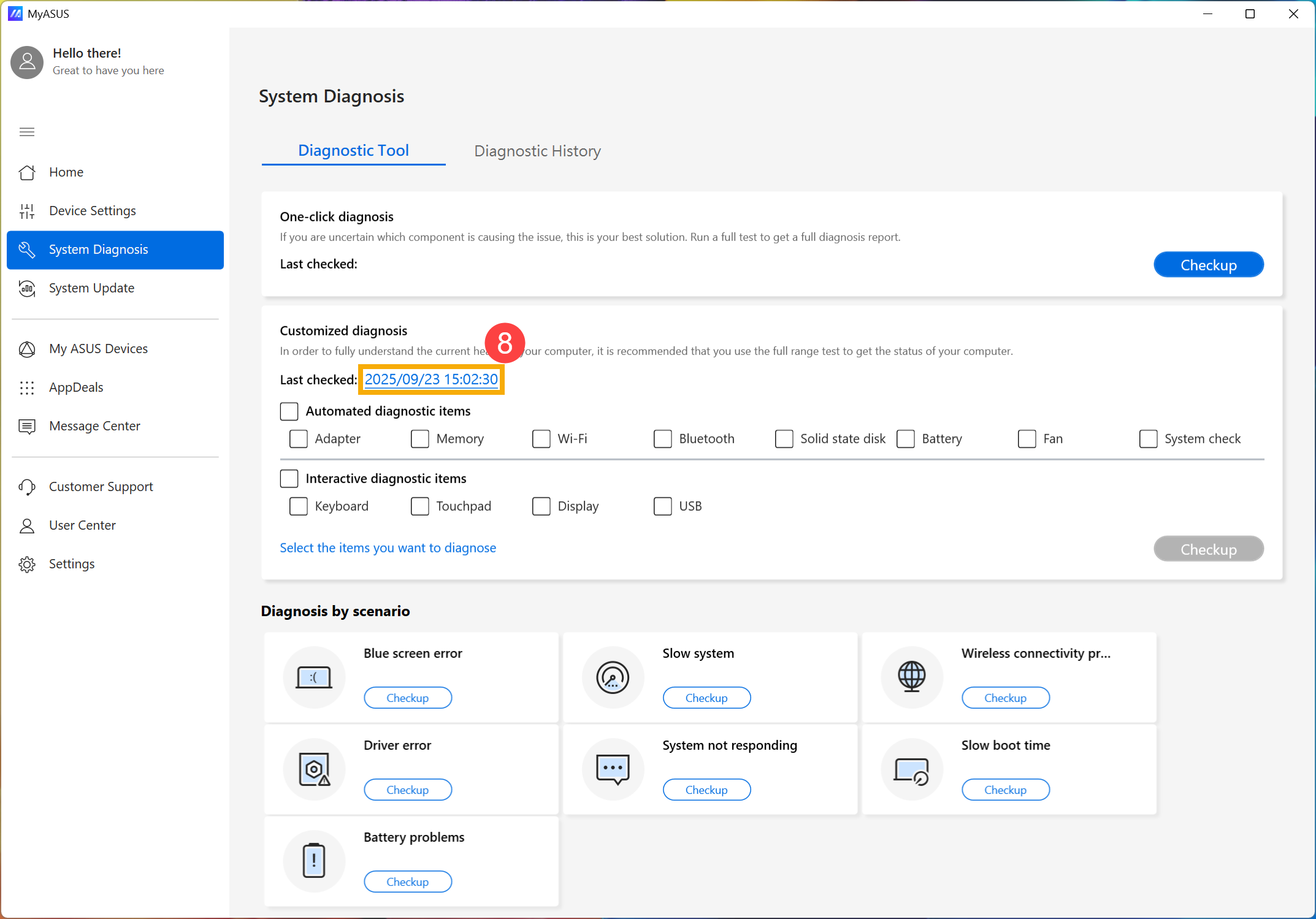

  4. You can also click [the last diagnosis time]to view the last test results.

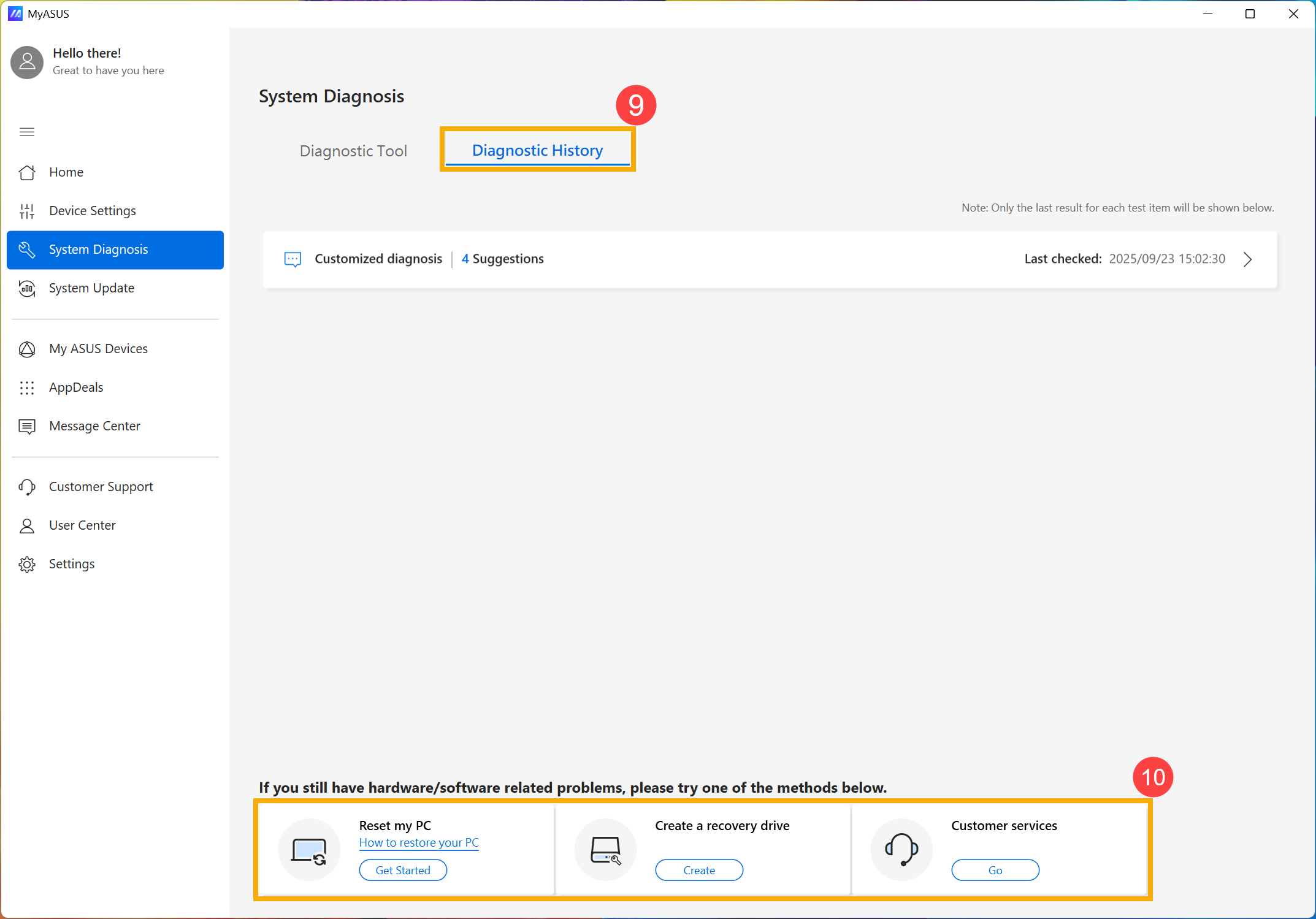

  5. In Diagnostic History, you can see the previous diagnosis history, and in this page, you can have options to Reset my PC, Create a recovery drive or contact ASUS Customer services. Please click [How to restore your PC] to learn more about restore process introduction, or click [Get Started] that will run the restore process directly.

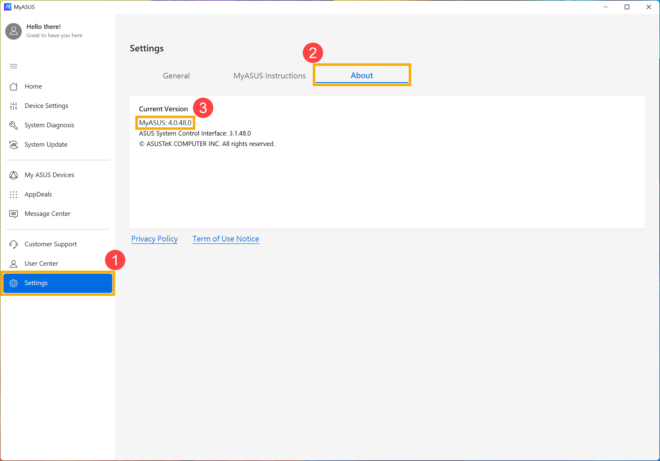

Question 1: How to check the MyASUS version?
Answer 1: Please click the [Settings] from the left menu, and then select [About] from the top, you will find the version number of the MyASUS installed in Current Version.
