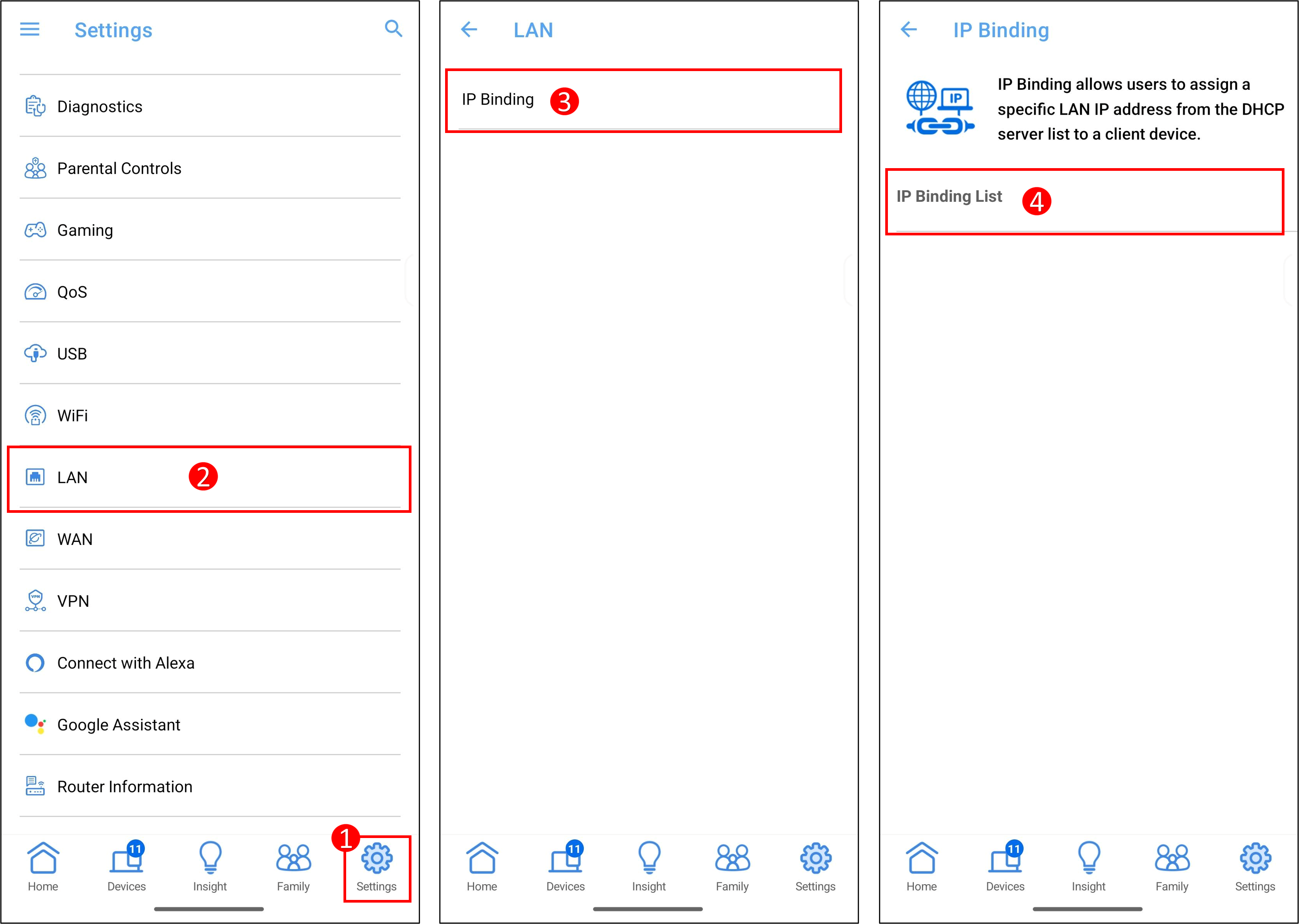

1. Enter the ASUS Router App, tap [ Settings ] > [ LAN ] > [ IP Binding ] > [ IP Binding List ].

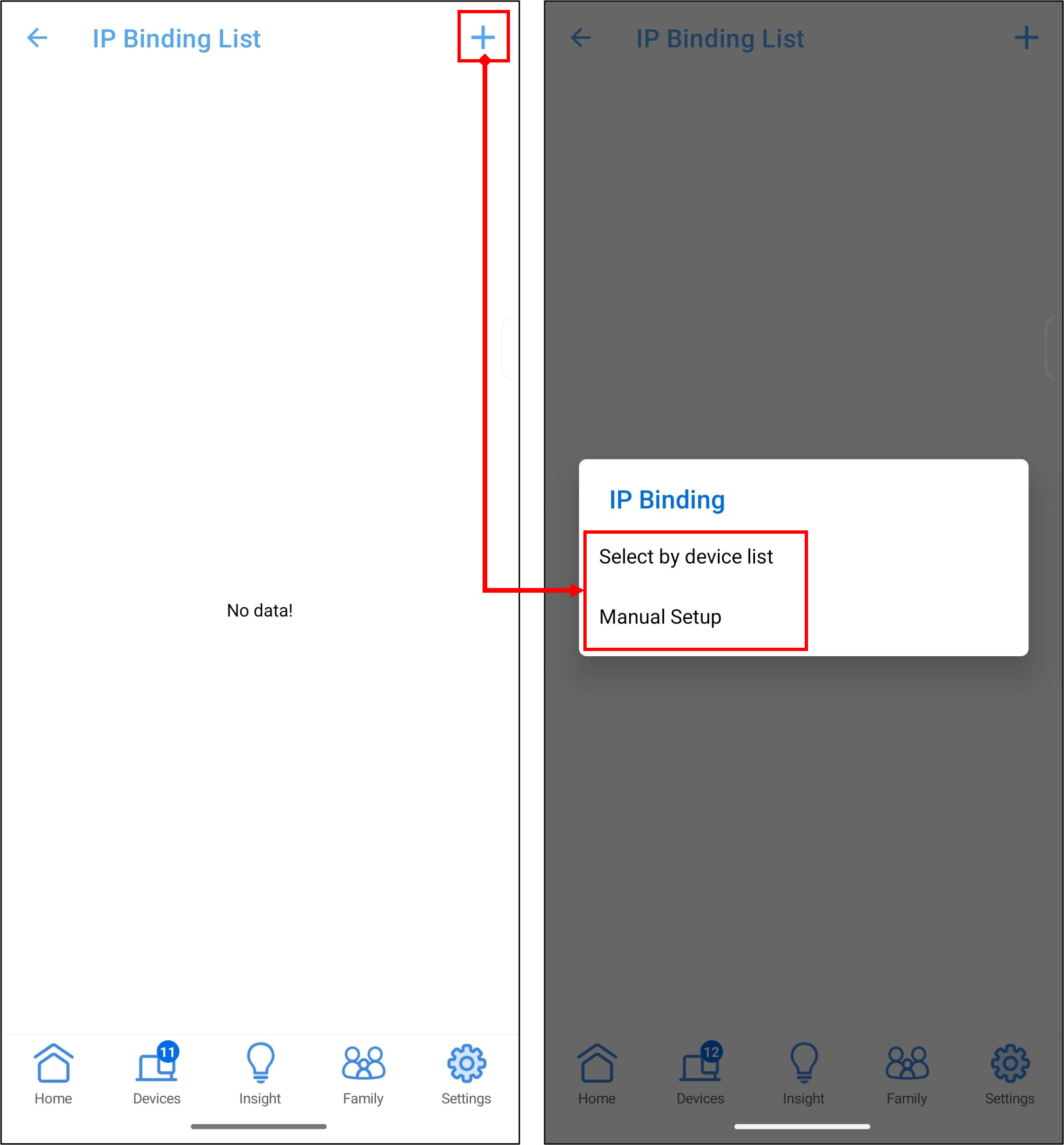

2. Tap [+], you can choose between two methods to specify the IP address: [ Select by device list ] and [ Manual Setup ].

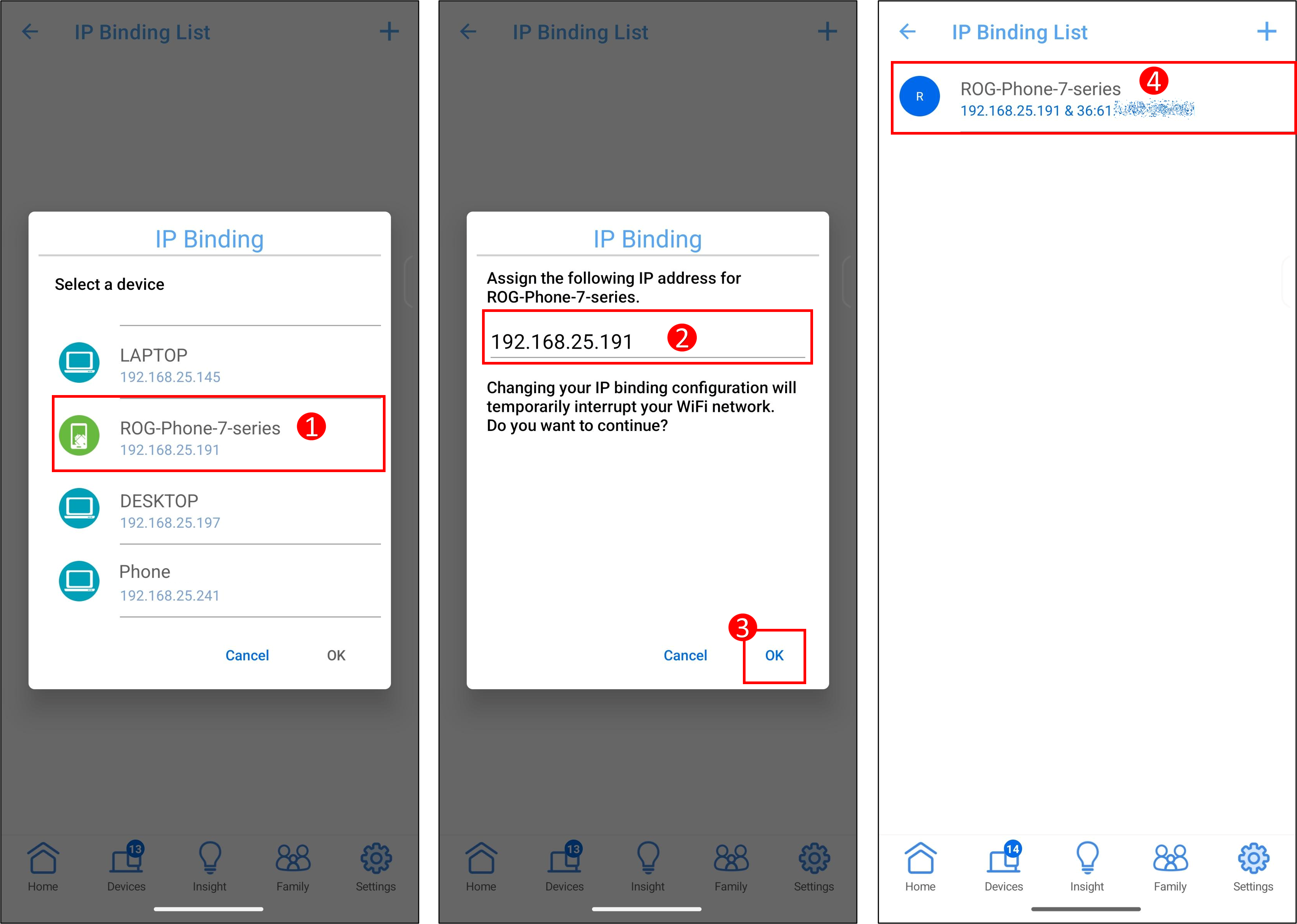

(1) Tap device name.
(2) The system will automatically fill in the IP address, and you can also manually enter a specified IP address.
Note: Please make sure the IP address needs to be in the IP pool of your DHCP server. For example, if the IP pool of your router’s DHCP server is 192.168.25.2~192.168.50.254​, you should enter an IP address within this range, like [192.168.25.191].
(3) Tap [ OK ] to save the settings.
(4) The information of the bound devices will be displayed in the [ IP Binding List ].

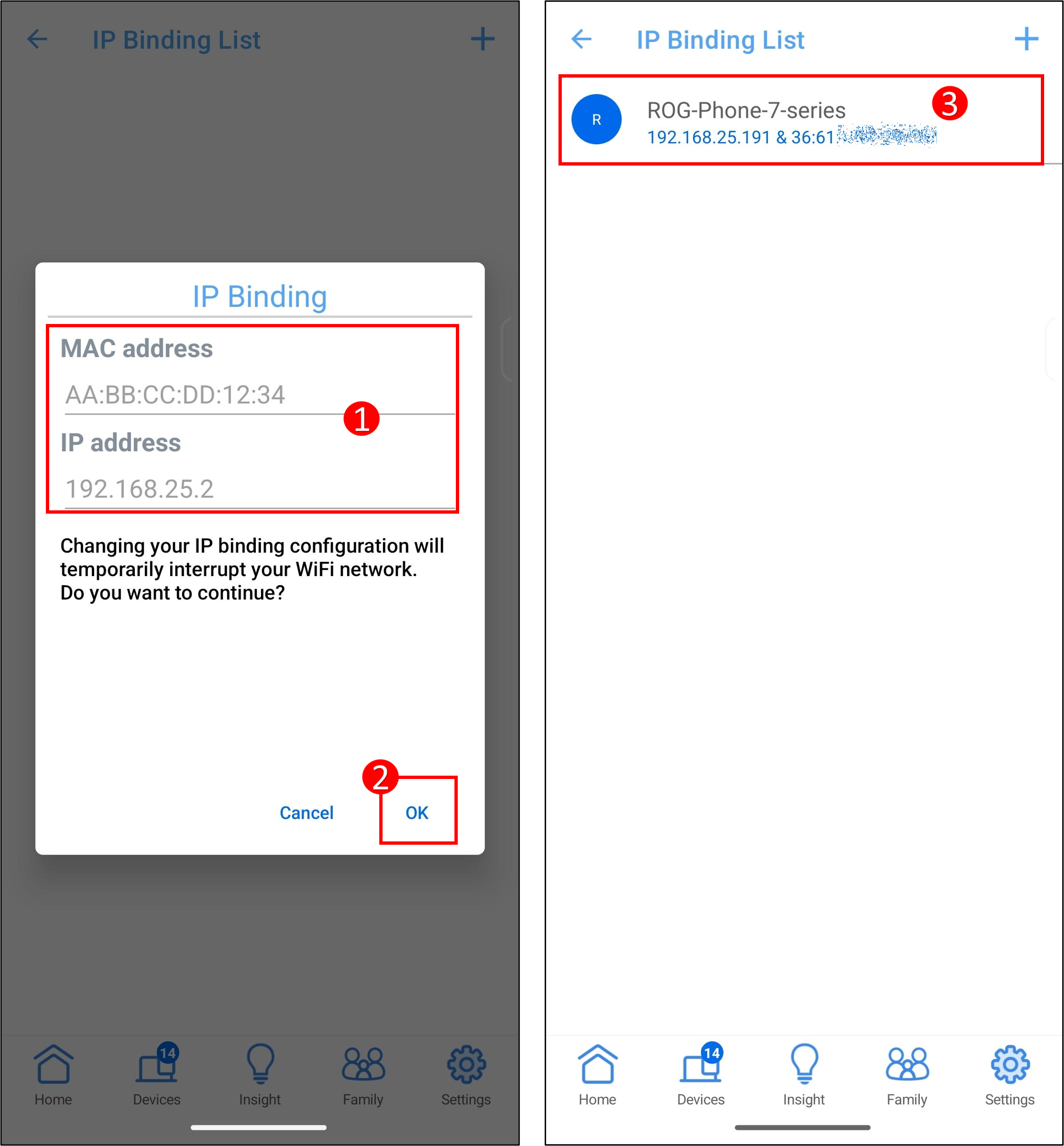

[ Manual Setup ]
(1) Client Name (MAC Address):Enter the device's MAC address.
     Note: When entering the MAC address, the format consists of six groups of hexadecimal numbers, with each group containing two digits, separated by colons. (e.g., 12:34:56:AA:BC:DE)
     IP address:Enter the IP address.
(2) Tap [ OK ] to to save the settings.
(3) The information of the bound devices will be displayed in the [ IP Binding List ].

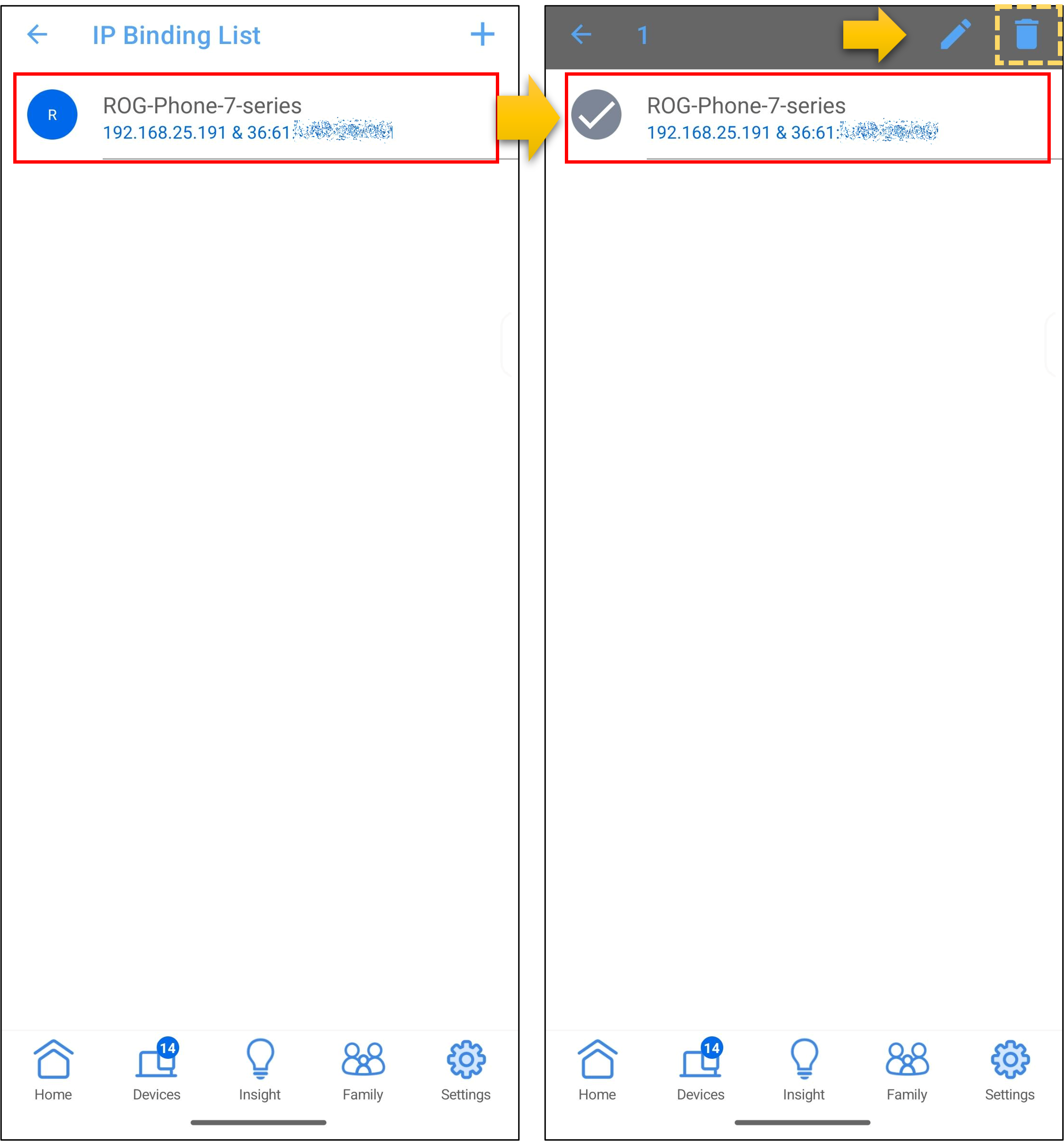

4. To remove a device from the list, as shown in the example below, tap the device name in the [IP Binding List], then tap the Delete icon > [ OK ] to save the settings.

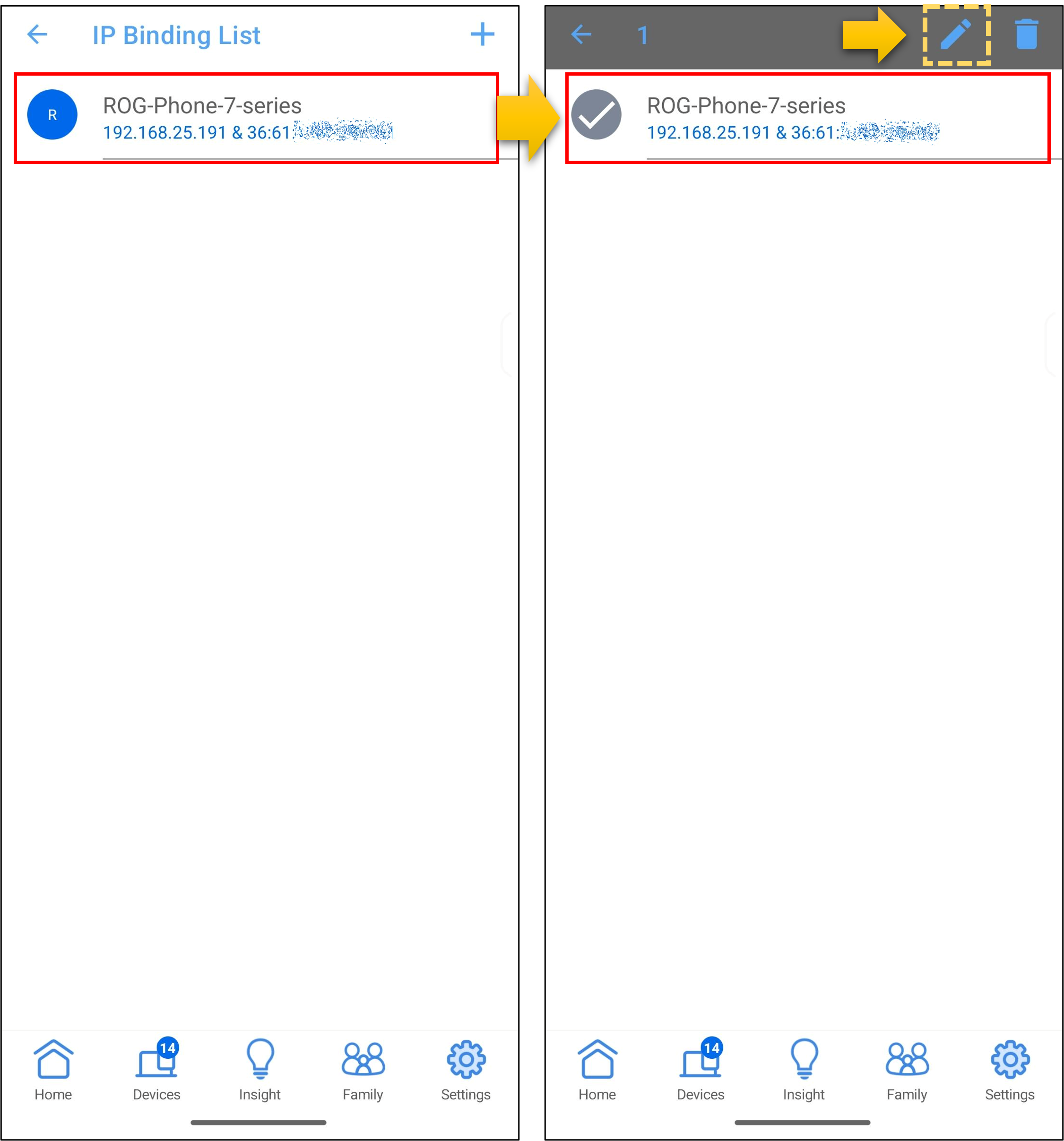

3. Can I change to the IP address after rule is set?
    a. In the router app, you can modify the IP address.
        As shown in the example image below, tap the device name in th [IP Binding List] > tap [Edit] icon, make your changes, and then tap [OK] to save the settings.
