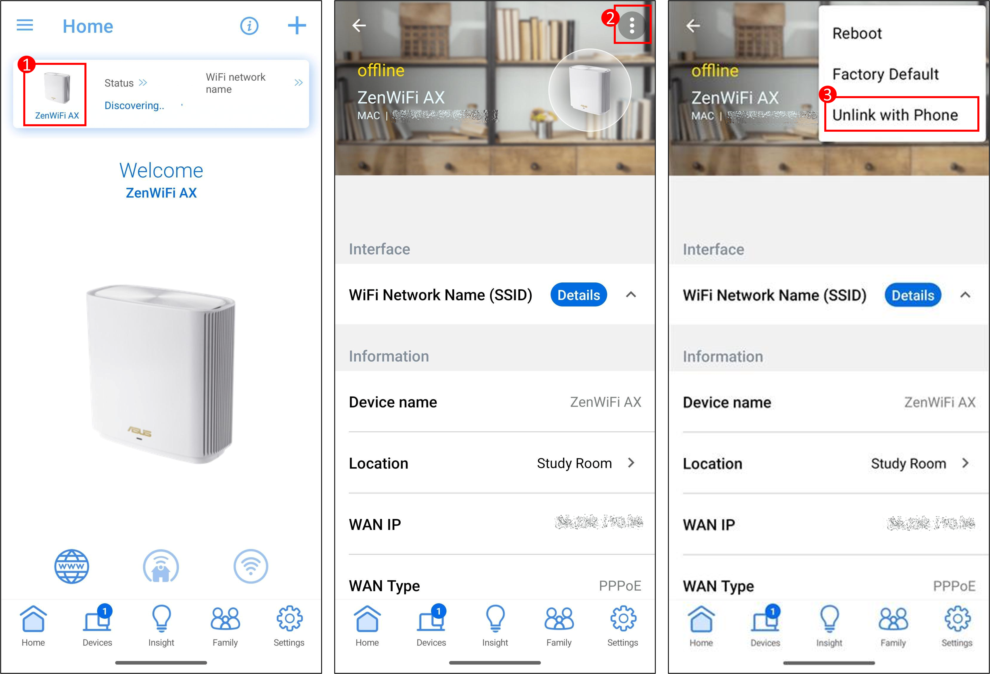

1. How to remove a logged-in router from the ASUS Router app?
    As shown in the example below, on the App homepage, click the router > click the icon > click [Unlink with Phone] to complete the process.
    If you are using the account binding feature, please [unbind your account] first.
    For instructions on account binding, please refer to another FAQ [Wireless Router] How to bind trust account to my ASUS router?
