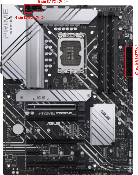

c. Check the power cable of power supply is correctly connected to ATX power connectors. Some motherboard may contain 8-pin EATX12V_1, 4-pin EATX12V_2 and 24-pin EATXPWR, we suggest to connect all three connectors to the power supply.
(Model name of photo below is PRIME Z690-P-CSM)

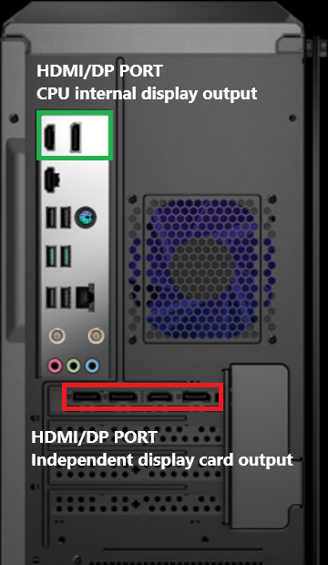

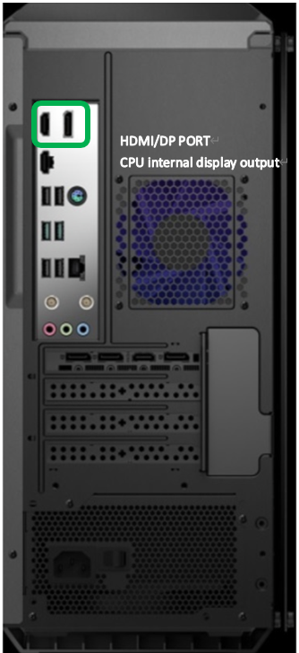

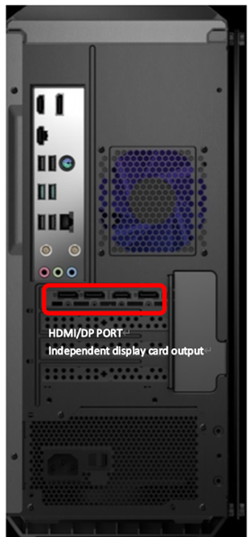

1. First, confirm whether the computer display is connected to the CPU's integrated display output port (internal display) or an output port on an independent graphics card (external display)。
CPU integrated display output port (internal display): HDMI/DP PORT CPU internal display output
Independent display card output port (external display): HDMI/DP PORT CPU independent display card output
(Note: The outputs of the graphics card may vary from its series and models)
4.1 Using the CPU's integrated graphics output port (internal display):
a. First, confirm whether the CPU supports graphics. Refer to the related FAQ link: [Motherboard] How to confirm whether the CPU supports integrated graphics output (internal display)

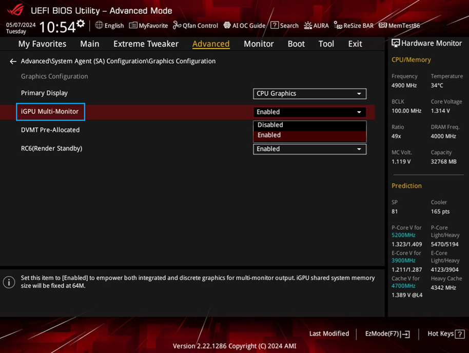

b. If the CPU supports graphics, configure the motherboard BIOS as follows:
During boot, press DEL or F2 to enter BIOS Advanced Mode. Select System Agent (SA) Configuration->Graphics Configuration->iGPU Multi-Monitor and confirm that it is set to Enable. Press F10 to save the BIOS settings and reboot.
(If no display appears during boot, it is recommended to use an external graphics card to configure the BIOS. For the BIOS configuration path, refer to the motherboard manual.)
C. Please make sure that the computer display is connected to the CPU integrated display output port (internal display).
4.2 Using the output port on a discrete graphics card (external display):

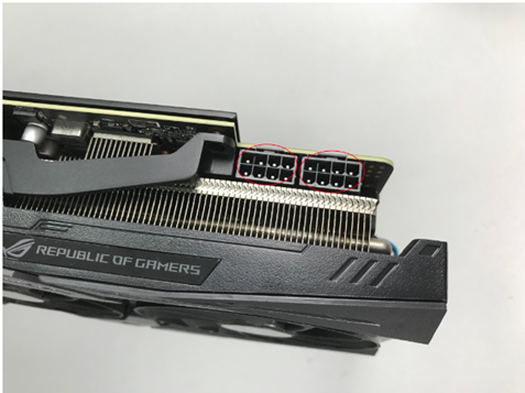

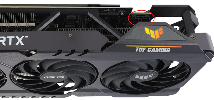

a. If the connected discrete graphics card has a power connector, please confirm that it is properly plugged in. Please refer to the related FAQ link [Motherboard/Graphics Card] How to Install a Graphics Card on a Motherboard
b. Please try reinstalling the graphics card and confirming that the graphics cable is properly connected to the graphics output port.
*No special BIOS settings are required*

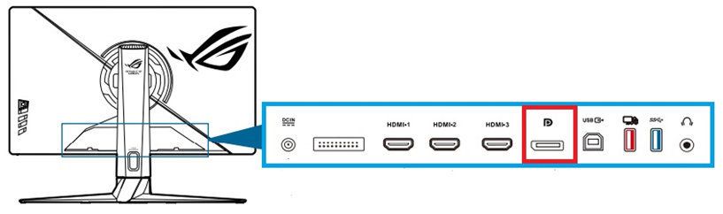

b. Verify that the signal cable (VGA/DVI/HDMI/DisplayPort) is properly connected to the monitor. Also, ensure the other end of the cable is securely connected to the computer's display output (either internal motherboard display or graphics card). You can also try reseating and unseating both ends of the cable to confirm.

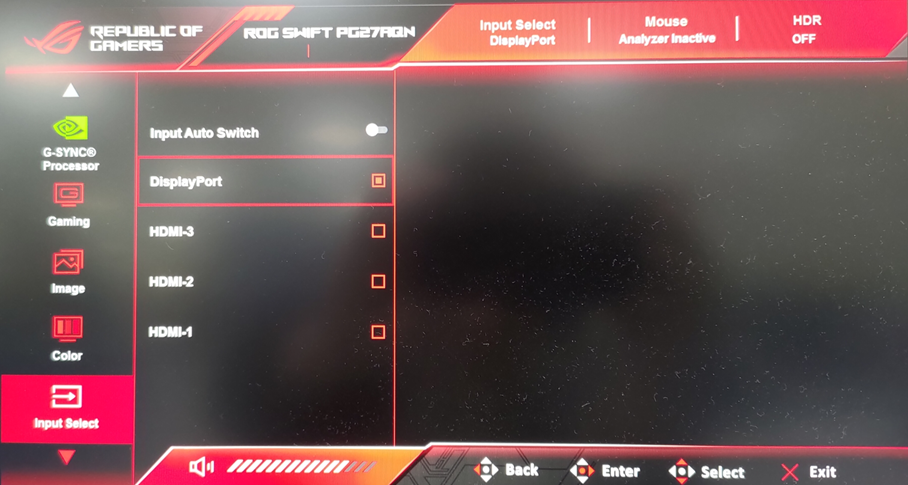

c. Verify that the monitor's display output is set correctly. For example, if the computer is currently connected via DP, select DP as the monitor's display output, as shown below.
(Example: PG27AQN)
d. If there's still no display, we recommend replacing the Display Port cable with another output cable (e.g., VGA/DVI/HDMI) to ensure the problem isn't caused by a damaged cable (and make sure none of the port pins are bent)。
