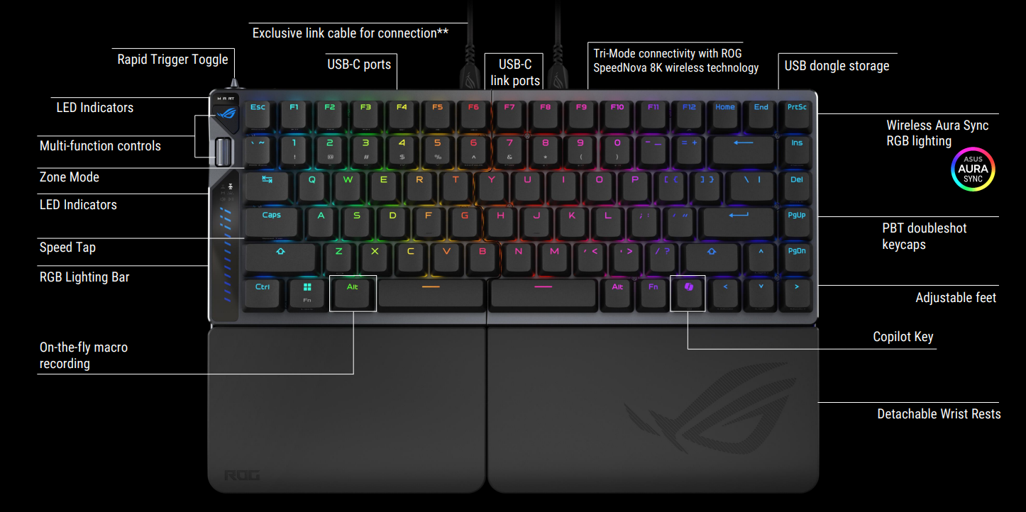

2. Product at a Glance

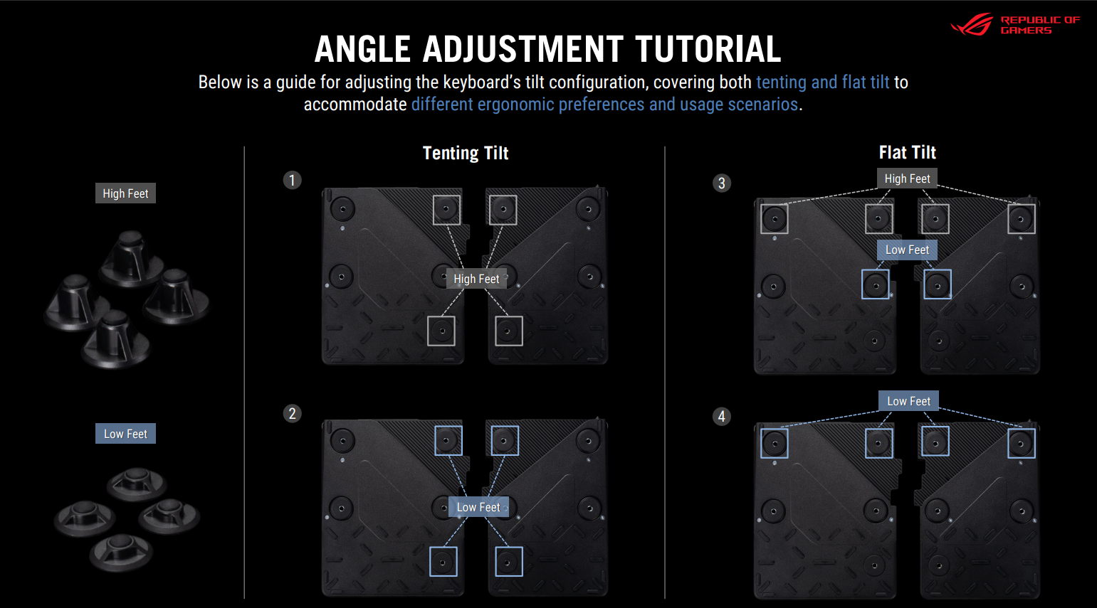

The package includes 4 tall feet and 4 short feet, which can be screwed into the corresponding holes on the bottom of the keyboard. You can choose from five different typing angles: the starting flat angle without feet installed, the traditional flat angle, or the new ergonomic tenting angles. For detailed installation instructions, please refer to the keyboard angle guide shown in the illustration below.
4. Settings for Multi-function Controls
Press the button inside the yellow box to switch between different LED indicator settings, and use the wheel to adjust the values for each setting.
The multifunctional knob and buttons allow you to easily adjust various settings.
The LED indicator patterns shown below correspond to keyboard actuation point adjustment, rapid trigger sensitivity adjustment, custom commands, keyboard brightness adjustment, media volume control, and multimedia playback.
Additionally, the LED side light bar dynamically displays real-time lighting effects to indicate the current adjustment status of these settings.

When switching to the keyboard Actuation point adjustment or Rapid Trigger (RT) sensitivity adjustment, you can check the current setting via the light bar on the left side of the keyboard. The light bar displays 12 diagonal lines (3 long and 9 short) to indicate the current value. The long lines represent the integer part, while the short lines represent the first decimal place. For example, when the actuation point is set to 1.6mm, one long RGB-lit line and six short white-lit lines will be illuminated. The smaller the value, the shorter the actuation distance.

Q3: Is there any indicators showing the status of Caps and Windows Lock?
A3: Yes, the indicators of Caps and Windows Lock are on the top left corner of ROG Falcata, just below the Rapid Trigger Toggle. The indicators will light up in white when turned on.
