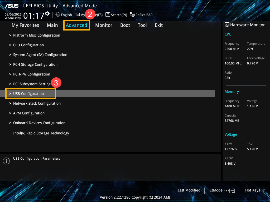

Check USB Function Settings in BIOS
  1. Enter the BIOS configuration utility:
    With the computer powered off, press and hold the [F2] key, then press the [Power button]. Release [F2] once the BIOS configuration screen appears. For detailed instructions, please refer to the relevant article on How to access the BIOS configuration screen.
  2. In the BIOS setup screen, press the [F7] key on your keyboard, or click [Advanced Mode] on the screen
    Note: The BIOS interface may vary slightly depending on the model.
  3. Navigate to the [Advanced] tab, then select [USB Configuration]

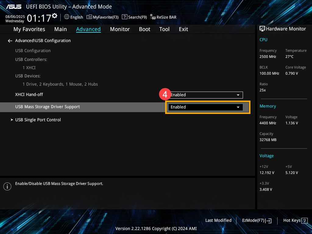

  4. In the USB Configuration menu, ensure that USB Mass Storage Driver Support is set to [Enabled]
  5. Save the settings and exit. Press the [F10] key, then select [Ok]. The device will reboot and the new settings will take effect.
