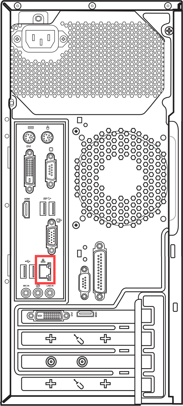

Make sure whether the internet cable is well plugged
  1. Check whether there is anything stuck in the slot for network cable, this might be poor contact for network cable.
    Note: If you are using a USB-to-Ethernet adapter, please ensure that the adapter is properly connected, and check for any loose plugs or damaged cables.
  2. Check whether the latch in the slot for internet cable is broken, broken one might make the cable loose. If it's found loose, try and test with a new internet cable.
