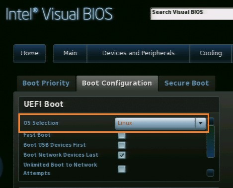

Before beginning the Linux OS installation
Before beginning the Linux OS installation, set the Visual BIOS as follows:
  1. Press F2 during boot to enter Visual BIOS.
  2. Go to Boot > Boot Configuration.
  3. Set OS Selection to Linux. This option automatically enables the eMMC device.
  4. Press F10 to save and exit.
eMMC for Linux*

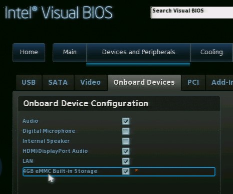

Accessing the eMMC storage from Windows 8.x
The eMMC storage device might not be large enough for any Windows 8*, 8.1*, or 8 embedded installation. But, you can enable the device to be accessible for extra storage space.
  2. Go to Advanced > Devices and Peripherals > Onboard Devices.
  3. Select Enable 4 GB eMMC Built-in Storage.
eMMC for Windows 8*
