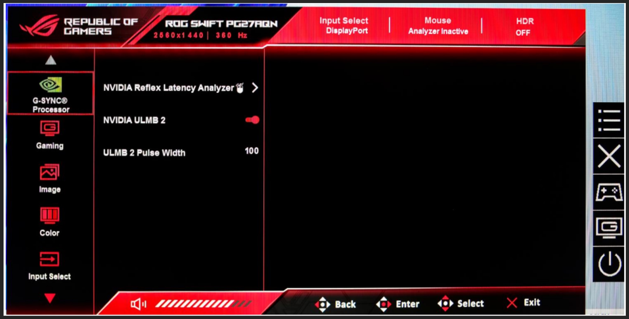

Step 4: Turn on ULMB 2
After the update process has completed, you’re ready to turn on ULMB 2 and give it a whirl in your favorite game. There’s a two-step process to make this happen.
First, open the NVIDIA Control Panel. Click on “Set up G-SYNC" in the Display menu. Then, disable NVIDIA G-SYNC Variable Refresh Rate. This will allow your backlight to enter backlight strobing mode.
Then, open up the OSD menu. In the ”G-SYNC Processor” tab, you’ll find a setting for NVIDIA ULMB 2. Toggle it on, and you’re good to go.
