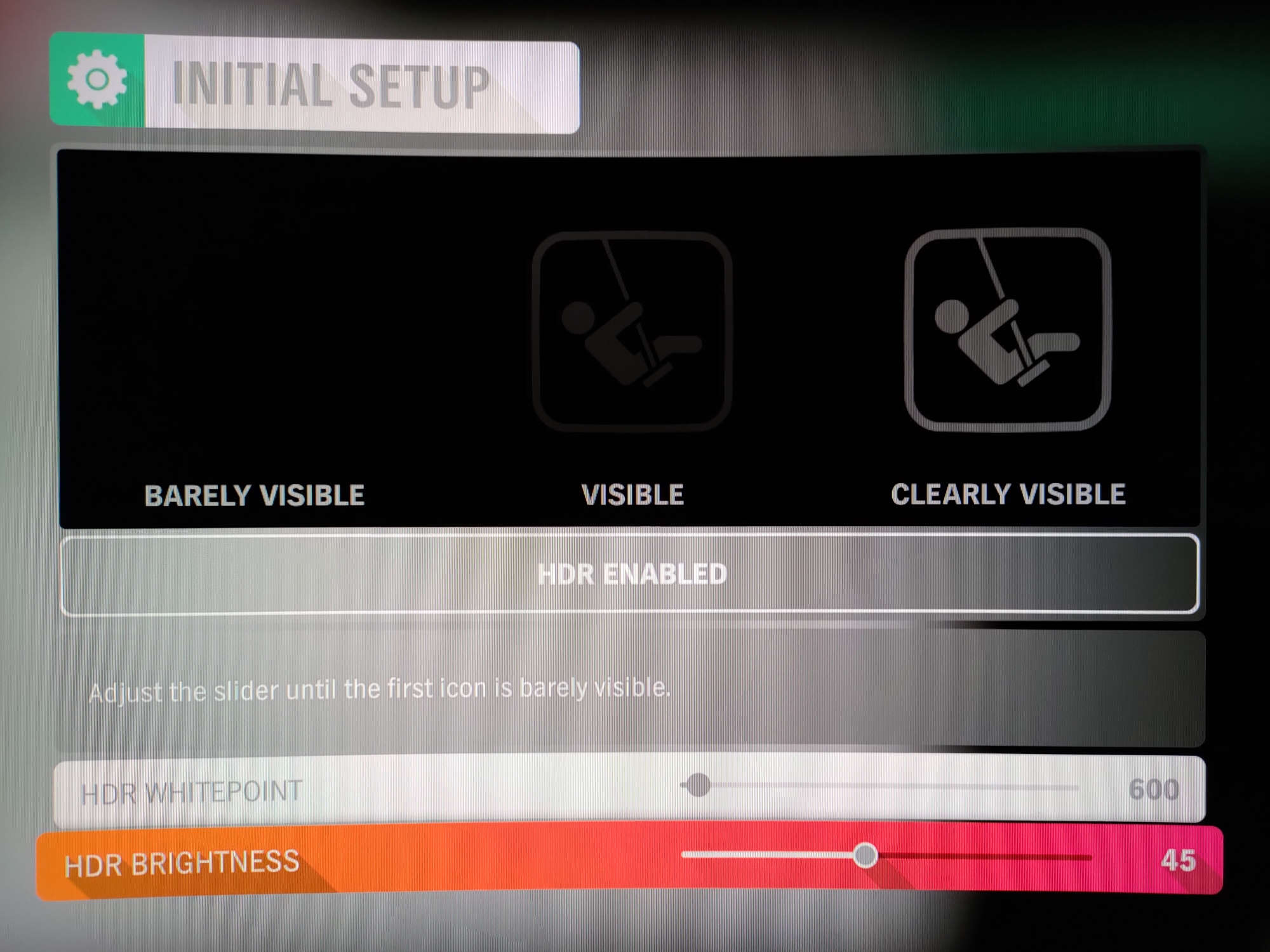

Forza Horizon 4

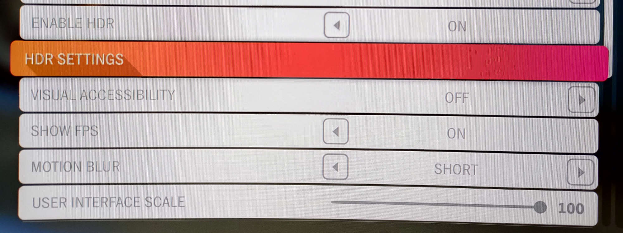

Because Forza Horizon 4 is one of Microsoft’s Universal Windows Platform apps, I had to follow a different path to turn on HDR compared to the other games I tested. For any HDR settings to appear in Forza Horizon 4 at all, the Windows 10 “Play HDR games and apps” toggle has to be turned on first.
If you need to keep one foot in the world of SDR content, as I do, that requirement could be annoying. Not many games are distributed exclusively as UWP apps, so depending on the titles you prefer to play, you may not run into this annoyance.

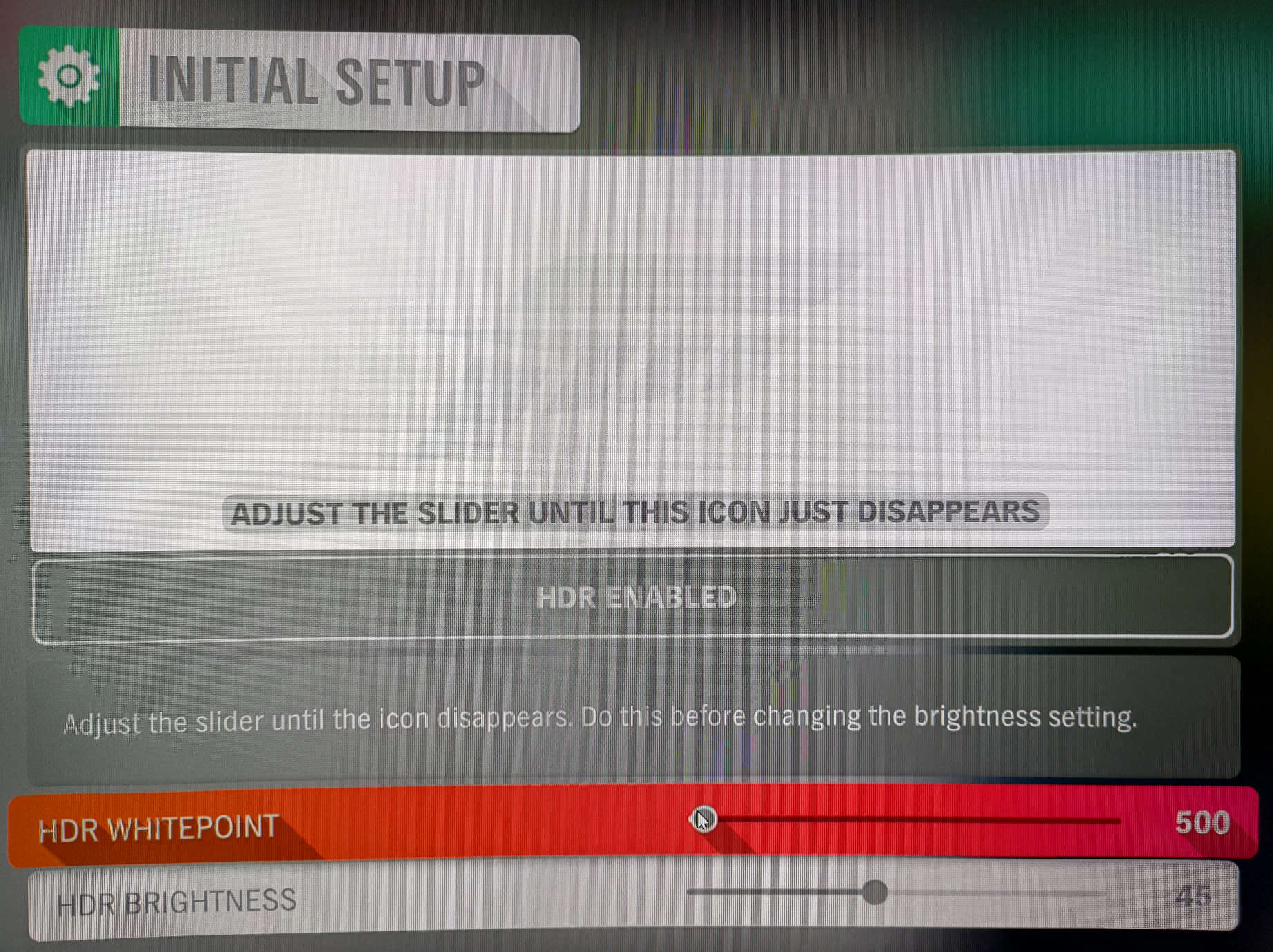

Once the Windows HDR toggle is enabled, Forza will display a menu option of its own to turn on HDR. After that switch is flipped, you’ll get a sub-menu to configure your HDR experience.
This configuration menu has two setup steps for HDR content. The “HDR Whitepoint” menu sets highlight levels using a Forza logo that will disappear into the background at a certain point on the accompanying slider.
The second “HDR Brightness” setting establishes the proper placement of middle grays and shadow tones once the HDR whitepoint is set.
After setting the HDR Whitepoint slider to 600 nits, I was worried that figure would leave some of the PG35VQ’s HDR capabilities on the table. HDR Whitepoint seems to set a typical whitepoint rather than a cap for the brightest highlights in the game, though. I still got plenty of squint-inducing sun peeking through the clouds and glinting off my car’s paintwork, and I didn’t see large areas of the screen clipping to white—a telltale sign that your HDR settings aren’t tuned properly.
Indeed, setting the slider to 1000 nits (the PG35VQ’s rated peak brightness) caused large areas of bright highlights, like clouds, to lose detail and wash out to white in Forza Horizon 4. Respect the game’s instructions here.

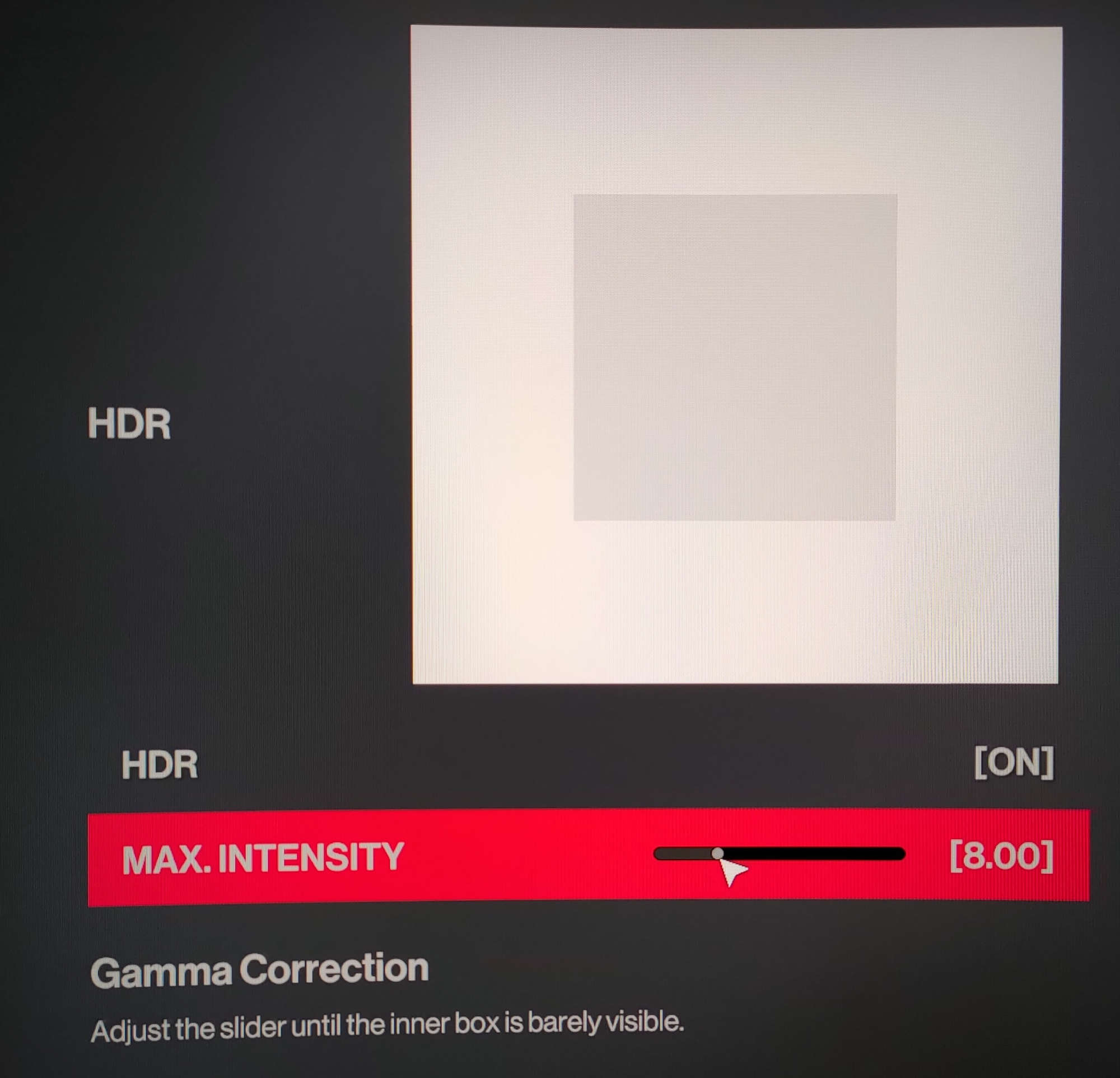

To experience Hitman 2’s world of assassination in HDR and wide color, start the game and use the pre-game launcher’s graphics options to turn on HDR.
Once you toggle on HDR mode, you’ll want to head into the game’s options menu, choose “Graphics,” and then choose “HDR.”
Hitman 2 will then present you with a gray square inside a white square and a slider to match the brightness of the two quadrilaterals. Just increase or decrease the value of the slider until the two squares match, and you’re good.

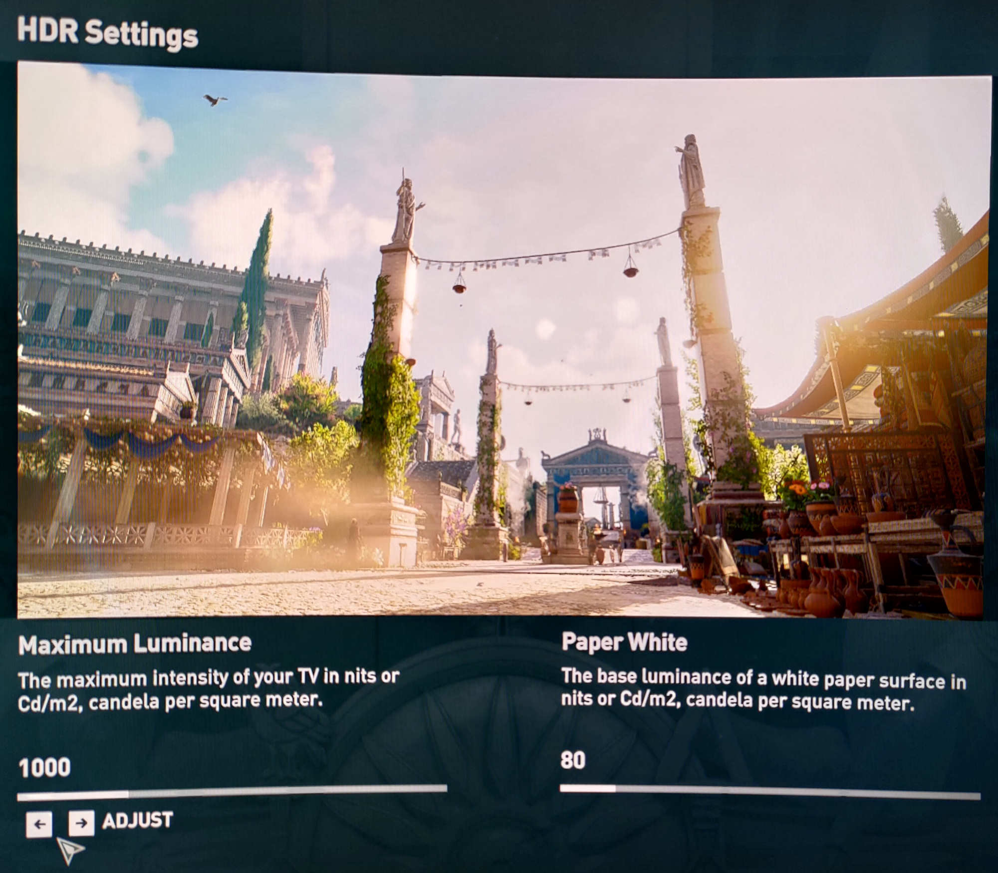

Assassin’s Creed Odyssey
Assassin’s Creed Odyssey gives gamers two HDR sliders to play with: one for what’s called a paper white or reference white, and the other for the peak brightness of highlights like the sun.

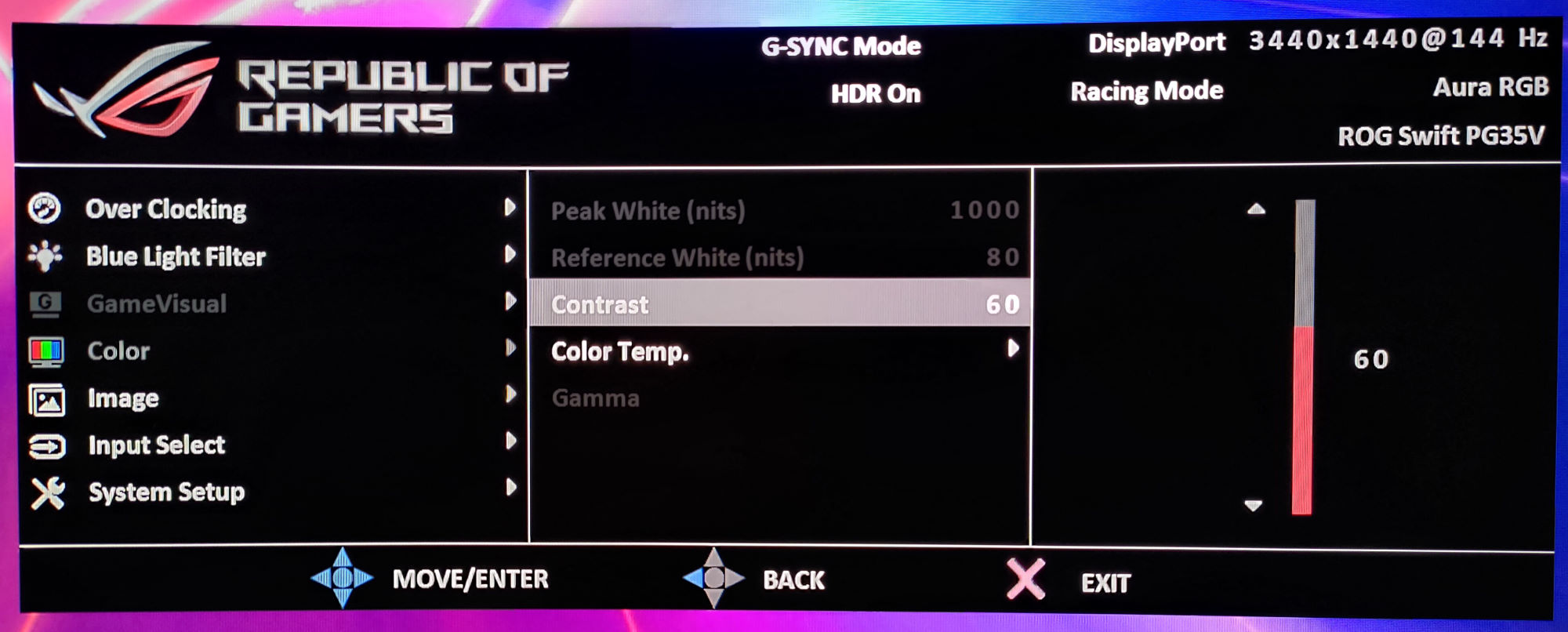

You may find yourself wondering how any game that asks for this information expects the end user to know it offhand, but worry not. We put this information right in the PG35VQ’s on-screen display so that you can quickly reference it for any game that asks for it. Just open the OSD by clicking the joystick, move down to the Color section, and you’ll see our recommended values for these specs.
With our built-in recommendations in mind, I set Assassin’s Creed Odyssey to use a paper white point of 80 nits and a maximum brightness of 1000 nits. With those settings in place, the game looked great without any further tuning. Score one for easy setup.

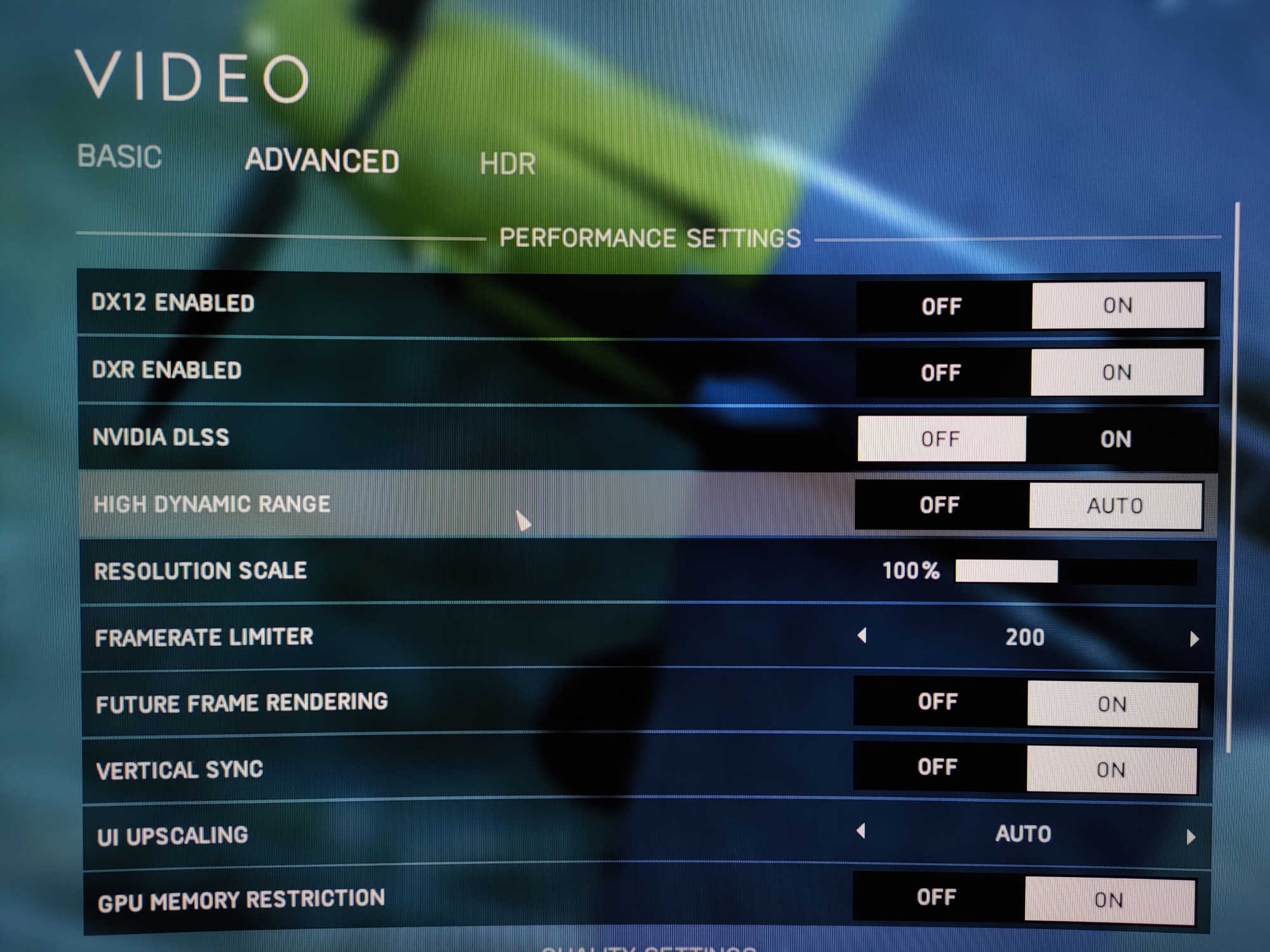

Battlefield V
Battlefield V uses the common combo of a toggle to enable HDR and a separate “match the brightness of these two white squares” slider to set the proper brightness level for HDR highlights.
I figured that the number displayed on the slider corresponded to nits, but despite the PG35VQ’s 1000-nit max brightness or thereabouts, I was able to push Battlefield V’s slider all the way to a value of 1500 before I judged the brightness of the two squares to be even.
Despite the apparent mismatch between my monitor’s specs and the in-game settings, I didn’t observe any weird behavior or off-putting issues with the look of Battlefield V after setting it up this way for HDR, so it’s a fine example of why it can be important to trust your eyes and not necessarily worry about the numbers on display.
