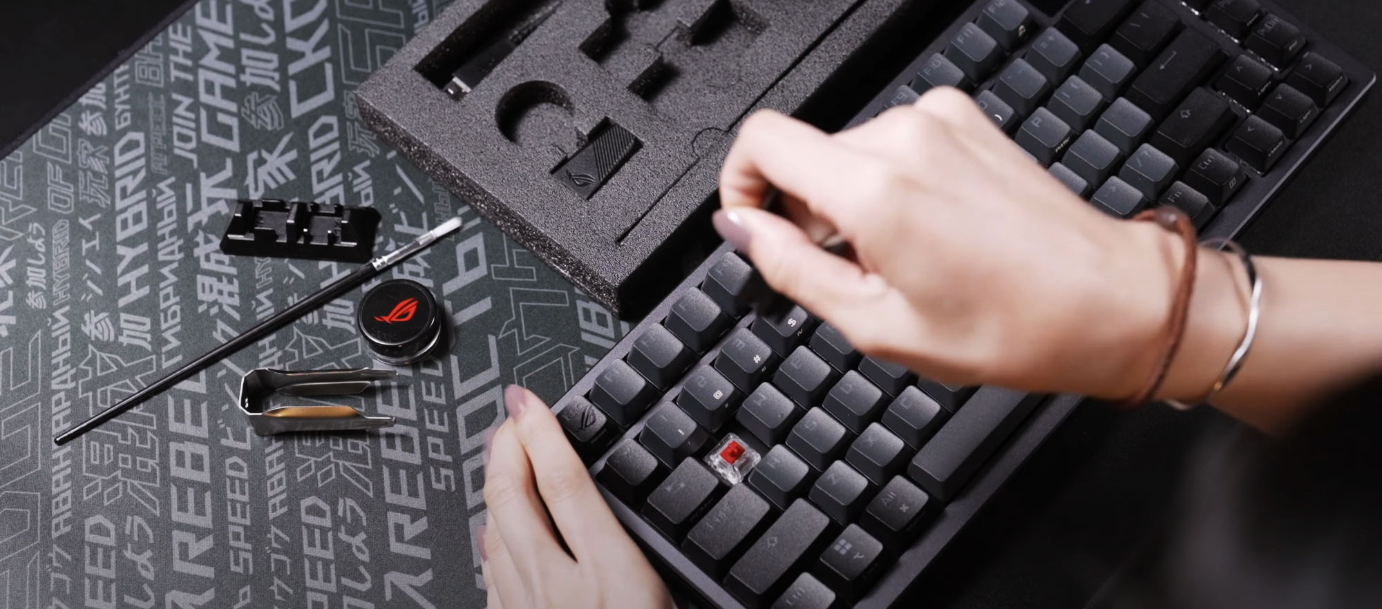

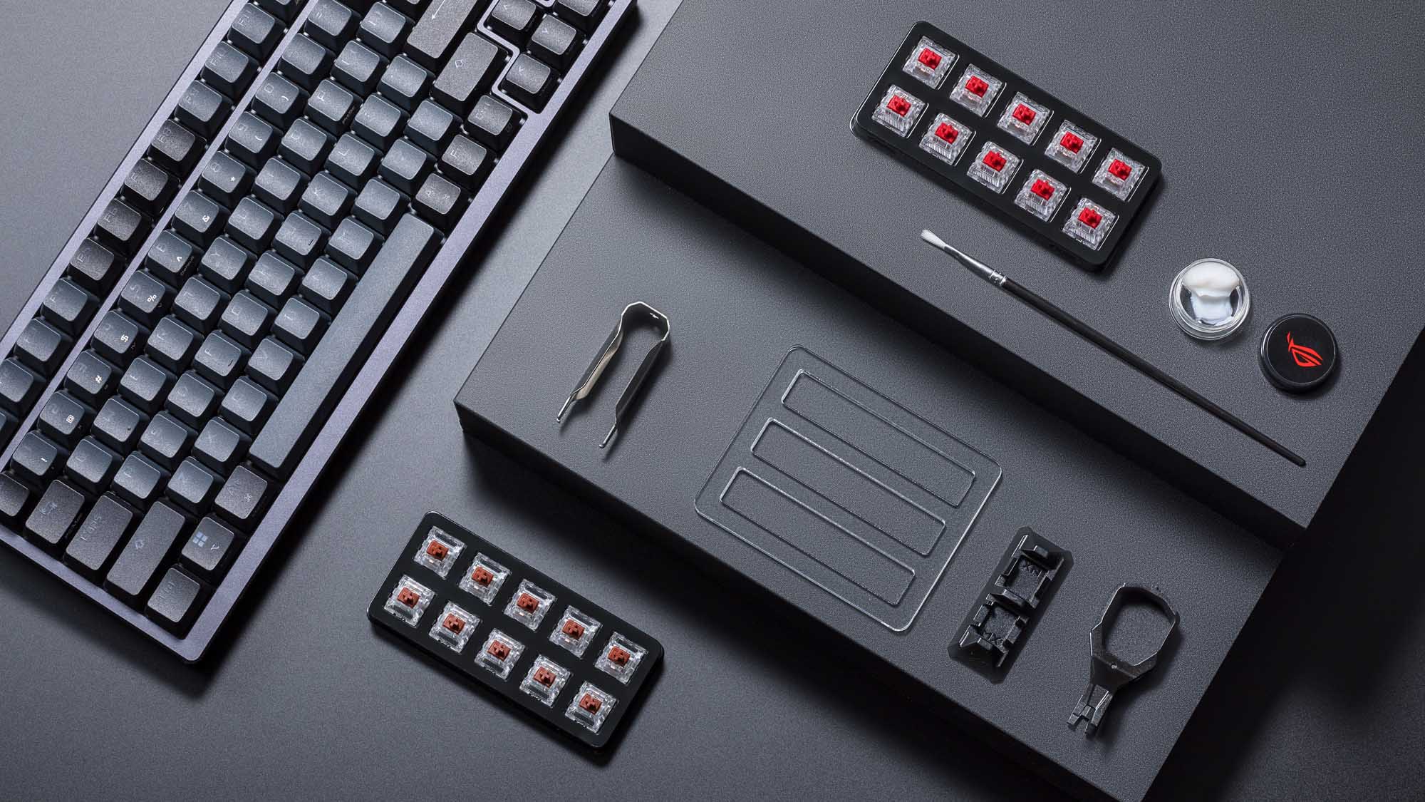

In order to lube your switches, you’ll need to remove the switches entirely from your keyboard. Typically, this involves desoldering them manually, but with hot-swappable keyboards like the ROG Azoth, you can pull them right out with the included switch puller. The Azoth even includes a lubing kit with everything you need to lube your switches. The lube kit includes:
- A small paint brush
- Lubricant for your switches
- A keycap puller and switch puller
- A switch opener

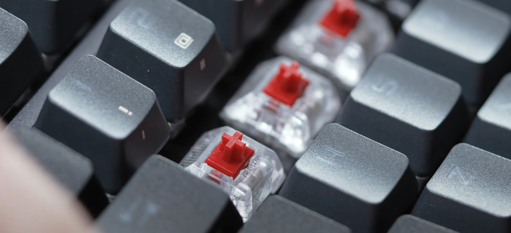

Next, grab your keycap puller, place it over the keycap, and push down so the 2 prongs will clasp to the underside of the switch. Pull upward and the keycap should come off with ease, exposing the keyboard switch. You’ll need to do this this with all your keycaps, so make sure you store them in a place you won’t forget.
After you’ve removed the keycaps, continue to remove the switches themselves. You’ll want to be careful on this part, as you don’t want to end up damaging the PCB. Start by using the switch puller to clasp on to the north and south sides of the switch. Once in position, squeeze the switch puller to depress the tabs and lift the switch out of the socket. Do this for all of your switches.

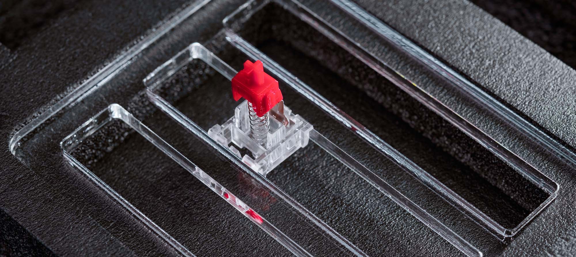

Once all the switches are removed, use the switch opener tool to disassemble the switch. Place the switch in the correct orientation with the top of the switch face up. Push down and you will see the switch unhinge and come apart. Our switch opener actually has two slots — one designed for ROG’s own NX switches, and another that should work with Cherry MX and other similar switches.
For best results, place each part of the switch — top housing, stem, and spring into separate bowls or containers for easy access. You can put the bottom housing into the lube station included with the ROG Azoth.

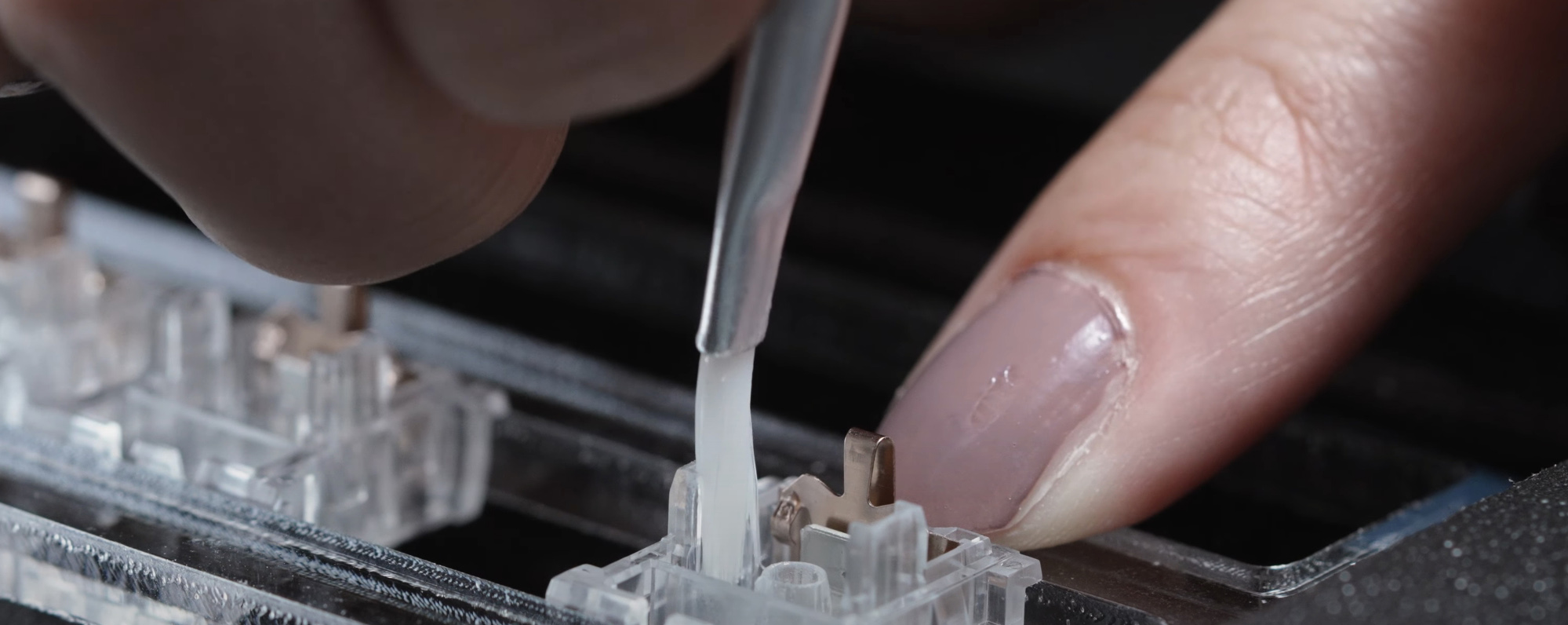

Now it’s time to start lubing. Take your paintbrush, dip it into the lubricant, and brush off any extra. You only want a small amount on the brush — about 1mm to 2mm worth of lube. Start with the bottom housing. Brush the lube on the the east and west railings where the switch stem makes contact. If you like, you can use any leftover lube on the brush to lube the gold leaves located on the north side of the switch — though some people prefer to leave this part alone to retain tactility on brown switches.

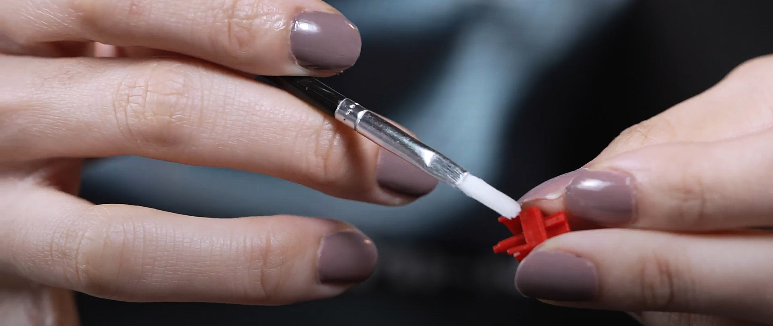

Next, move on to the stem. Dip your brush into the lube to obtain the same amount of lube as before, then lube all four sides of the stem evenly. Next, take any residual lube and continue to lube the cylindrical area on the bottom of the switch. Your switch should have a nice thin, even coating with a slight sheen to the stem. Again, you can lube the legs of the stem if you desire, though some people prefer to skip this step on tactile brown switches to retain the feel of the bump. You can also lube the top and bottom of the spring if desired, which can reduce pinging sounds. Once finished, re-assemble the switch.
