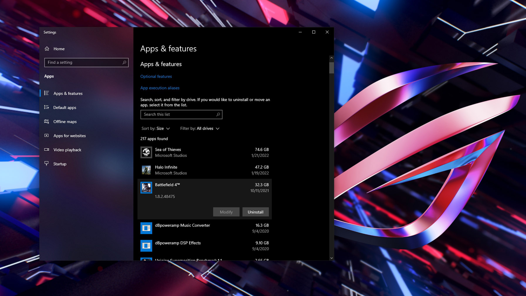

If you aren’t using a program anymore, think about uninstalling it. Some applications can run in the background, taking up valuable system resources, or create conflicts with other processes. You can also limit which processes start with Windows—background apps that you don’t need when gaming can impact performance, and quickly going into the Task Manager and disabling unused or unneeded apps from auto-running can help you regain some frames in game.
Uninstalling programs will also free up storage space, which can help speed things up if your drive was full to the brim. If your SSD is nearly full, it may also help to clean out large files or games you don't need. Try to keep your drive around 75% full to balance capacity with performance. Another quick tip to regain some extra performance is limiting processes on Windows startup. And of course, run a Windows Defender scan to ensure malware isn't eating up precious resources.
