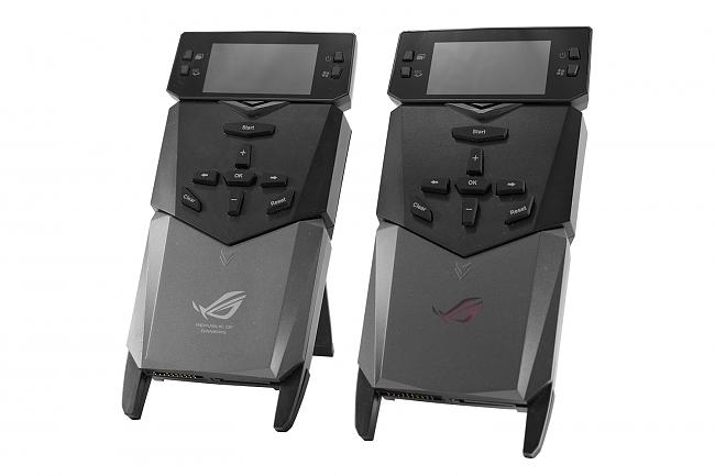

Before we start with the flash process, it is of utter importance to identify which OC Panel you own. Flashing the wrong firmware can certainly brick the device. Upon inspection, original OC Panel has a simple white ROG logo on the cover while the OC Panel II has a translucent red ROG logo on the cover that lights up when the motherboard is turned on.

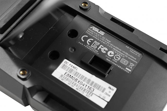

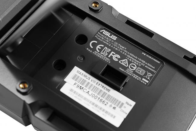

If you bought the OC Panel from a third party seller, it would be wise to examine the sticker that’s on the back of the device. Better safe than sorry.

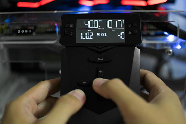

In order to check your OC Panel’s firmware, you need to have it connected to the motherboard and your system must be on so that the device is getting power. Then proceed to push and hold the OK and Clear buttons for approximately 7 seconds. The current firmware will appear on the display.

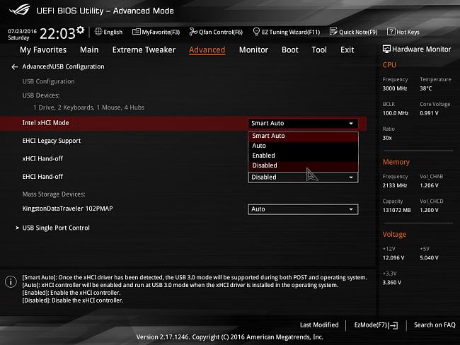

This step might be different depending on which motherboard you own. You need to enter your BIOS and disable the Intel xHCI Mode option. This option is normally found under the USB Configuration section in the Advanced tab.

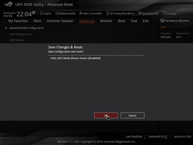

After you’ve disabled the option, press F10 to save your changes and exit the BIOS. Your system will restart and go on to load your OS.

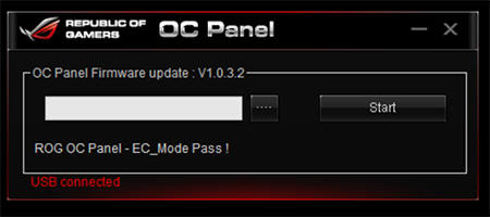

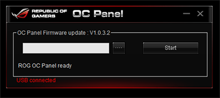

Run the Firmware Update Tool with administrator privileges. Then click the … button and look for the file that has the H00 termination. Click the Start button to initiate the flash process.
The process should finish in a matter of seconds. If the flash is done correctly, you will see the EC_Mode Pass! message at the end.

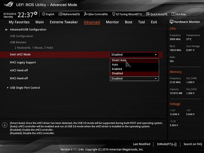

Time to go back into the BIOS and change the Intel xHCI Mode option back to Smart Auto.
Press F10 once more to save your changes and exit the BIOS. Enjoy your newly flashed OC Panel / OC Panel II on your Rampage V Edition 10.
