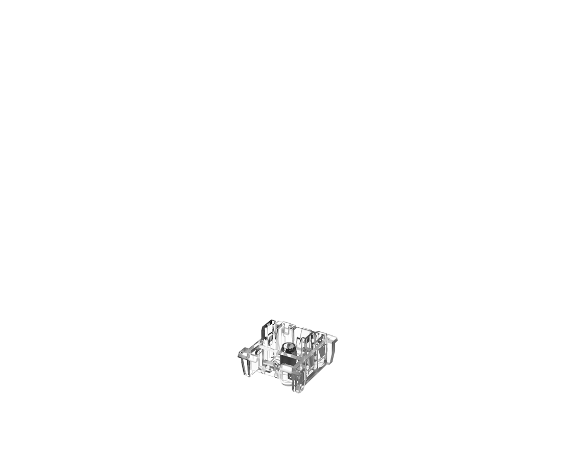

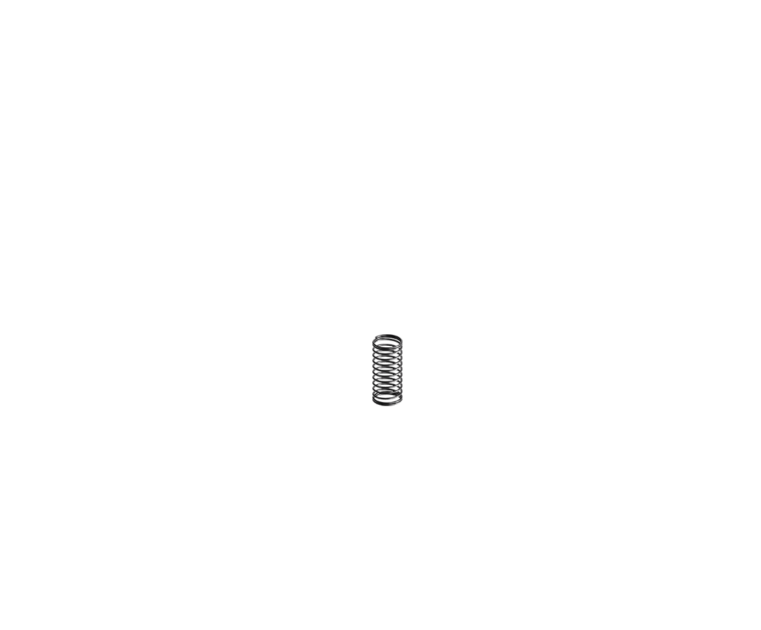

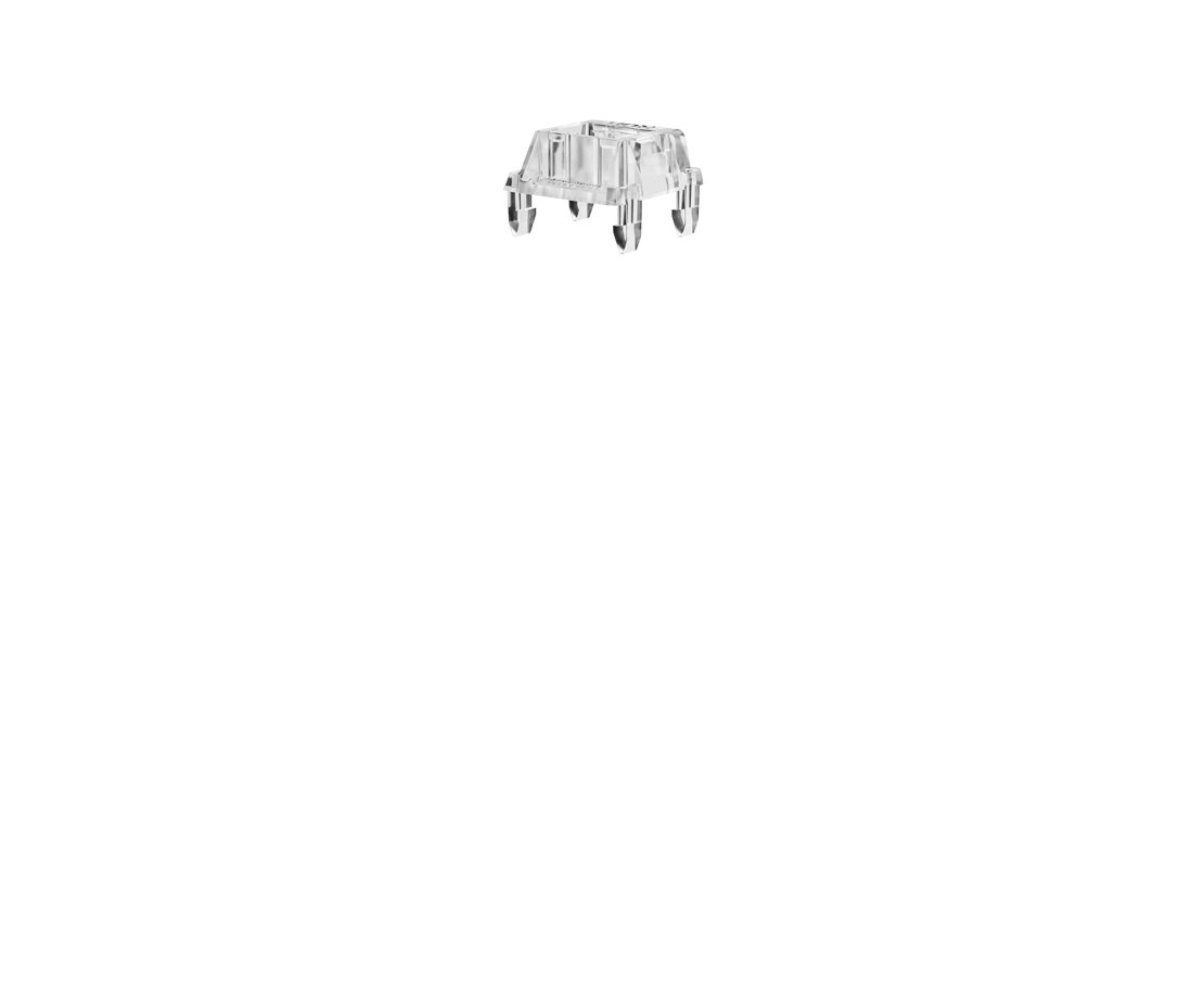

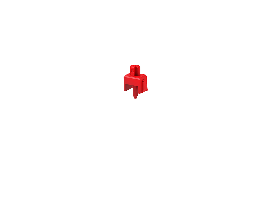

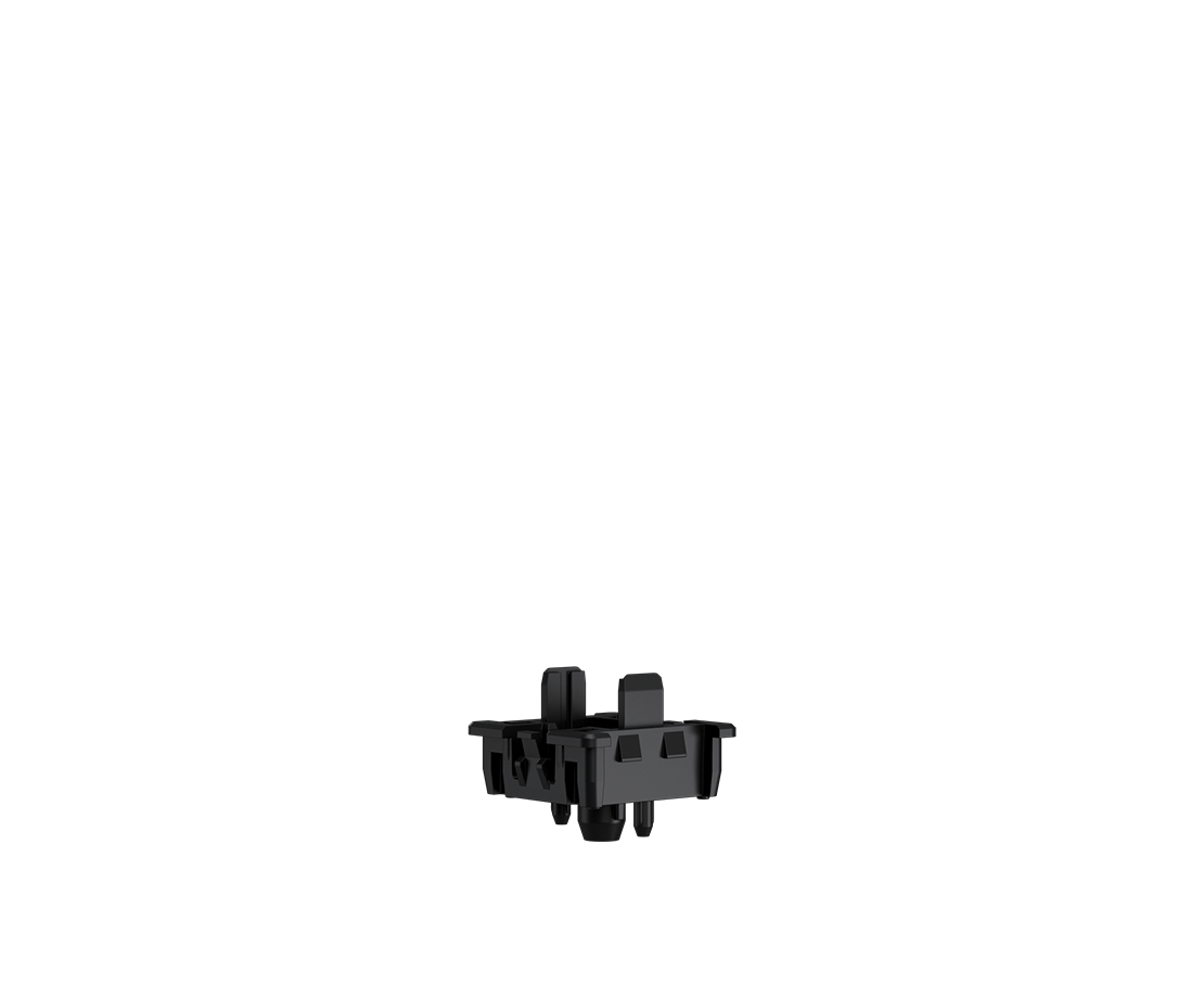

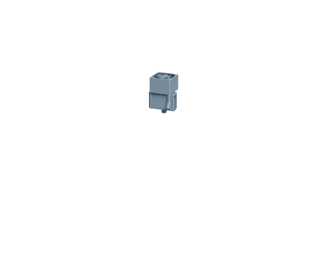

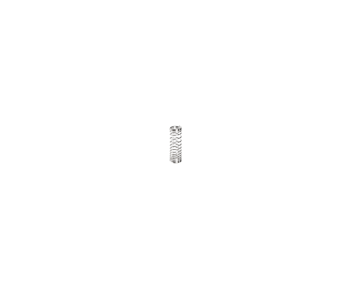

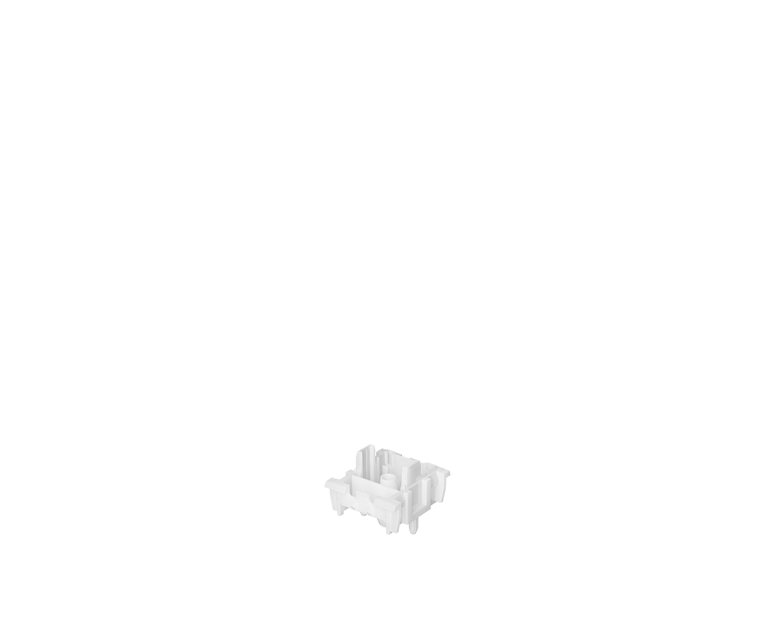

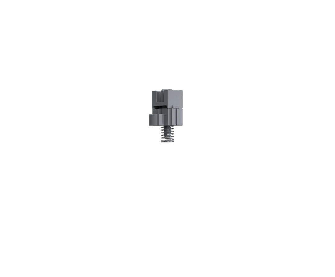

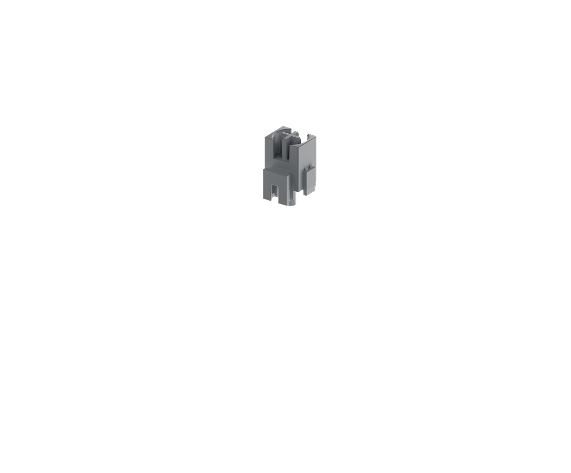

The ROG HFX Magnetic Switches utilize POM plastic for its stem and bottom housing, and PC for the top housing to provide ultrasmooth keystrokes. Additionally, the walled stem design enhances stability and keeps out dust. Special tuning is also done, coupled with factory pre-lubing, to give the ROG HFX Magnetic keystroke a very solid and clean sound.
ROG HFX Magnetic explosive view, showing all component parts -
Top Housing
PC top housing with the stem contact areas highly polished to ensure keystroke smoothness.
Stem Design
The walled stem design enhances keystroke stability and protects against dust intrusion, while maintaining compatibility with most keycaps.
Stem Material
Made of composite POM material with low friction coefficient for smooth keystrokes.

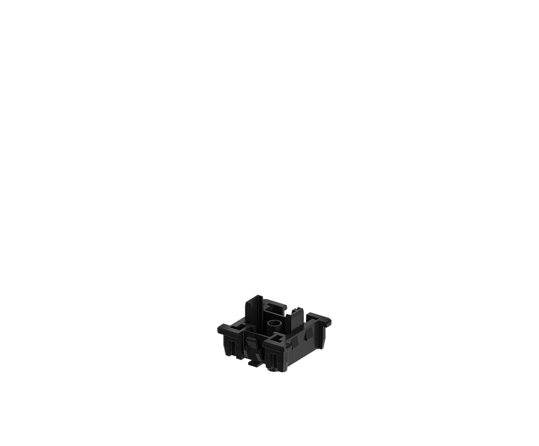

Based Housing
POM bottom housing for deeper keystroke sound.

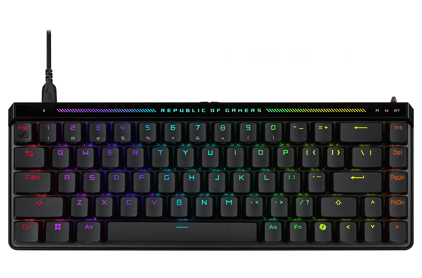

ROG Falchion RX Low Profile
65% tri-mode gaming keyboard with ROG RX Low-profile optical switches

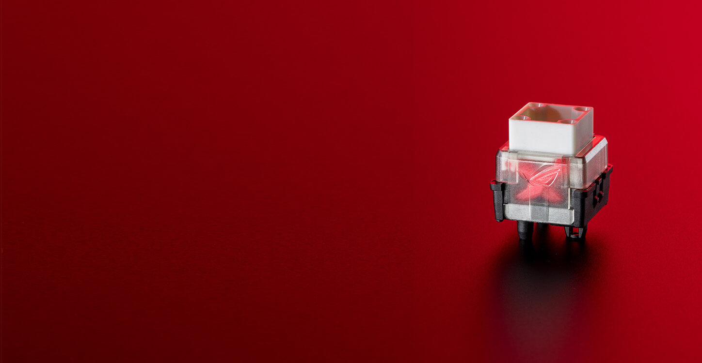

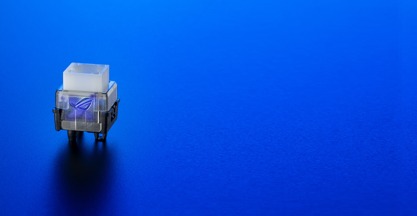

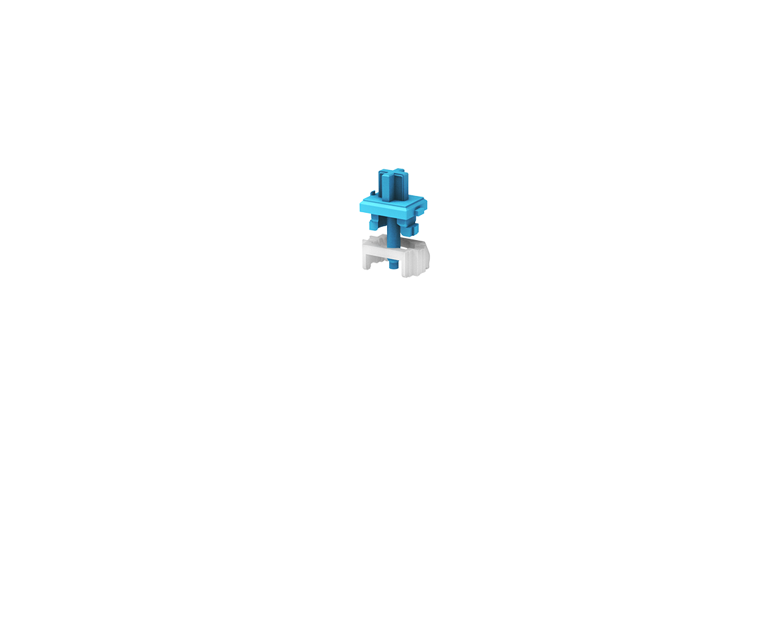

A Closer Look at ROG RX
Optical Mechanical Switch
- Light-Speed Actuation
- Consistent Keystroke Hollow-Square Stem
- Central Lighting with All-Round Illumination
- Wobble-Free X-Stabilizer
- 100-Million-Keypress Lifespan
Unlike traditional mechanical switches, the ROG RX optical mechanical switches have near-zero debounce delay that allow your triggers to be ahead of your opponents always.
Wobble-Free Balanced Keypress
The ROG RX optical mechanical switch utilizes a unique hollow square stem, four corner latches and X-stabilizer to eliminate keystroke wobble and ensures consistent keystrokes.

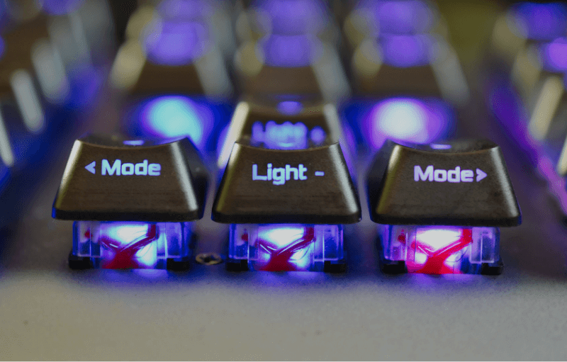

The ROG RX optical mechanical switches feature a central LED, and each key stem diffuses light to create a stunning in-key lighting effect.

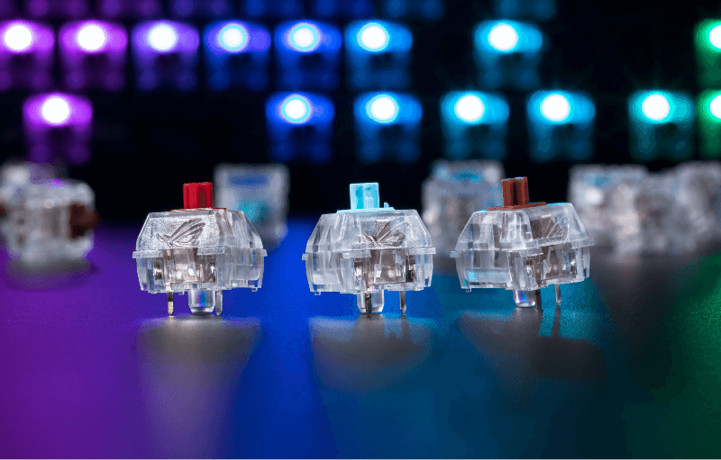

ROG NX Mechanical Switch

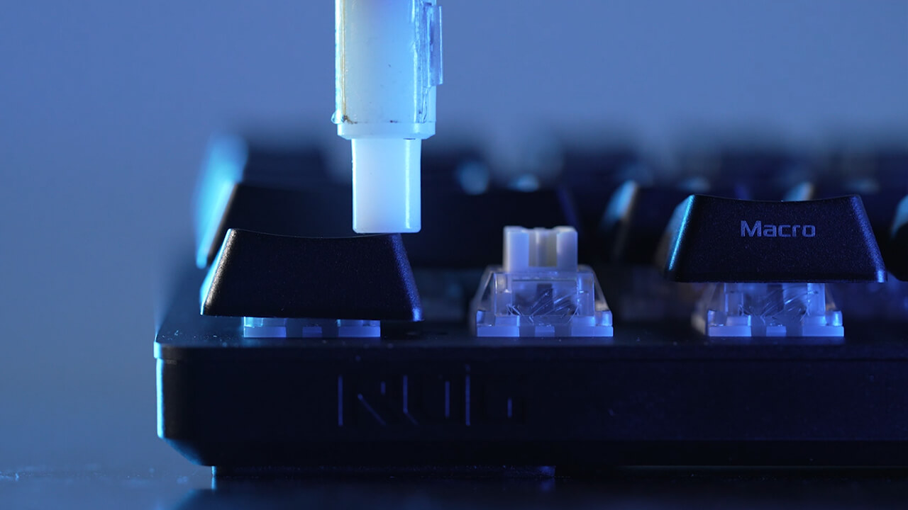

The switches have lubricated stems and base housings that offer a smoother click feel and eliminate spring bouncing noises respectively.

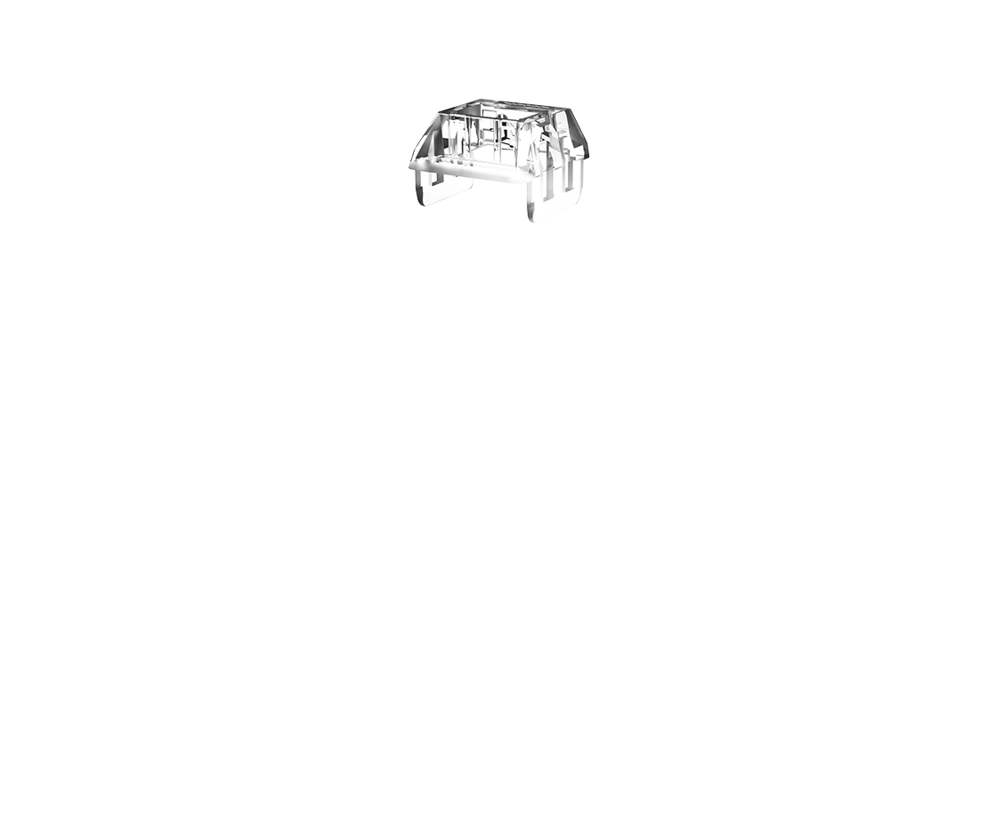

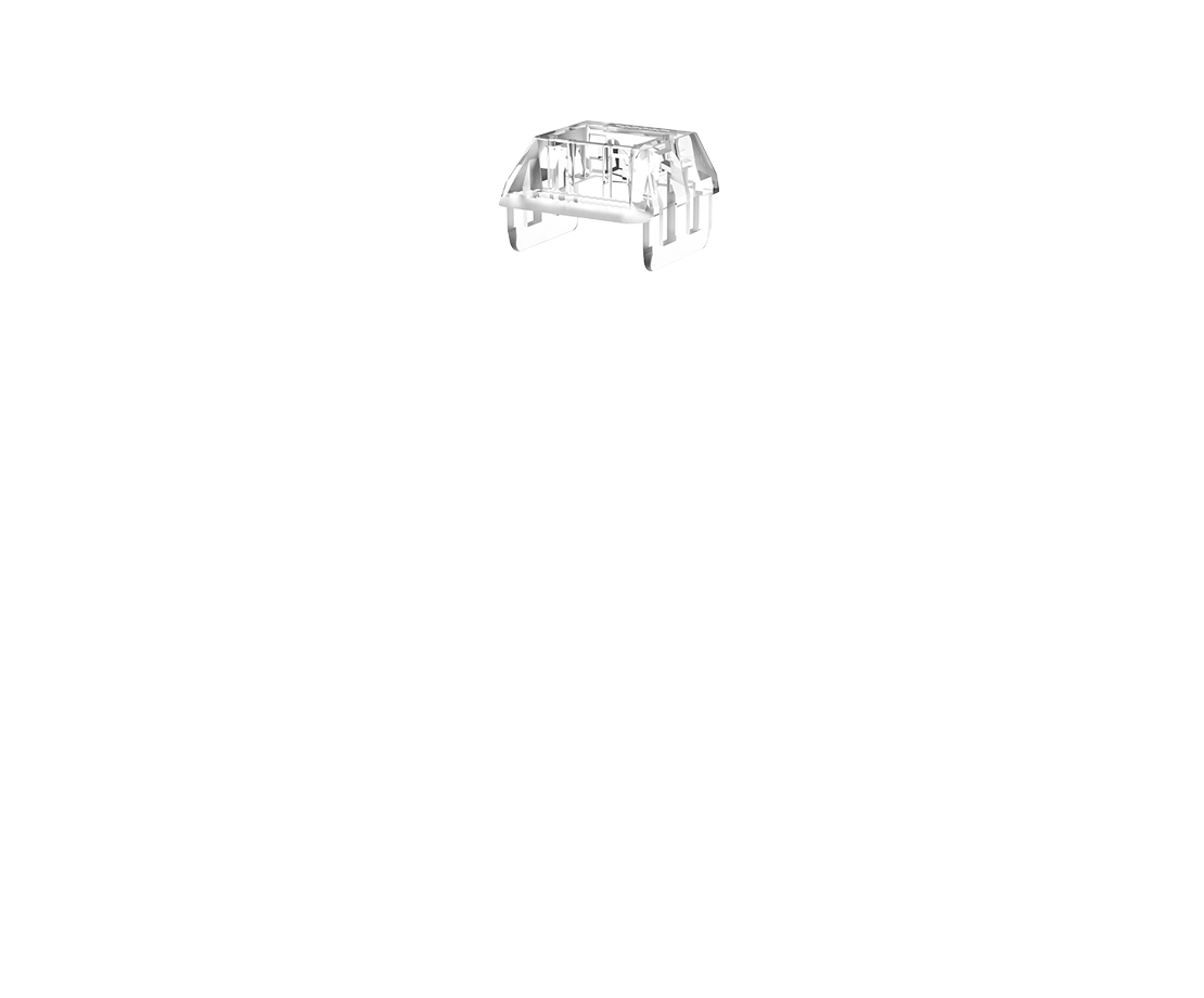

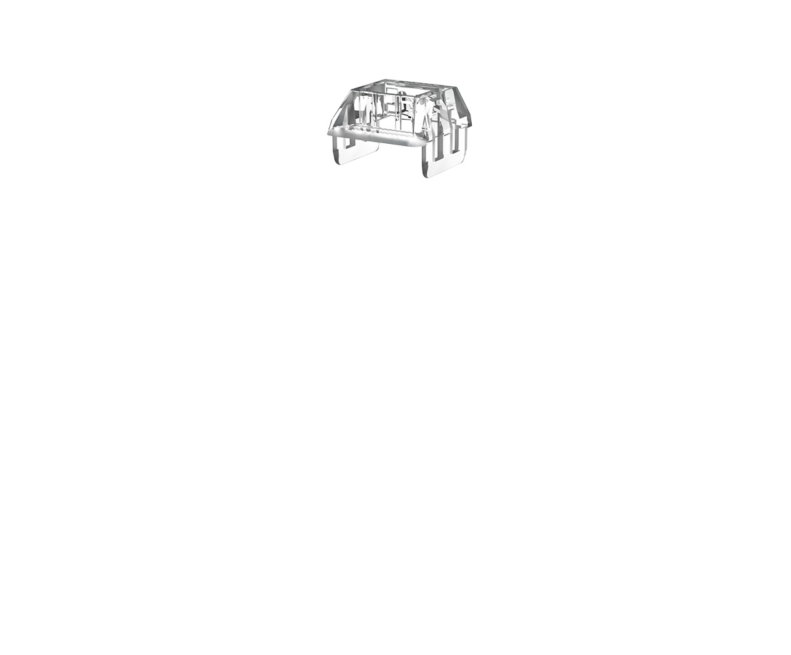

ROG NX Snow mechanical switches utilize composite POM material for the stem with PC top housing and POM bottom housing to provide ultra smooth keystrokes, and the walled stem design enhances stability and prevents dust intrusion. Special tuning is also done, coupled with factory pre-lubing, to give the ROG NX Snow keystroke a very solid and clean sound, with “thocky” acoustics.

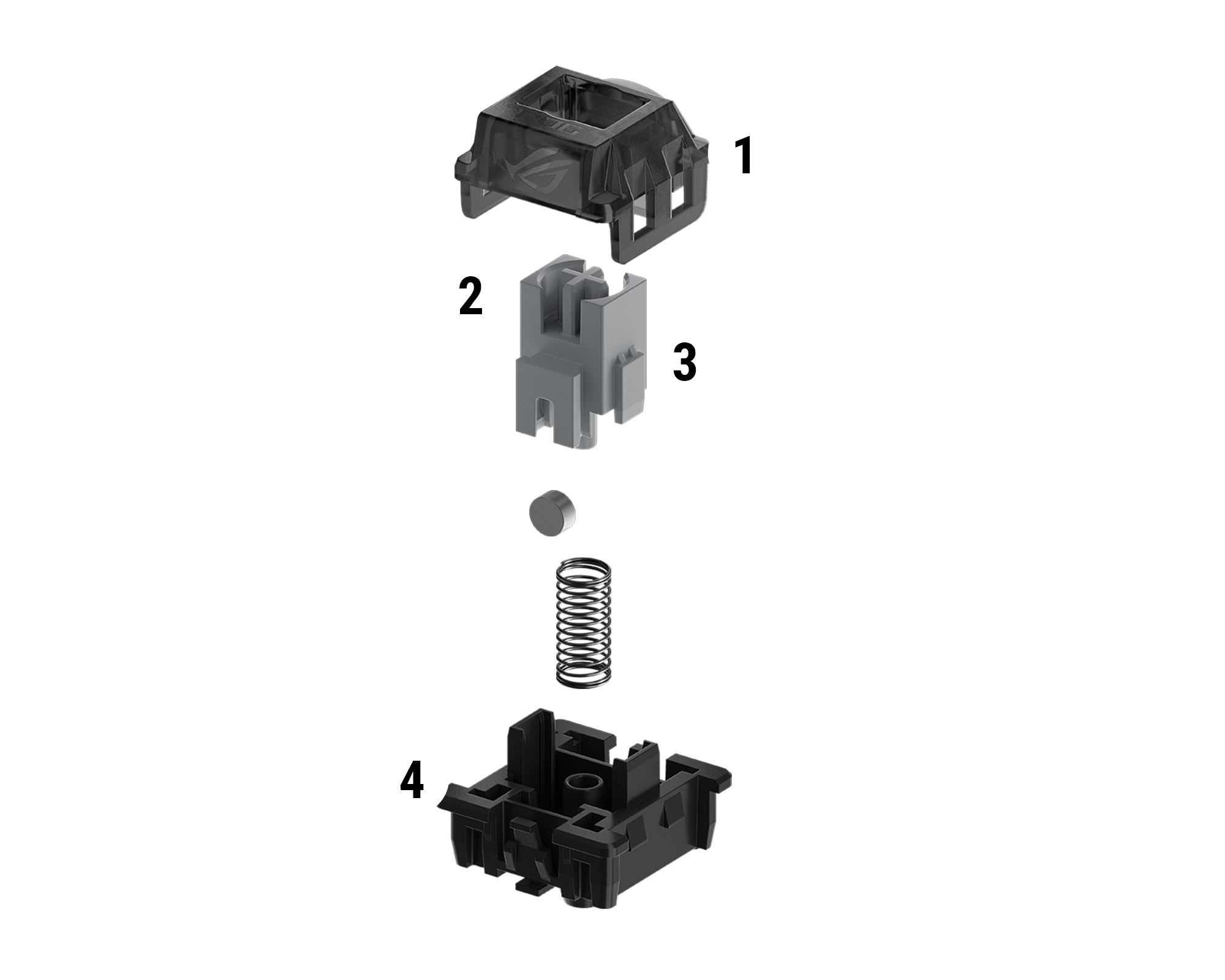

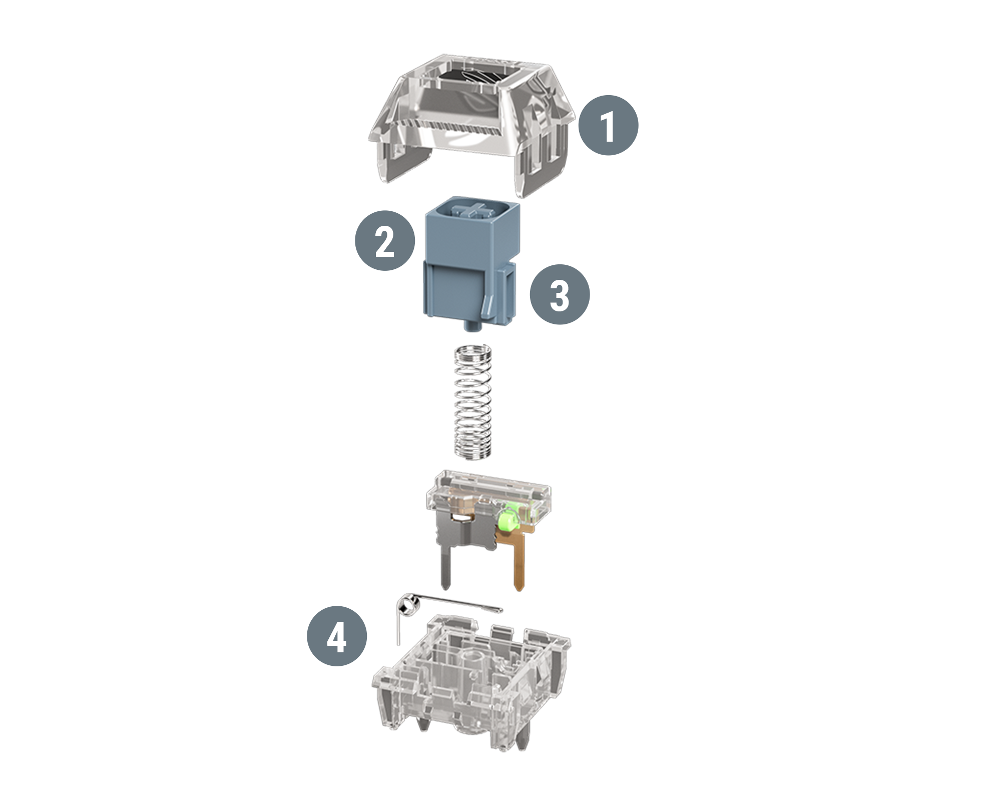

ROG NX Snow explosive view, showing all component parts -
Upper housing

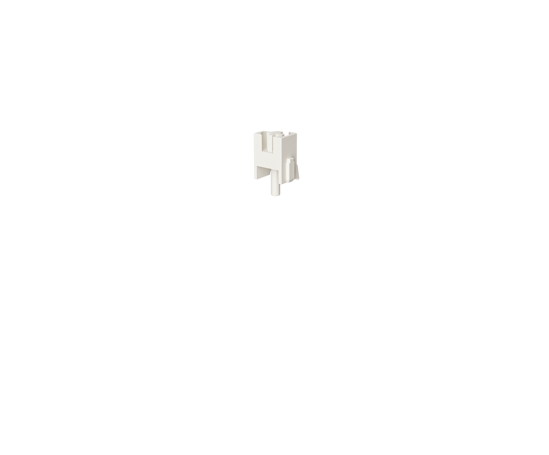

Walled stem
Walled stem design for keystroke stability
Stem material
Based housing

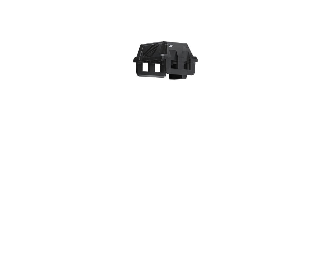

ROG NX Storm mechanical switches utilize composite POM material for the stem with PC housings to provide ultra-smooth and tactile keystrokes, and the walled stem design enhances stability and prevents dust intrusion. Special tuning is also done, coupled with factory pre-lubing, to give the ROG NX Storm keystroke a very crispy and clicky sound, with “clacky” acoustics.
ROG NX Storm explosive view, showing all component parts -
Upper housing
Walled stem
Stem material
Based housing
PC bottom housing for deeper keystroke sound.

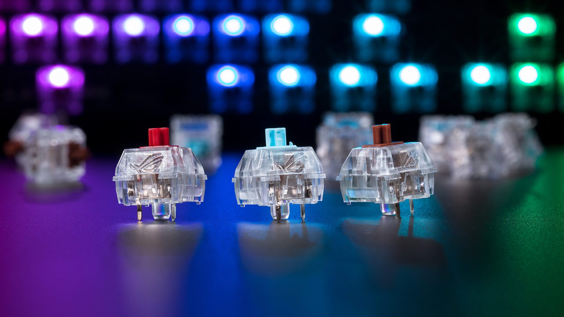

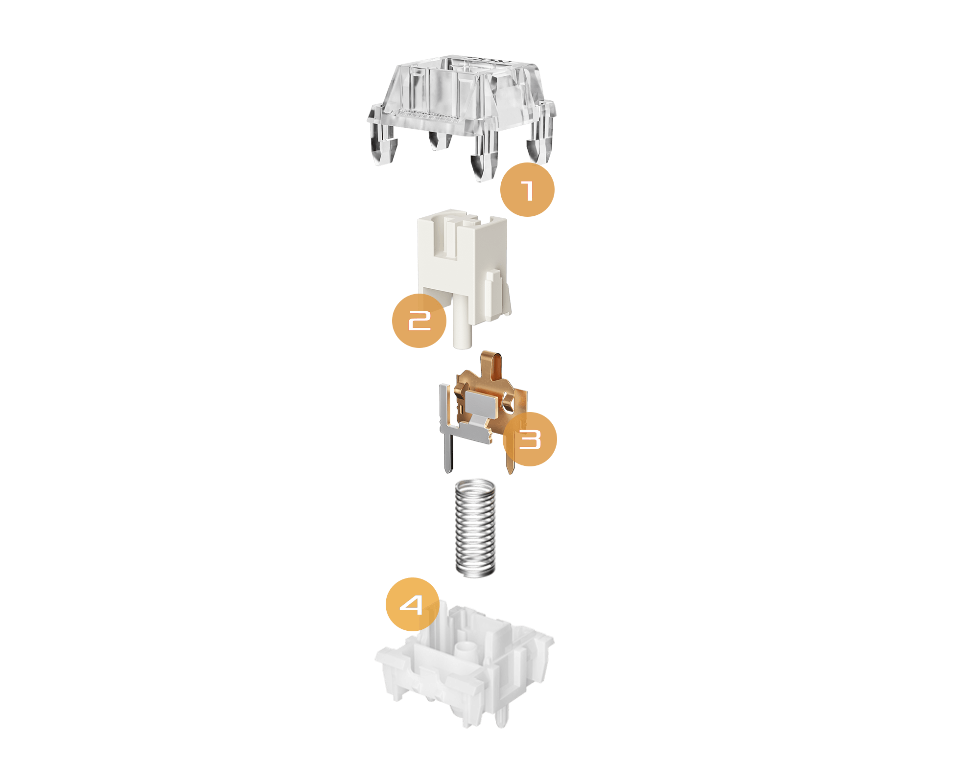

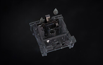

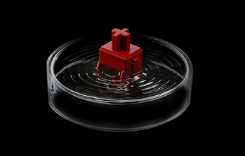

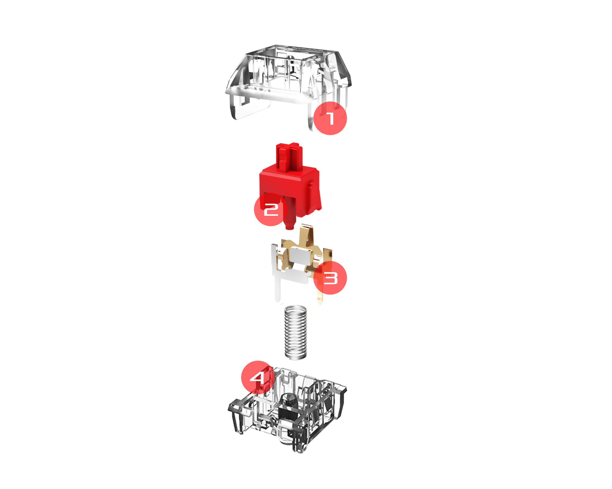

ROG NX Red mechanical switches provide a 1.8mm actuation point for fast input. Initial force of 40gf helps prevent accidental keystrokes, and it extends to 55gf for perfect rebound feedback. As a result, keystrokes are instantaneous and have a smooth and linear feel.
ROG NX Red explosive view, showing all component parts -
Upper housing
The special-tuned polycarbonate upper housing provides extraordinary transparency, offering consistent and brighter RGB lighting
Stem with exclusive ROG-tuned red finish
Lubricated stem provides a smooth click feel

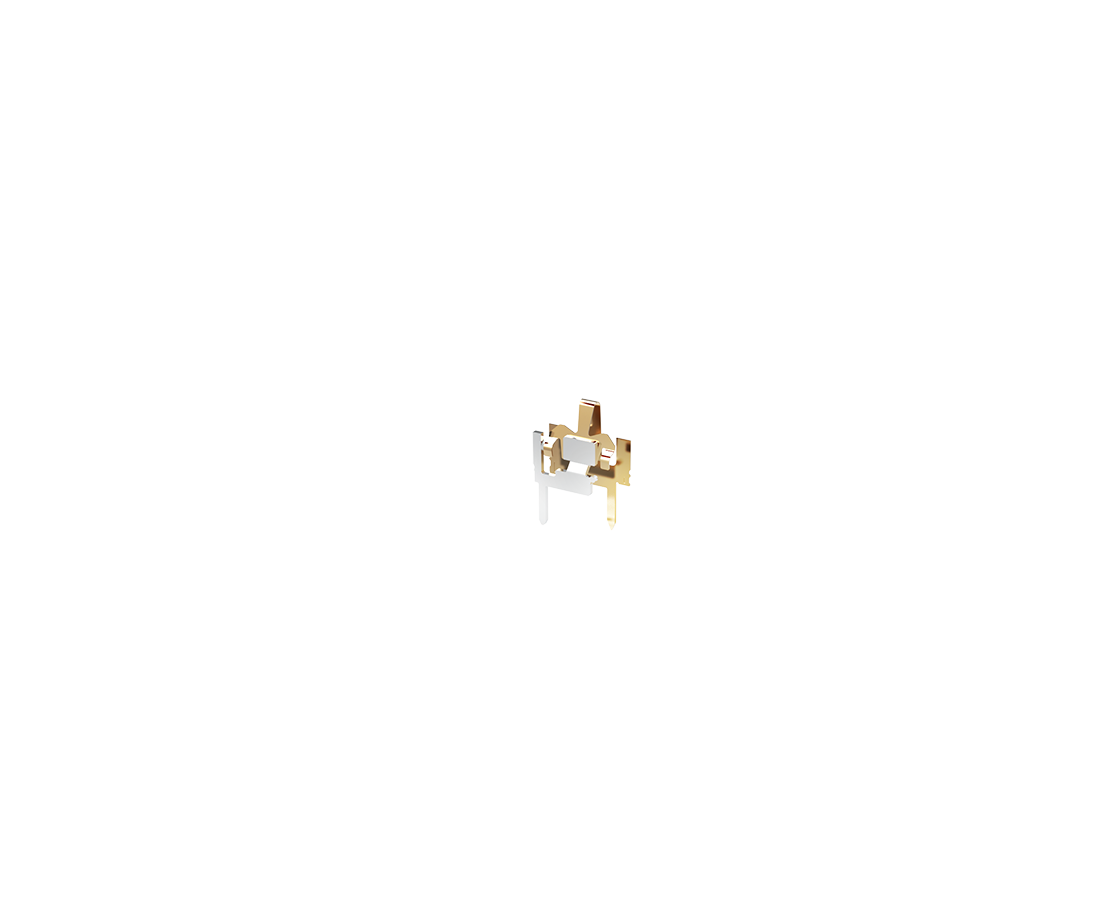

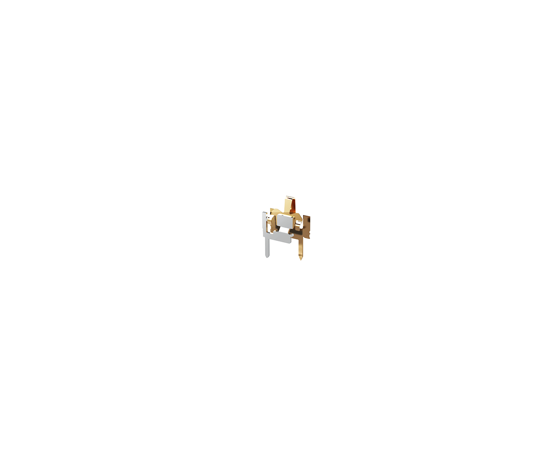

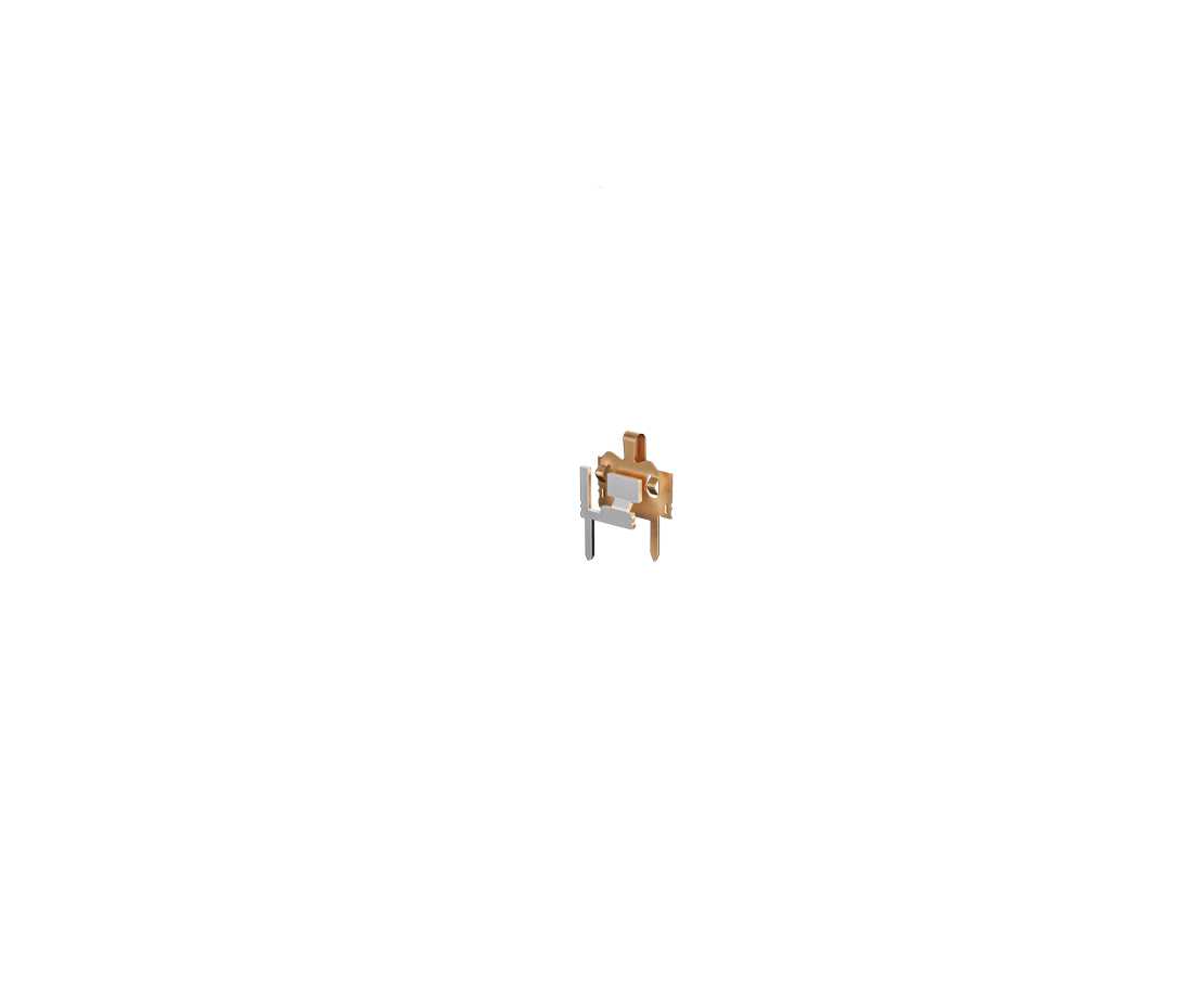

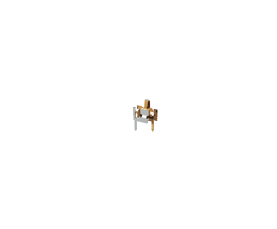

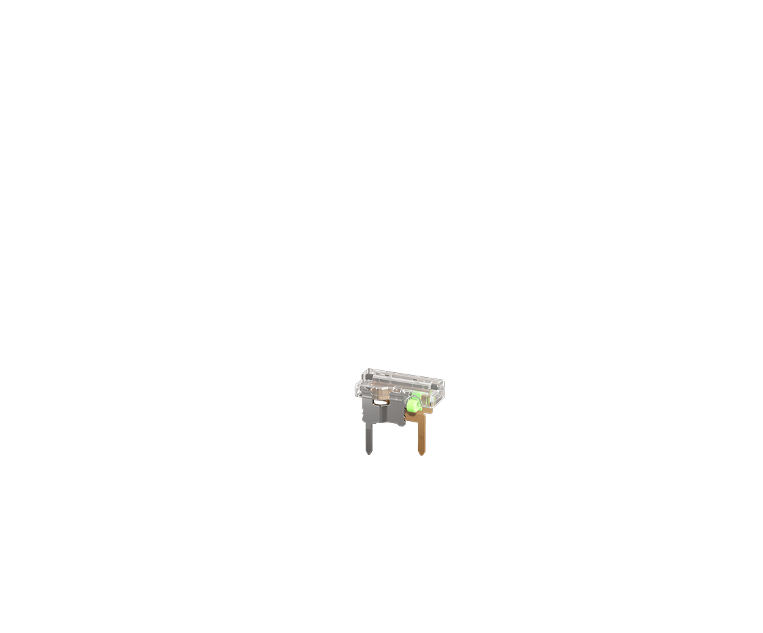

Metal crosspoint contact
Gold-plated contact delivers outstanding durability and a 70-million-keypress lifespan

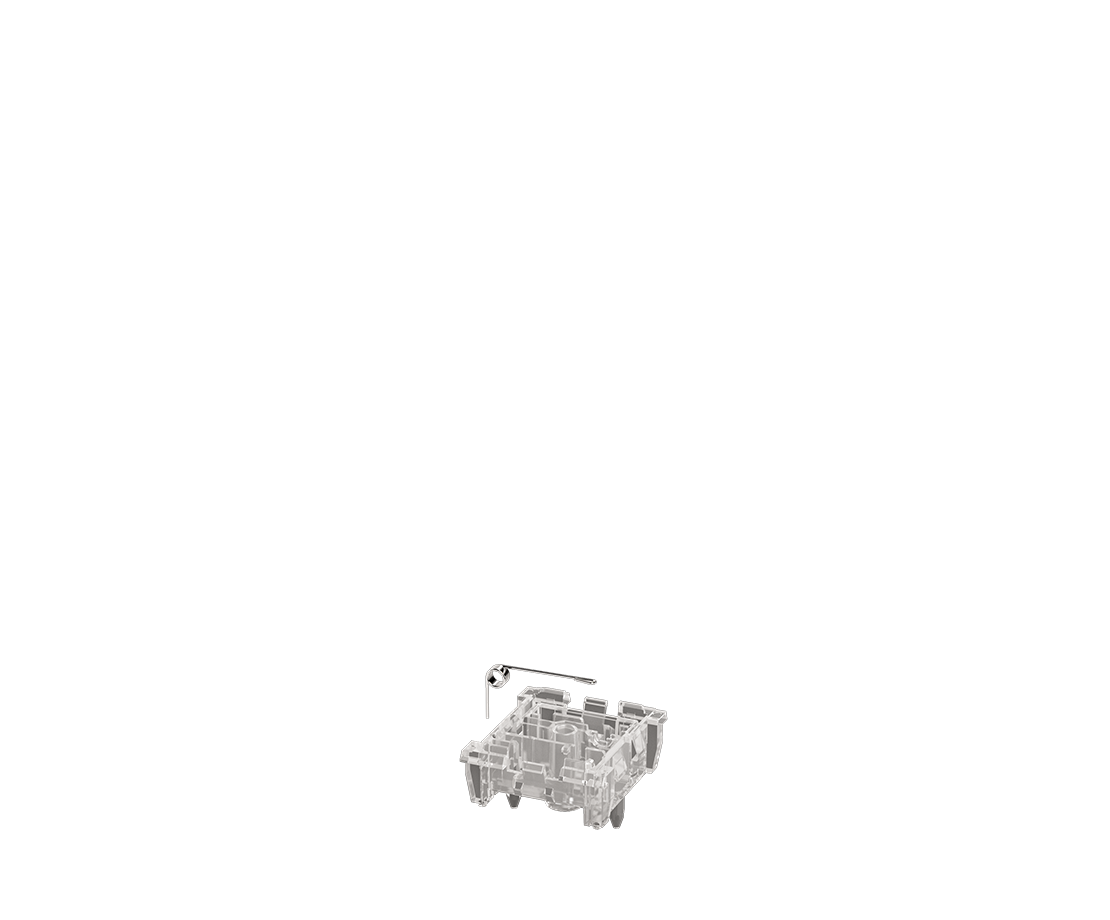

Based housing
Lubricated transparent polycarbonate housing eliminates bouncing noise caused by springs
1.8mm
2.0mm
Actuation Point
58gf
Tactile Force
33%
Click Ratio
Ultra Tactile

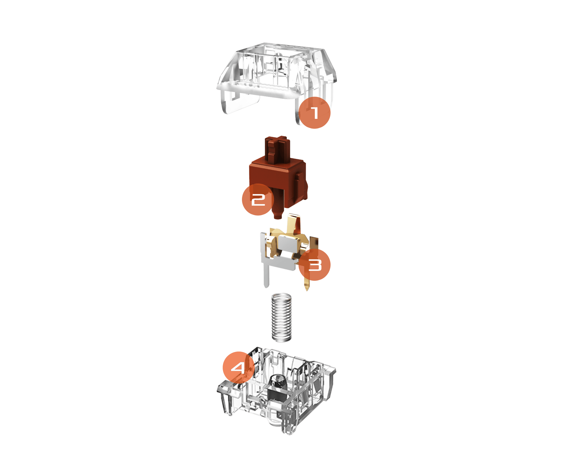

ROG NX Brown mechanical switches have a 2mm actuation point, as preferred by traditional brown switch users. The tactile force of 58gf combined with a click ratio of 33% gives every keystroke an obvious, more pronounced tactile response.
ROG NX Brown explosive view, showing all component parts -
Upper housing
Stem with exclusive ROG-tuned brown finish
Lubricated stem with high click ratio creates a resounding click sound and provides pronounced tactile response
Based housing
2.0mm
2.3mm
Actuation Point
65gf
Tactile Force
16%
Click Ratio
Clicky and Tactile

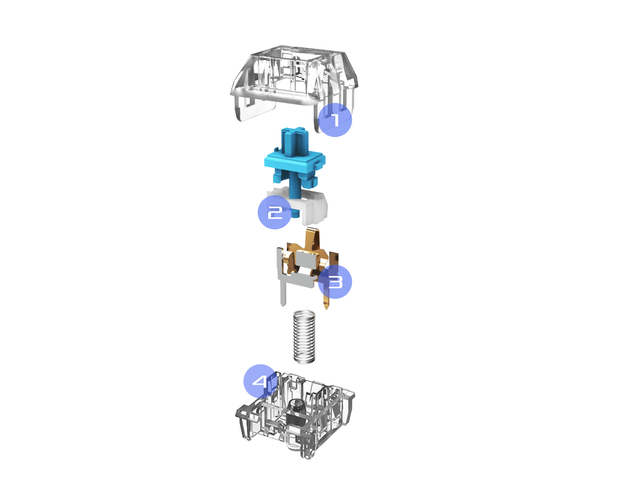

ROG NX Blue mechanical switches feature a 2.3mm actuation point, standard 16% click ratio, and an enthusiast-preferred 65gf tactile force – all to provide firm and superb feedback with each keystroke.
ROG NX Blue explosive view, showing all component parts -
Upper housing
Stem with exclusive ROG-tuned blue finish
Lubricated stem provides smoother and snappier click feel than traditional blue switches
Based housing

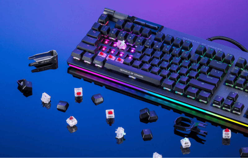

NX Switch Available Models

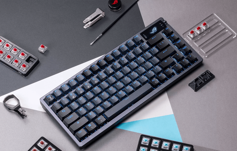

ROG Azoth Extreme
75% premium custom gaming keyboard with full aluminum-alloy chassis and hot-swappable ROG NX mechanical switches
ROG Azoth
75% wireless custom gaming keyboard with hot-swappable ROG NX mechanical switches
ROG Strix Scope II 96 Wireless
96% wireless gaming keyboard with hot-swapable ROG NX mechanical switches
ROG Strix Scope II
100% gaming keyboard with ROG NX mechanical switches
ROG Falchion Ace
65% esports gaming keyboard with ROG NX mechanical switches
ROG Strix Flare II Animate
100% gaming keyboard with swappable ROG NX/Cherry mechanical switches
ROG Strix Flare II
ROG Strix Scope NX Wireless Deluxe
100% wireless gaming keyboard with ROG NX mechanical switches
ROG Falchion NX
65% wireless gaming keyboard with ROG NX mechanical switches
ROG Strix Scope NX Deluxe
ROG Strix Scope NX
ROG Strix Scope NX TKL Deluxe
80% gaming keyboard with ROG NX mechanical switches

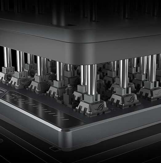

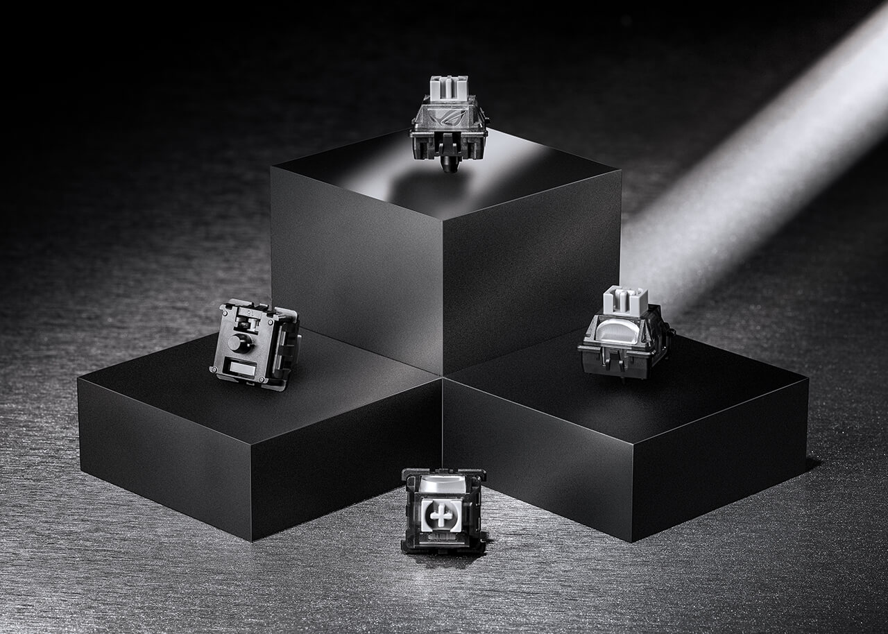

Consistency Breeds Muscle Memory
Gaming control comes from muscle memory, and your equipment plays a big part in that. The ROG NX Red and NX Brown mechanical switches are tuned to actuate and reset at the same point, while the ROG NX Blue mechanical switches are tuned to a near zero 0.1 mm actuation versus reset point. All ROG switches give you superb trigger and reset consistency, resulting in better gameplay experiences.
Ensuring Consistent Keystrokes
ROG NX mechanical switches exceed industry standards, offering a 5 gf force tolerance and +/ 0.4 mm total travel distance to provide consistent keystrokes for unparalleled gaming experiences.
